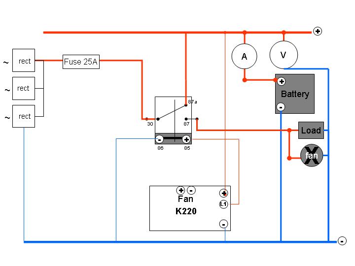

Re: ***SPAM*** Cheap shunt regulator kit (3.00 / 0) (#16)
by Hanski on Wed May 18, 2005 at 06:24:15 AM MST
Trivo,
How is your project with Oately K220 shuntregulator?
I ordered the same regulator and put it inside a PC power along with bridge rectifier and amp- & voltmeters.
Thank´s to your post I also used a relay to switch the power from battery to resistor.
However when I teststed it with motorcycle lead acid battery it seemed to switch rapidly (about half a second) to the resistor every 5 seconds when the voltage reached 13,7V?
I know that the battery is not in it´s best condition and the chager is for small batteries putting out only 0,5A. Maybe it's the old battery?
On some regulators I have seen "lo" and "hi" voltage potentiometers. Or maybe there should be some kind of delay?
//Hanski
Re: ***SPAM*** Cheap shunt regulator kit (3.00 / 0) (#17)
by Trivo on Wed May 18, 2005 at 03:58:39 PM MST
Hanski
I am a bit confused so if i go off track please excuse me.
First the theory as I understand it.
Your battery is connected to the shunt and also to the charging supply be it wind solar or battery charger. When the charge reaches your preset voltage you set with the pot, in your case 13.7v the relay should switch and the load which you put on it will take the voltage down and the battery will stop charging.
Points to consider
1. the load must be more than the supply from the charging supply.
if it is to low the voltage to the battery will keep going up
2. if it is to high the supply will short out. if it is a wind the mill might stop or battery charger blow fuses but not solar they don't care.
The battery wont lose charge until it is drained by an appliance attached to it and when it reaches 11V? the dump will switch off and the battery will charge to 13.7v again and the process continues.
Now to your problem
1. connect the relay to your battery directly and make sure it switches correctly
if not the relay is wrong
if ok then connect the positive lead of the relay to the circuit board and the negative directly to your battery negitive but don't put any load on the relay output. Charge the battery and see if it switches ok. use a multimeter directly to the battery to check the voltage as this is what powers the relay, if ok then attach the dump you have to the relay. The dump must NOT be connected to the battery in any way.
Try this and let me know how you go
Trivo
Re: ***SPAM*** Cheap shunt regulator kit (3.00 / 0) (#18)
by Hanski on Fri May 20, 2005 at 04:21:47 AM MST
Thanks Trivo for your reply,
I rechecked the wires and found that relay negative (86) went to positive. That must be the reason why the relay started flipping between battery (87a) and load (87).
I'll try it again tomorrow an let's see what happens. I hope not to see any smoke.
brgds Hanski
Re: ***SPAM*** Cheap shunt regulator kit (3.00 / 0) (#19)
by Trivo on Sat May 21, 2005 at 03:08:05 AM MST
Hanski
I think it is not quite right
The power coming from the 25A fuse should go directly to the main +
and 87a should not have anything connected to it and a diode should be connected so the battery power cant leak back
It may work the way you have it but the relay contacts will probably burn out quickly switching full loads
least that is the way I understand it
Trivo
Re: ***SPAM*** Cheap shunt regulator kit (3.00 / 0) (#20)
by Hanski on Mon May 23, 2005 at 02:01:54 AM MST
Thanks a'lot again Trivo,
You're right about the relay. It's 30A relay and estimated current will be 10A but anyway. And contacts don't like high frequency current! I'll do as you described.
I still have the original problem where the regulator switches between battery and load. There should be 1V margin (hysteresis?). So if the voltage is set to 13,5V and regulator switches to load, it should switch back to battery when the voltage is 12,5? It doesn't. It just flips between load and battery every 2sec.
Anyway as I'm not a genius with electronics I'll re check the K220 if all the components are in right place and right way inserted.
As I'm not native english speaking I didn't understand if I should short the "serial", "dump" on neither in the circuit board. Now the serial is shorted.
brgds
Hanski

Re: ***SPAM*** Cheap shunt regulator kit (3.00 / 0) (#22)
by Trivo on Thu May 26, 2005 at 12:13:18 AM MST
Check the relay is wired up as drawing above + in and out to K220 board as when the board switches it goes to - (ground)
Re: ***SPAM*** Cheap shunt regulator kit (3.00 / 0) (#23)
by Hanski on Thu May 26, 2005 at 08:58:42 AM MST
Yes I forgot that K220 connects ground to load. It's now done the right way. I also have second K220 board wich I haven't put togeter yet. I'll do it and try if it behaves differently. The one I have connected still switches back an forth between load and battery without that 1 volt hysteresis as described in manual.
//Hanski
PS. I'm from Helsinki, Finland
Re: ***SPAM*** Cheap shunt regulator kit (3.00 / 0) (#24)
by Trivo on Fri May 27, 2005 at 07:57:39 PM MST
Hi Hanski
I have contacted Branko at Oatley and he said to turn the Q3 and Q4 around  so the flat is down and i did this and it works perfictly
Hope this helps
Trivo
