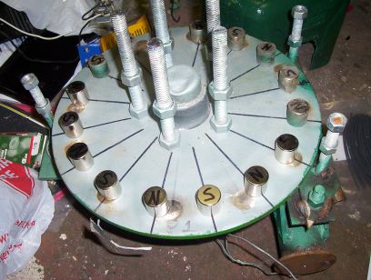

-magnets- 1"x1" diameter neos, 16 per plate 32 total

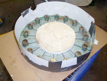

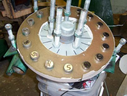

I then put the magnets on one plate, making sure to alter north south, north south...make sure you mark both plates while the holes are alignedso the magnets will be in the right position in reference to one another
I then made a makeshift mold around the plate for puring fiberglass..this is just a precautionary measure so the centfifgul force wont throw the magnets off the plate while spinning...some just use durabond 2ooo or some other kind of adhesive, and i am sure it will work well also..you also see the stator mold being in the cool down stage
<BR<p> below is what the plate with the magnets looks like after the resin has dried..you will use about 1 quart...i have found it is cheaper to buy 4 quarts of resin, than it is to buy a gallon can, and it is easier to use a quart at a time too

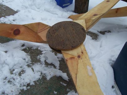

here is a picture of hughs blade root for those who havent seen it

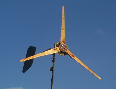

the last 2 pictures of the mill flying...very satisfying seeing the end result...there wasnt much wind today, and it was in spurts but i seen at least 120 watts, i suspect it will make at leat 3 timesthat for sure with a decent wind
