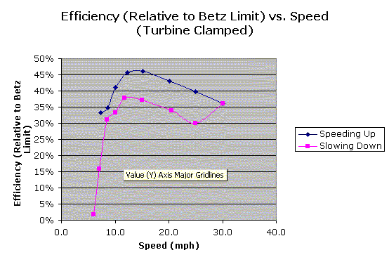

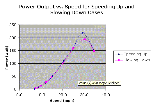

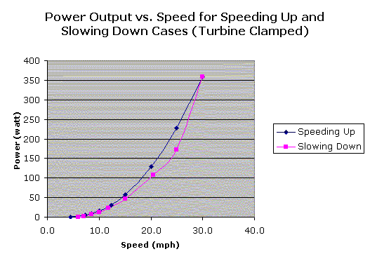

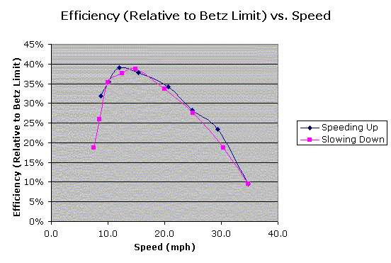

The tunnel work was quit fun and the results are summarized in the "MIT_windTunnel_4ft.xls" file.  This gist of it is that we produced power curves under two scenarios: one with the tail clamped to prevent furling, and one with the tail free to pivot.  In both cases we took measurements as the turbine was speeding up and as it was slowing down because of the differing behaviors in these two approaches.
Several people have questioned the scientific merit of the measurements given the size of the turbine relative to the tunnel and given that wind tunnels don't accurately reflect real-world conditions.  Of course both of these criticisms are valid and we advise all to take the results with a large grain of salt.  We did these tests largely to take advantage of the unique opportunity to use the MIT wind tunnel and to gain some practice making power curves.
You can see the results in the spreadsheet file that I've posted to my webspace, "MIT_windTunnel_4ft.xls".  Just some excerpts from it:
In the third image, you can clearly see where the turbine started to furl.

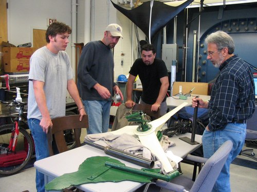

The guys and tunnel operator Dick Perdichizzi check out the turbine.

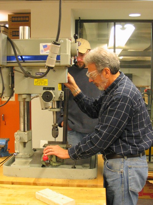

Drilling a hole for mounting the turbine in the tunnel floor (see a short video clip here [AVI, 1.8 meg])

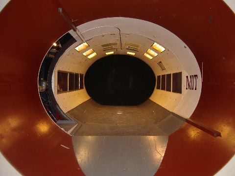

The tunnel mouth.

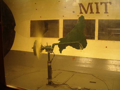

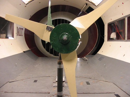

The turbine mounted in the tunnel.

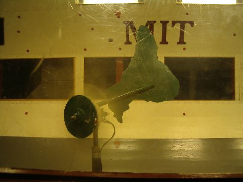

The turbine furled.

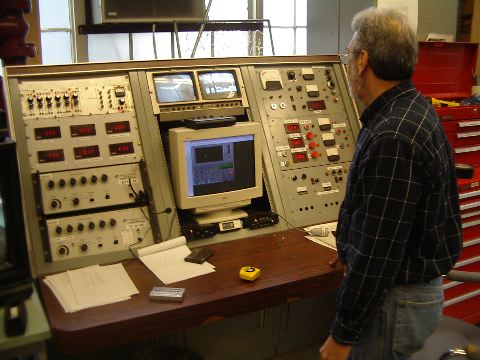

The WBWT control panel.  See a clip of tunnel operations here (AVI, 3.9 meg)
