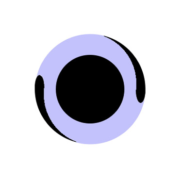

I recently decided to drop the single blade for a while because I wanted to build a working unit and the single needs too much work yet. So I come to the conclusion I can't go very big due to my location and have since determined the output of a 30" machine is uninspiring. I got to thinking about VAWT's because they seem more compact. I started working on the theory and different designs and it dawned on me the brilliance of the lenz turbine because of it's ability to prodice power on the upwind and downwind sides so I drew a two blade version to see if I'm understanding the theory correctly.
Ed, can you see a problem with this?
I dropped one blade and introduced a circular center as I'm not sure I understand the need for a delta center unless it is itself producing lift and I've missed it. The circular center as you can see still provides for the venturi effect and my only concern is that i've misunderstood what's going on and have reversed the venturi.
As I uderstand it in the above diagram the unit should rotate in a clockwise direction.
Is this correct or have I overlooked something or made a critical error?

     Some of the problems I was trying to overcome with the Lenz turbine was the pulse or lag between power points.  This is the only problem I see with the 2 blade design.  As the blades pass the center of the direct wind the blade in the rear gets blanked the front blade stalls as it passes center.  With the 3 blades the power pulse is reduced because there is always one blade making power.  The two bladed units seem to have 2 40 degree lags where the 3 blade has 3 10 degree lags.  The biggest portion of drag is on the front wing passing center.  Also the two blade units have 2 positions where they don't want to start or catch the wind to begin rotation.  You can offset the startup by making the center a bit smaller than the wing chord, this will allow the air to flow over the core and catch a wing, but you'll end up loosing some of the venturi effect.  The venturi actually creates a low pressure zone behind the turbine and the air flowing around the unit tries to fill the void, in doing so it changes the direction of the air flow enough to start creating lift before the blade actually sees the direct wind.

Thanks for the commentary Ed. I realize the pulse effect is more significant with a two blade design I just considered it this way for simplicity and I was also wondering what kind of effect "solidity" as a factor of circumfrence may have. I do think the Coanda effect may significantly reduce the pulsing effect and the wide cord has the effect of put wing in the wind almost all the time. I was wondering also if you can see a problem with the round center as apposed to the delta center thats tailored to the three blade design. I considered an oval in the center to match the two blades but couldn't see an advantage. I'd love to play with this some as I can now see the beauty in it's design. Maybe a dimpled surface on the center would help the Coanda effect by delaying separation such as with a golf ball.

I should say that the coanda effect is the reason I wanted to adopt a round center.

  Actually the "dimples" might help.  As long as you can keep the air flowing over the surface your fine, but you will be breaking the air from the drum each time the wing passes.  This creates turbulance and will break the coanda effect.  If its running fairly fast it won't have time to reorganize effectivly.

Hey Mike I like the design but I have a Q for you and Ed about the coanda effect
I don't know much about the effect except what I read years ago when Hughes was testing the notar.  From what I know about it... won't the lift that it creates just want to pull your center column to the outside?  I can see how it would create a low pressure and I assume that low would be reacting 90° to the wind direction?  If I have that correct, how does this impart a rotative force?  Or is the low used to "pull" air between the airfoil and column?  Thanks,

I'm thinking/hoping it will pull air between the airfoil and the column effectively increasing how many degrees of rotation the unit will produce power and reducing drag and downwind turbulence but as Ed has pointed out It's questionable how much benefit it may have as the wind shadow from the upwind blade occurs at almost the same time as you want the effect. I'm building a model right now so I can get a better visualization.
http://www.absoluteastronomy.com/encyclopedia/C/Co/Coanda_effect.htm
I'm thinking keeping the two blade confiquration but reducing the cord width in proportion to the center.
