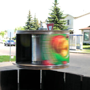

Well the lenz turbine variation model is up and running in a very turbulent wind location and I'm happy about it. It's a crude model made from cardboard and cereal box wing skins with skate rolls as bearings so don't critique the asthetics.
here it is doing about 180-200 rpm in an unknown wind that is very turbulent
Here it is standing still.
It stalls in the shadow position where the upwind blade is shadowing the downwind blade so it won't self start. If you give it a spin it takes off and spins nicely.
Like I said before I think if I reduced the cord width in relation to the center it would run better and self start.

Could you put something along the lines of the "windcatcher" from an anemometer to get it started?

Hi rotornuts,
Just before the maple blade stuff I started investigating the Lenz/Darrius type mill like an Ropatec rotor.
Originally the idea to make a Lenz turbine came from windstuffnow, but after some paper models a ended up with a more Darrius looking thing, later I found out I was making an Ropatec rotor.
This is my current design, made out of PS foam
It is self starting!! I also added an small alternator under it.
This was my original design
Its in Dutch. The first picture is also used for my current design. Only deferens is the adjustable  angle of  attack. Current angle of attack is 0.
I think my design is self starting because the angle of attack is 0 maybe <0.

  Pretty slick there Mike!  Fun machines.  Thats what happened with the "coffee can" it wouldn't start but would go like crazy once given a push.  The third blade cures alot of problems, as well it creates a couple.  I was more satisfied with the 3 wing units than any of the 2 wingers.

I think the starting problem is important to address especially in a high cog alternator. It takes more then just to get it going.

Would it not be good to just stack two of the turbines 90 degrees off so they start easier?
Re: Lenz turbine variation pics (3.00 / 0) (#6)
by Matrix1000 on Sat May 21, 2005 at 10:42:50 PM MST
Thats what I was thinking, perhaps 2/3 stacked on top of each other staggered 1/2 / 1/3 of a turn. Then it might self start yet still retain the same efficiency.

I'm totally mew to the vawt club so I'm still learning and I've learned a few thing here. I think three is probably going to prove better than two. This thing only has a TSR of about .7 so it needs a total redesign. I think the blades are too big and the venturi is in the wrong spot on the upwind side. I think I need to keep the air flow to the outside of the rotor on the upwind side till it comes past 90 degrees or it creates too much drag and the negative pressure behind the unit is wreaking havoc in the two blade design. The ropatec handles things a bit differently but I think some of the same problems may exist there too although I'm starting to see the merit in the delta and the football for the three and two blade designs.
