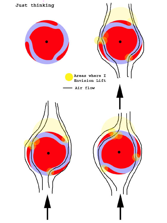

New drawings of the next learning experience
Well the first worked.
http://www.fieldlines.com/story/2005/5/21/204220/623
http://www.fieldlines.com/story/2005/5/20/204046/109
But not very well. Wouldn't self start and it ran at a TSR of about .7
It wanted to go but there was to much drag and negative pressure behind the unit I think.
Anyhow I think I'm going to try and change the shape of the venturi so the lowest pressure occurs hopefully along the leading edge of the blade instead of at the apex. I'd also like to see if I can keep the aiflow to the outside of the rotor on the down wind and the first 90 degrees if the upwind side using the center.
Here's a drawing with some speculation on airflow and lift areas. It's a three blade design. I've changed the inside shape considerably and It's starting to look more like that delta shape I couldn't see the purpose for. Hmmm...
All opinions welcome as long as you realize I don't care to build a proven design. Oh and it's late and I'm going bugeye from drawing that image.

But while I am here, what you have forgotten on your diagram is the rotation.  Once the  surface speed of the rotor achieves the speed of the wind, it, to use an old sailing term, 'starts making its' own wind'.
Lots of things going one here - might even get a ltiile of the Magnus effect.

Your right, Diary format would work better. I have to confess the dynamics of a vawt, espessially one where your attempting to manipulate the airflow, can be a bit hard to follow. I doubt I fully understand what's going on during all portions of a rotation.
The rotation of the above is clockwise.
Thanks for putting a name to distortion of the global airflow around a rotating cylinder, I didn't know it was the magnus effect but I realized something must be happening I just didn't realize it was as profound as the magnus effect describes.

You know, I was fooling arund with my model today and I think all this time I've been visualizing the action in the venturi backwards not realizing most of the power is being produced on the downwind side. The shape of the venturi I've drawn would likely deminish the pressure differential on the downwind side stealing away power!

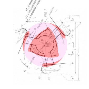

I just overlayed the origional patent, Ed's unit and what I came up with after playing with my original and here's what it looks like.
Both Ed's and mine are different than the origional patent but I've come to the same place as Ed did a long time ago.

Below tsr 1 there should be little air flow through the venturi so that the space in the venturi is at a higher pressure than the space downwind from the wing so, if most of the air is divered around the venturi we would get a low pressure area at the outside of the wing area and downwind producing good starting torque. The area in blue is around where I see the low pressure area.
Above tsr 1 I think we want the air flow to shift into the venturi to increase airspeed in the venturi area to make it the low pressure area. Now we are producing lift on the inside of the wing rather than the outside and the swail or "dent" serves to seperate air flow on the center and create drag rather than lift. The area in blue on the second diagram is a drag area which I think is better than it being a lift area. If there was no swail and the center had a simple delta shape then I think the area in blue would be producing lift which would counter rotation more than drag. Unfortunately I can't see a better way to treat this area so I've settled for drag.
I could easily be mistaken on this but at this time this is my best understanding of what's happening.
