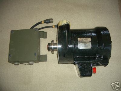

Bought a genny head
By BeenzMeenzWind, Section Mechanical
Posted on Mon May 23, 2005 at 08:32:00 AM MST
Suggestions as to best use for it welcome.

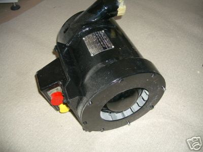

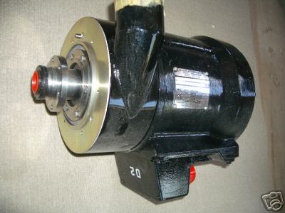

Hi, I was talking about 3 stage brushless alternators a few weeks back. Just bought one!
'New unused Lucas Aerospace fan cooled 3 phase AC generator, 12 KVA, 200V, 400 Hz, Max 8000 rpm. Very high quality MOD spec. Includes controller Manufactured to work in adverse environments. Ideal for home power supply system charging battery banks etc from a wind or water turbine energy source.'
£75 from Ebay.
I'm going to mate it to a 1.9 litre Peugeot non-turbo diesel, I think. They're cheap and easy to get from the breakers. Plus I've had a couple of vehicles with 'em in so I know to fix them / rebuild them.
As you can see, the output is a little wierd (by homepower standards) as it's an aircraft alternator. You can fiddle with the output voltage a little, though, by messing about with the controller.
Any ideas for the best way to use it would be appreciated.
