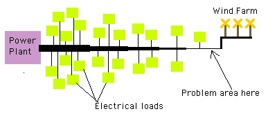

Re: When Germanys wind power peaks Dutch power gri (3.00 / 0) (#10)
by RP on Sat May 28, 2005 at 09:21:50 PM MST
I think it might be kind of like this:
If the wind farms are near the "thin" end of the grid, then a lot of power could get rammed into a fairly weak link in the network.
