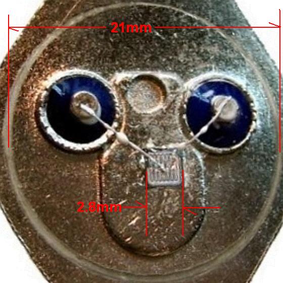

Here is a 2N3055 without it's top. Note the die size is very small, about 7.8mm^2.
Even with concentration I'm amazed it can produce 1.5 to 2 watts as there does not seem to be a lot of bare silicon. Most of the surface seems to be covered with conductive fingers.

I wonder if you wouldn't get more output if you shorted the Collector & Emitter, so you used BOTH P-N junctions in parallel.
And for a higher energy density, use TO-92 transistors (though cooling might be more difficult) and short focal length lenses.

What's a TO-3 can?
