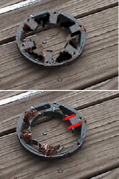

Hi all,
Working on a couple box fan type motor conversions.
Have gotten myself confused. Again.
The coils are wound on laminations, like a post with the top facing the magnets.
More like wrapped on a post, than inside a slot.
If the post or laminations and hole in the coil are 1 X 1",
How big should the magnets be?
Somehow 1 X 1" seems correct to me.
Same as the hole in the coils.
A friend had some good arguements at the time for the bigger the better, to totally saturate the lams.
Kind of seems it would have major cancellation.
These look something like an ECM (link), but with only 6 coils far from each other.
http://www.fieldlines.com/story/2005/3/28/44634/0927
I am not sure how the flux is acting on the coils in this situation.
Thanks,

Re: Lam wound coils and mag size (3.00 / 0) (#7)
by ghurd on Wed May 4th, 2005 at 02:34:08 PM MST
Its 4 mags 3 phases.
Space for the mags, available space, and the shape of the top of the lam 'post'.
It's top is a "T" .
They all look about like this... (thanks Norm!)
http://www.otherpower.com/images/scimages/22/Laminate.gif
The 2nd one.
See how I am confused about how the flux gets to
 or through the coils?
The "T" looks like it may short the flux without cutting the coils.  Jumping, bending, shorting, whatever it could be called.
Or the "T" looks like it will short the flux without cutting the coils unless there is a magnet over 2 adjoining lam posts.
I would just try it.
But I will not know what is wrong if I don't get how the thing is supposed to function.
(Like the guys who put all the magnets in same pole up!)
Something is always wrong, but I know before it is done what and how it is wrong!
Re: Lam wound coils and mag size (3.00 / 0) (#8)
by kitno455 on Wed May 4th, 2005 at 02:52:03 PM MST
wow, ok, yes you are right. if you have a N and a S under one tooth at the same time, i would think that nearly none of the flux will go thru the coil.
cut the sides off of the T somewhat.
any chance you could get two of these with the same stator lams and alternate them into a 12 pole setup? that little less iron would reduce cogging some, and give you a higher effective speed and longer coil legs.
allan
Re: Lam wound coils and mag size (3.00 / 0) (#11)
by ghurd on Wed May 4th, 2005 at 03:38:43 PM MST
With the N under (over?) one lam, the next mag will be exactally half way between the 2nd and 3rd lam.  Hence reduced cogging.
But only one tooth would be under one mag at any time. The teeth are 150% seperate from the mags.
But 6 coils and 12 poles?  Wouldn't the mags short between the top of the "T" to the other side of the top of the same "T"?
Re: Lam wound coils and mag size (3.00 / 0) (#12)
by kitno455 on Wed May 4th, 2005 at 04:07:00 PM MST
ok, if you never have a N and a S under the same stator tooth at the same time, then the flux pretty much has to go up and link with the coil and come back down the next tooth.
my idea about the 12 pole involves cutting the T's to be more like I's (shorter cross-bar).
than you could get more mags, and still keep it three phase.
you got the mags yet?
how big is the head on the T, 1x1?
allan
Re: Lam wound coils and mag size (3.00 / 0) (#16)
by ghurd on Thu May 5th, 2005 at 08:14:43 AM MST
The one I'm starting with has 3 parallel wires about mid 20's gauge.
Thats hevy enough for this. And if it only makes 9v, I can series 2 coils from the same 'T', or if it only makes 5v, I can series all 3.
If it makes 12v I can parallel all 3.
The top of the 'T's are 1.5" wide, 0.5" thick.
The steel in the armature is 0.5" thick.
The ID of the 'T's is just under 3", armature too.
Gap between the 'T's is just under 1/8".
The shaft of the 'T' is 1/2" thick, 5/8" wide (best guess).
The magnets I am willing to try in this are 1x1x5/16", 3/4x3/4x5/16", 1x1/2x1/8", or 1x1 cylinders (don't think the cylinders will fit very easy because of 3 big holes in the armature). All neos.
Probably will go with the 3/4 square x 5/16".
Unless there is a reason to go with another.
I hate hacksaws.

Re: Lam wound coils and mag size (3.00 / 0) (#10)
by Flux on Wed May 4th, 2005 at 03:14:45 PM MST
I have just looked at the pictures of the core, I assumed they were like the first one. If like the second one it will only work properly with 6 magnets single phase.
With 4 magnets you will have most of the flux shunted across the pole tips.
If desperate you could cut back the tips to less than the width of the magnet but to be quite honest I would not bother with that type of core, I think it will be a cogging machine and not much else.
If you can find a decent core with the normal slots it will be much better.
Re: Lam wound coils and mag size (3.00 / 0) (#13)
by ghurd on Wed May 4th, 2005 at 05:23:04 PM MST
Hey Flux!
Really glad you came by!
This is totally different approach.  I think.
This is 3 totally seperate phases.
Therefore 2 of 4 magnets are totally irrelevant at any given time.  Other than reducing cogging and completing the flux paths by what I have extrapolated by my readings here.
And 4 of 6 coils are totally irrelevent at any time.
So 2 of the 4 magnets are not expected to be producing.
And 4 of the 6 coils are dead.
Opposite coils are connected for charging voltage.
The "T" tips are 150% seperate from the active magnets.
No magnetic shorting between the same tip should occur.
Cogging should be reduced to the least for the situation.
At least I think...
My question could be explained better if the magnet and tip count was only 2.
With some extra iron to reduce cogging?
What really happens, flux speaking, in the otherpower link above.
I spent about 2 hours saying this, hit the wrong button, and it is all gone!
The first time was much better.
Re: Lam wound coils and mag size (3.00 / 0) (#14)
by Flux on Thu May 5th, 2005 at 01:10:19 AM MST
Having done a quick sketch, you can forget my second post, the flux shorting I was worried about occurs on the inactive poles anyway, you are right that the active pole arc is not across more than 1 magnet.
If you can solve the cogging it should work. It is similar to a high tension magneto circuit and with them the better they cog the better they work. Interesting idea though.

Almost NO Cogging! (3.00 / 0) (#27)
by ghurd on Fri May 6th, 2005 at 09:37:37 AM MST
Have the 4 magnets stuck to the armature under their own power.
Not perfectly set, but quite close.
The air gap is closer than I expected, with a hacksaw and file.
Gave it a spin!
Almost NO Cogging!
What cogging there is seems weak and long.
Not like bang, bang, bang. More like whoosh, whoosh, whoosh.
Sorry if I get too technical.  ;)
It will not free wheel along, partly because I do not want to turn it that fast without glue, and partly because I got the armature / rotor in upside down and the bushings are on shaft surface rust.
With the factory wiring configuration... Out of curiosity, put a meter on the high ohm (32) windings. Got about .7VAC at maybe 100 RPM.  That much seems strange to me as all the coils should be canceling each other. The low ohm (16) windings do not register any voltage.
Next is seperating and reconfiguring the coils.
Should be easy enough. Just time consuming. Not today.
Re: Almost NO Cogging! (3.00 / 0) (#28)
by kitno455 on Fri May 6th, 2005 at 09:53:48 AM MST
the no cogging makes sense, i mean, you never had a point where all 4 mags are against the side of a stator tooth at the same time, and the stator teeth are much wider than the mags.
allan
Re: Almost NO Cogging! (3.00 / 0) (#29)
by ghurd on Fri May 6th, 2005 at 10:13:33 AM MST
That is why I wanted to try 4 mags on 6 teeth.
The fans are everywhere, but no one has really had very good luck with them, often due to cogging.
With no cogging and good magnets, I still think these things have potential, with the factory coil ends reassigned.  Like Johnlm said in the 'box fan...' thread, there are a lot of ways to re connect what is already there.
Also wanted to avoid cutting the 'T's to 'I's. I believe the lams get shorted.
And cogging gets worse.
There is that thing with the bushings instead of bearings.
I'll burn that bridge when I get to it!
Re: Lam wound coils and mag size (3.00 / 0) (#30)
by ghurd on Sat May 7th, 2005 at 10:55:52 PM MST
Hey! It works!
It got a little longer than I expected.  A few interesting things at the end too.
Turns out there are 4 wires.
Cut one tooth's coils seperate from the other teeth, and extended all 8 ends.
One wire seemed a little smaller than the others, but did not measure it.
With 2 coils at 2 ohms and 2 at 3 ohms, I expected the 3 ohm coils to make more volts, because they look to be wrapped with all the same number of turns.
Each coil made 2.00 volts AC open.
The 3 ohm coils made 0.650 amps AC shorted.
The 2 ohm coils made 1.05 amps AC shorted.
Here is where things go bad, in a funny way.
It was looking promising. So I connected all 4 coils on that tooth in series.
Guess what. 2 volts AC. Short circuit AC amps, 0.120A.
Added a bridge and very small cap, thinking the Hz had the meter confused.  The volts were about right, at around 2 (even with the bridge), and the amps were still about 0.12.
Started at the beginning with the bridge and cap, one coil at a time.  Turns out he tinned the stripped wires he added and the flux residue was causing trouble with the ohm meter not getting any reading. That took a while to figure out! Re stripped the 8 wires.
Reconnected them in series and checked the VAC. The same. 2+2+2+2=8 when I was in school. Still only had 2VAC. (Scratch head like Oliver Hardy.)
Running out of time.
Then, I remembered placing the magnet rotor. 16 wires out the vent holes, 8 on the coils of one tooth we were testing, 8 where those formerly connected. A mess, but got it so 4 wires came out of 4 holes.
Spun the rotor. OK for half a tun, then maybe a magnet is rubbing?  No. 4 wires slipped out between the teeth and tangled with the magnets. They should be OK.
But they must have shorted during testing.
Or chucking the drill on and off so many times caused the wires to stip insulation and short on the sheet metal motor housing.
Too late to keep going. Had to stop. Shorts and flux insulating make bummers.
But I am quite sure it is shorted near the extra wires for testing.
I think it should be 11.3VDC open with all 4 coils per leg in series, seriesed with the mating coil 180' accross is 22.6VDC open, minus 1.0 for a good bridge, and that is 21.6VDC.
For the amps, I guess it will be about 0.8 short, too tired now to get a calculator.
Don't know if I know how to figure it with much accuracy anyway.
One VERY good thing. This is all form 1 coil array, figuring some for when it is connected with its mate in phase 180' accross from it.
But there are 6 coil arrays, or 3 pairs of mating coil arrays, so that should be about 2.4 amps shorted. (?)
The cogging, even when shorted, was very light. Shorting the outputs had NO noticable effect on how hard it turned. No skewing or offset for the magnets.
The rotor, I believe, does not have enough iron to be perfect. I will add fender washers to the top and bottom to help the flux path. The magnets are N45 and 3/4" square 5/16" thick, but the laminations in the rotor and stator, are only 1/2" thick. The rotor including the aluminium is 3/4", so it glued together nice.
The stator laminations are fine. There is 'virtually' no flux leakage to the outside of the motor. Tested with a 18" hanging test clip and could not be sure it was attracted.
I think the 20" fan blade that came with the motor will turn it in a light wind. That was not expected.
Next will be to get the opposite pairs all connected together in series, rectified, then parelleled and see how it goes.
I don't recall the drill and generator RPMs. Probably about 450. Guessing.
Should get it wired middle of next week.
I'll post it here.
