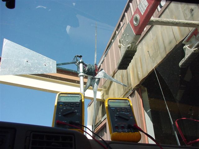

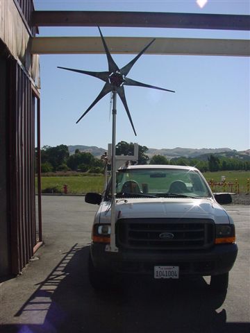

Mallard / Hornet - Pictures (3.00 / 0) (#19)
by aogden on Sat Jun 11, 2005 at 01:51:23 AM MST
Okay here are those pictures I promised, hopefully this works! Adrian
