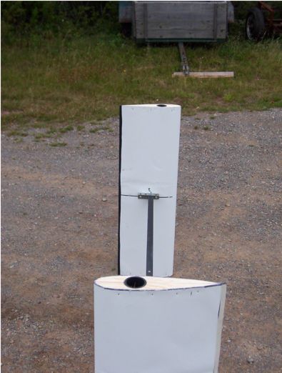

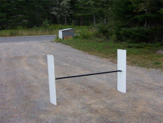

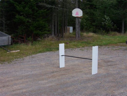

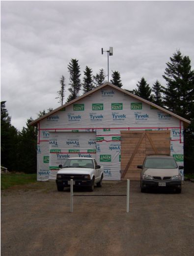

Re: New Darrieus Turbine (3.00 / 0) (#22)
by wind4Reg on Wed Sep 14, 2005 at 12:43:51 PM MST
Here are some pics of my VAWT test model. It is working so good that I am going to have to build a big one.
Here it is on the ground, you can see my drag style one on the roof of the garage in the background.
Here is a closer shot of it:
Another angle:
Side view:
Flying on the roof:
It is hard to appreciate how fast this thing is turning from the picture since my camera is highspeed and it looks like it is stopped, but it is really moving fast. I took a video of it and might upload that if I can reduce the size enough, on dialup here :(
This is a blast though. By the way it only took about 8 hours to build this so I encourage everyone to build a model of the design that interests you.
Reg.
Re: New Darrieus Turbine (3.00 / 0) (#23)
by IntegEner on Thu Sep 15, 2005 at 05:20:05 PM MST
Reg - Nice work. It looks like some sort of cotton fabric or maybe vinyl sheet glued or nailed down. Some detailed information on something similar can be found at www.integener.com.
Here is my take on it. The wind seems to be coming from behind the garage and the blades are being somewhat "pitched" by it, as though they are free to do so. One is pitched inwards a bit and the other outwards and this reverses as they go around. Is this right? This is certainly allowable and helps make it start up and run well.
My own experience is that otherwise with fixed blades something like this, begging to differ, would not start up or only do so slowly. What was done to make it better was to add a second blade about four inches or so behind each of the blades shown, i.e. it would have four blades instead of two on the two rotor arms. This then started up much easier and in the lightest of winds. However, it didn't run very fast even in strong winds. So the next thing was to make the four blades thinner, as thin as they could be made, still with the 0018 profile. They started up well and ran much faster but still didn't accelerate beyond a certain speed in gusts. Then the gap between the doubled blades was narrowed to only one and a half inches. Somewhere along the line an offset was made on the leading edges and some positive pitch was added to the trailing edges. As a result of all these mods, it now starts up and runs exceedingly well and I, like you, was thrilled by it and loved to watch it turn. It could be seen from about a half of a mile away and created much attention for itself.
When you go to make the larger unit you mentioned you wanted to make, pay attention to the blade thicknesses. The faster tangential velocities of the greater rotor diameter will create much more parasitic drag going upwind, out of all proportion, and it will not respond overall to the larger dimensions. So the blades must be much thinner, not thicker, and it will pay to consider the doubled blade idea as well. The Solwind people have been informed of this and it seems to me that they would also stand to profit from it with their large diameter rotors.
Like the Prairie Home Companion radio show host, Garrison Keillor, used to say, "Keep your feet on the ground, your hopes up high, pray for rain, and keep your vertical axis wind turbine blades thin". Did I get that right?
You may communicate privately and some pieces or assemblies here may very well be found to be useful.
Anthony Chessick
IntegEner-W, Tehachapi
www.integener.com
Re: New Darrieus Turbine (3.00 / 0) (#24)
by wind4Reg on Fri Sep 16, 2005 at 09:11:35 AM MST
Hi Anthony, thanks for the reply. The wind has been blowing from several different directions, face on and from either side over the past couple of days and I go up on the roof and stop the rotor and then wait to see if it will self start. It hasn't been blowing from the back side of the garage yet though. Usually it goes backward about a half a turn and then forward about half a turn, then backward again about a quarter turn and then it goes forward and starts up and were off. I have tried this several time even in conditions where I could barely feel the wind and it always starts. We had heavy rain with very little wind yesterday calm to 11 km/h and it kept right spinning in the rain and low wind conditions. I don't have any test equipment yet to measure windspeed so I wrote a program that grabs the data everyday from the local weather website from the airport weather station that is about 15 minutes from my house so that should be reasonably close for now. I'll have to see what I can come up with for a cheap rpm device to see how fast it is turning at various windspeeds.
The blades are made from using 1 1/2" ABS plastic pipe and there are 3 ribs in each blade. The ribs are solid 1 1/4" spruce wood airfoil shaped. I drilled holes in them and slid the pipe through them and fixed them with small finishing nails. The blades are covered with white aluminum flashing and the trailing edges are secured shut with hockey tape, black on one and white on the other I ran out of black ;-) . You can tell I am a Canadian, hockey tape "A". I really have no budget for building these things so I just used materials I had lying around my garage.
I will keep testing this one, we'll see how long the bearing at the top of my test pole stands up, it seems to be getting kinda sloppy, and then if everything looks good I am going to build one in the 10kw - 20kw range. Why not, should be fun. I figured I'd copy SolWinds blade cord of 480mm with the NACA0018 airfoil for the big machine.
Has any SolWind owners ever visited these forums to give their testimonal, I'd sure like to hear what an owner has to say about their performance.
One thing I don't understand about all the problems with self starting is why people haven't build a unit that fixes the problem. If I build a large unit and it has problems self starting then I will add a directional drag mill to it for starting it and then it decouples so to speak, when the lift mill is started. It could work like the rear hub of a 10 speed bicycle, the drag machine like the power being supplied by the pedals, and then when the rear wheel (lift mill) exceeds the pedaling speed it freewheels in the same direction, why wouldn't this type of mechanism work for windmills?
Reg.
Re: New Darrieus Turbine (3.00 / 0) (#25)
by IntegEner on Fri Sep 16, 2005 at 04:58:42 PM MST
Thanks for the reply. What you say sounds very familiar. Two-armed verticals (I call them verticals) do start up reliably and it is because wind near ground level is full of turbulence with its momentary changes in direction, something I also discovered some time back. So sooner or later a little gust of just the right magnitude and direction hits the blades after they move to and fro a few times and they start up.
You will quickly become impatient with any hesitation at all and also with rotation rates that are less than near-blur speed. The wonder of just seeing it go is pleasant but before you scale up you should try to get it going to suit your requirements and needs. Larger turbines turn slower so speed is important.
To fasten the tail together you might try the pop rivet tool available in hardware stores. I just scrape by myself but they are inexpensive and I happen to have one from years back and it is perfect for aluminum sheet. It also pulls the surfaces together resulting in some concavity or tapering at the tail.
If you want to avoid some trial and error you might check out my website (www.integener.com) and see the blades described there. You can obtain some from me to your specifications if you feel confident enough in what I have to offer. I bend mine and they become strong and hold their curvature by themselves without internal reinforcement. I don't do this to make money but I have costs in doing this just like anyone else and you have the benefit of my knowing a bit about these verticals rotators.

Re: New Darrieus Turbine (3.00 / 0) (#27)

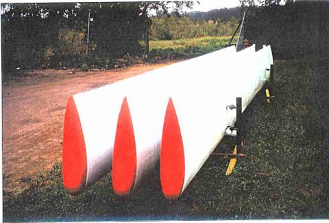

by wind4Reg on Tue Sep 20, 2005 at 12:25:29 PM MST
Hi Anthony, I checked out your website and found a couple of links to other VAWT manufacturers that I didn't know were out there, Neuhaeuser Windtec and Iug-Kontact. I did know about SolWind and their machines already. I find your comments on the NACA 0018 airfoils interesting. I realize that no airfoil is the magic bullet but it seems funny to me that everyone who is manufacturing the straight bladed H-Rotor style VAWT seems to be using the NACA 0018 symetrical design or one very close to it. For example:
Iug-Kontact has a 500kw unit with a NACA 0018 airfoil, and a 20kw unit with a NACA 0020 airfoil. SolWind doesn't give the information on their website for their airfoil, but from the pictures, it looks close to a NACA 0018 airfoil to me. Then Neuhaeuser Windtec also is using a fat foil, again they don't list the airfoil profile, at least not in english, but it is a fat symetrical one, see pic below:
So all this really makes me wonder why, if the thinner profiles are really better, then why are all the manufacturers, whom I'm willing to bet spent plenty in research on these machines, why is it that they all seem to be using the fat profiles NACA 0018+ ?
I think that there must be some overall performance benefits to using the fat profiles otherwise these manufacturers would be going with the thinner ones. They may not have the top speed of a thinner blade, but maybe they are more stable and produce more power over a broader windspeed range and start easier. In building my own VAWT I really don't have the budget or time to spend alot of analysis (although I'd like to) into profile selection. I have to believe that I can achieve reasonable good performance by following along with the existing manufacturers. I know that by doing this I am not going to come up with any new breakthru design, but I should have a good working windmill when all is said and done, which is my goal.
Fat is where it's at! {Millions cheer ;-) }
BTW, I'm not from Quebec, I'm from New Brunswick, the province directly above the state of Maine.
I think making the toy mills is a great idea.
Reg.
Re: New Darrieus Turbine (3.00 / 0) (#28)
by IntegEner on Wed Sep 21, 2005 at 08:05:59 AM MST
It is what I have learned from actually doing it. Give thin blades a try and see the difference yourself. You have hit upon one of the reasons why the machines of these manufacturers have found so little popularity - in so many words, they lack power. No need to purchase them. It can be seen from just the images of the blade profiles on the websites.
Since coming to this understanding myself, I have become less enthusiastic over these wind turbine designs. Much of my thinking earlier was based on a total disregard for parasitic drag as if it doesn't exist or can be readily ignored and I have found out otherwise.
Strict aerodynamic theory based on Newtonian principles says that the verticals should have comparable efficiency to the horizontals and the "mystery" of why they do not can now be laid to rest with this understanding. Parasitic drag.
It also seems to be why the Savonius rotors continue to have a place in much practice. Look at how thin the Savonius "blades" are, just thin sheets.
A lot of ink has been spilled and a lot of words have been written over such a simple matter but that seems to be the nature of wind energy. People have their "druthers" and have not seen the realities. Air being invisible doesn't help either.
Bending sheet metal to smaller radius curvatures can also be a factor since it is more difficult to get a consistent, perfect shape with such tighter bends without creases. If you can bend your aluminum to a half round diameter of one centimeter then I would be interested in sending you via this discussion list the template I use for the blades of the small toy rotators that work so well. I bend mine with clamps over a corner and use wood dowels behind the bend, first a larger diameter dowel and then smaller diameter dowels as the bend proceeds. It takes some patience and care and there might be better methods. As it stands now anyone who sends completed, bent blade pieces would be happily paid a fair price and I can use all I can receive, not to make any big deal out of it at the moment.
Thanks again for your interest.
