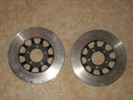

by 41south on Sat Jul 30, 2005 at 11:19:31 PM MST
For a small experimental VAWT I was going to use these steel rings.
They are disk brakes off a Honda motorcycle and are 24 cm,or about 10 inches in diameter.
Cheers - Colin

by Flux on Sun Jul 31, 2005 at 01:10:01 AM MST
41south   Those Honda discs look great, but check that they are not stainless, many motorcycle discs never rust and I suspect that they may be stainless.
If they are a magnetic grade of stainless they may still be ok.

by 41south on Sun Jul 31, 2005 at 02:30:35 PM MST
Thanks for the info Flux, I see some rust on these already, would this indicate that they are not stainless?

by stevesteve on Sun Jul 31, 2005 at 03:29:13 AM MST
I seem to remember seeing rust on motorbike disks when they have been left out for a while. They may just stay shiny as the brake pads polish them each time they are used.
I wondered about using them before, those disks look great as they are solid and not the perforated type(through the disk from face to face not just vented within the thickness), which I suspect would interfere with the flux path.
