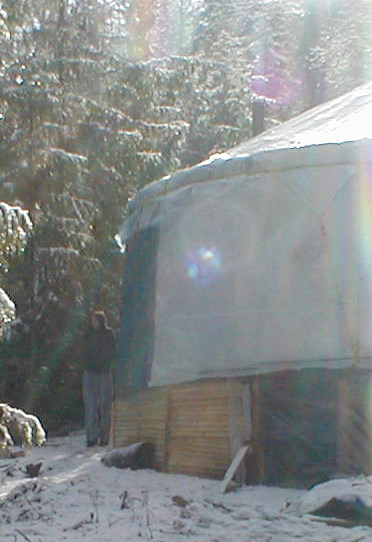

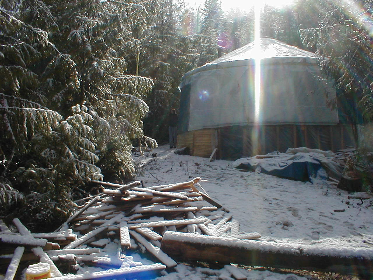

Hi folks!
I have just finished a 24' (diameter) Mongolian Yurt, constructed on a deck, built on an acreage in BC Canada. My friend, the landowner, also has one, and has been living in his dwelling for 4 yrs, and has seen winter temperatures down to -30c.
I am interested in discussing these structures with others. In our climate, shelters really need to withstand adverse weather conditions. 80+ mp/h winds and subzero temperatures are not uncommon here. Although many fantastic options are available, price is, and has been, a huge concern for us. I constructed my entire Yurt for less than $800 US.
Breakdown of my setup:
Khanas (wall latices) are comprised of 160 khana sticks, with 5 holes in each
Khanas are bolted together with 5/16 hardware
Rafters (24) are 2x4 construction, 11.6' ft. terminated at a 42" plywood hub, using Hurricane Truss clips, bent, and drilled. Rafter mounted with 1/4" hardware.

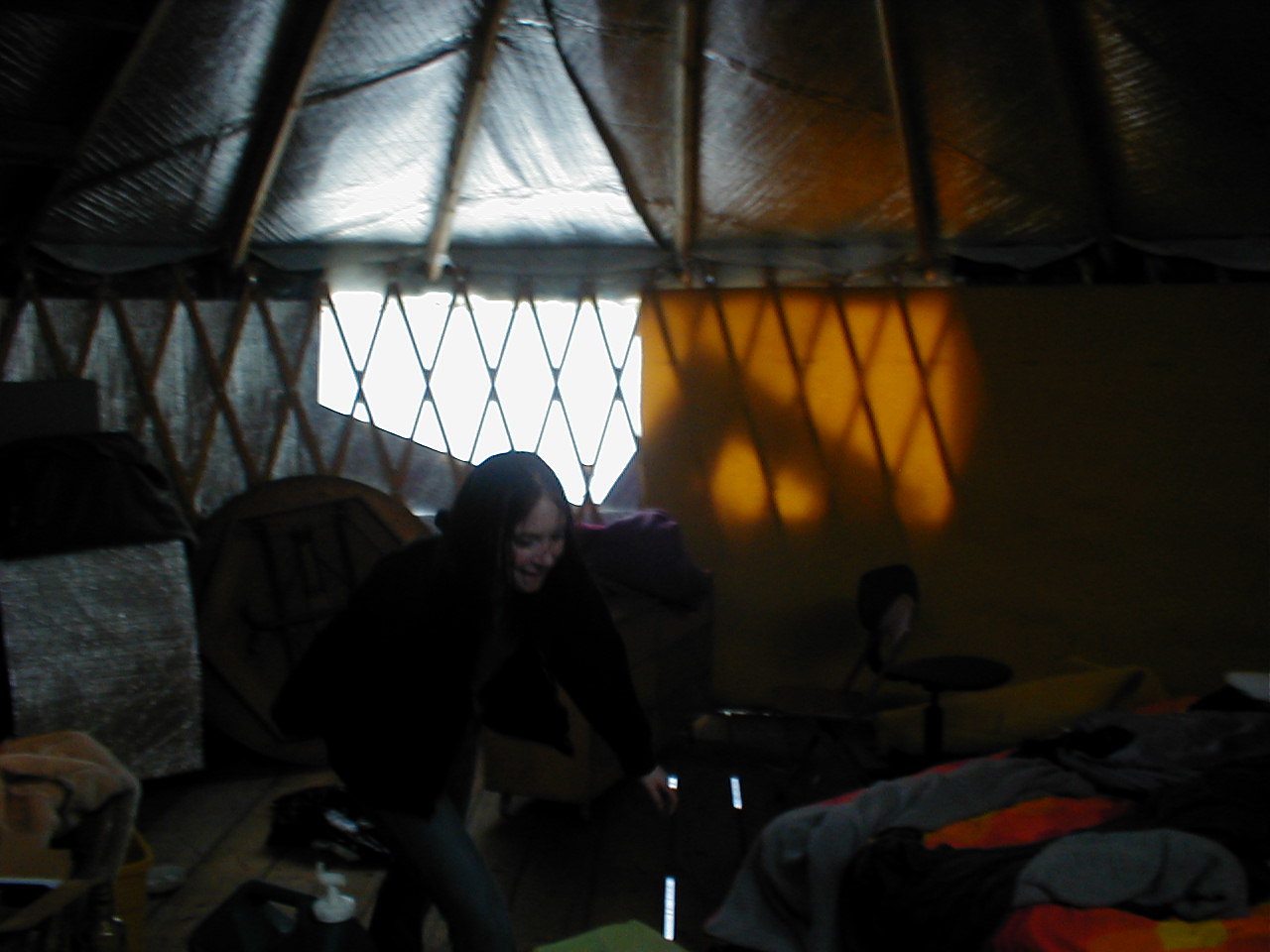

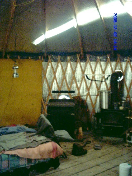

Walls were lined with Aluminum Foil Reflectix Bubblewrap and are rated at R 8.3 when used vertically. 6 mil Greenhouse Poly cover the reflectix, followed by used (FREE) decommisioned heavy vinyl Truck Tarps (blue color).
Top was constructed from first Reflectics (R 14.3 horizontal), then a 30x30 (square) polt top, and finally a white weather tarp. This is a cheap method, and we have since switched to using Sileage Tarp, mainly because it is available in 30 ft widths (no tape joints). A 30x100 roll is available for about $160 CDN, and it is 6 mil, black one side, white the other. This is enough material to make three tops, or one top and walls for a Yurt. My landlord went all out and ordered a vinyl 13 guage one piece top, white in color, but it was over $1000. Its main advantage is puncture strength. Give the nature of a Yurt, wind does not affect the structure like ordinary sheds etc., so roof top strength is not a huge issue - more is the method of tying it down. My Yurt top does not leak and we are constantly hammered with rain and recently winds over 100 km/h on occasion. It is however, very noisy inside during these times! I have a window in my top, which offers fantastic ay (and even night) light. If I did again, I would have used clear bubble wrap in the window panel (where the Reflectics is interrupted) instead of poly for better insulation. At the time I thought I wanted the clarity - for more light, but I learned that due to the reflective interior - you dont want "clear" windows of any size, your environment turns more "greenhouse". All of my poly (clear) windows are now covered in white tarps to actually diminish this effect, but still allow light. Clear bubble wrap, (if available in 3' wide) sheets would be ideal, diminished light and insulation.
My Yurt is heated with a small airtight woodstove.
My lighting is mainly achieved by outdoor solar lights, used indoors. They even charge while inside the Yurt, but I often take the out on a rack I made and sit them in the light. On a rainy day they will charge better in my Yurt, under the Skylight than they will outdoors - due to the fact they do not condensate.
Some Pointers:
Do not skip the reflectics. They are essential in any climate both to keep the heat in at night and the heat out during the day. Rememeber reflectics is not insulation - it bounces heat, like a survival blanket. Skipping the reflectics will leave you with a muggy, damp Yurt that may even "rain" inside. An Alternative for Polar climates would be refletics/insulation/reflctics.

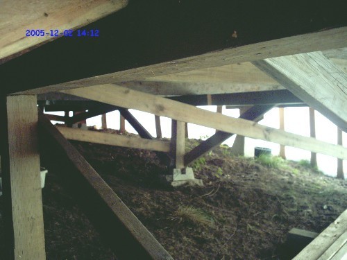

My Yurt floor is actually used, free 2x10 planks over the joice work, therefore the ground is under me, no moisture barrier. My skirting is poly to allow light in to control mildew / mold. I have open areas to let air in (but it is VERY important to skirt a Yurt on a deck or the wind will get underneath and inflate your Yurt, believe me its quite the experience, I saw 100 km/h winds inflate my Yurt, and there was nothing actually holding it down! I thought the thing was going to Take OFF! Fortunately it didnt and I got my skirting into place)
Any pointers on further mold control? I am wondering I i shouldnt have removed the forest floor humus (I was rushed and may do that in August when it is nice and dry) I am reluctant to put vapour Barriers under my floor - it will create an environment that connot breathe - right now plants actually live under my Yurt, grow, and stay green. Tree Frogs live under there. This all tells me so far so good - Id ont want to seal and darken the area, I personally beleive moving air and UV are good things.

The Hub.
The hub is in an integral part of the Yurt for sure. Our initial design is what I have in my Yurt. It is very simple. In my Yurt, the walls were made from 7' khana sticks, so my wall height is approximately 6'10. This is a bit high for a Yurt, but I'm a tall guy, so it was a compromise. I read somewhere that the wall heaight effects the ability to resist wind, and the lower, the better. While this primarily true, keep in mind even the walls have curvature. Having experienced very high winds I can tell you the walls were my least concern. What is of great concern is that wind does not get under your tarping, roofing, and in my case under your deck. My worst nightmare happened, as I was constructing the Yurt we receive tree-downing 90 mph winds and I didnt have any skirting around the deck! I didnt even have the Yurt "bra" (ropes that hold the top down, and the yurt to the deck itself). I thought the whole sucker was going to lift off and end up in alberta - it was really something to see! The top "mushroomed" there was so much air movement into the structure from winds getting underneath. The walls didnt budge not even an inch.
Nothing was actually holding down the Yurt to the deck, at all! It survived because of two reasons. 1. My reflectics are realitively heavy, and the second layer is poly, the third is white tarping. The wind would have had to rip the reflectics up ward, and literally pull the entire top up, and underneath the only rope I had holding down the top (imagine the roof overlapping the walls 16", with a rope wrapped all the way around the Yurt just below where the rafters meet the top of wall - on the outside). I had the rope just snugged enough that its actually diameter was less than the rooftop edge, and this was a good thing - nearly impossible for the wind to do damage. I have, of course, since added a top "bra, or second ring, which is fastened down, not only holding the top in place, but holds the Yurt to the deck. Another important part is don't make your deck any larger than the diameter - you'll have water running into your yurt.

by BCborn (kylecarrington (@) hotmail.com) on Mon Jul 11th, 2005 at 05:19:01 PM MST
Sure -
I will work on that. I used to have a digi-cam but someone stole it from my car - so it may take a little while. You may also like to see: www.yurts.com. Commercial prices for a 24' Yurt, range from $3000 - $12,500 from what I've seen, but that was way out of my budget - in fact, for under $3000 I will have built, plumbed, furnished, and heated my Yurt. As far as I know, many commercial models don't include reflectics, either, for that price! I can't imagine living in a Yurt without reflectics - however I live in the Canadian Rockies - an extreme area to be tenting 24/7 hehe. I will mention however, this is and always be a learning experience. To keep things in perspective our requirements were:
  1. Structure had to have enough living space to be comfortable, so 24' (450+ sq ft.) was our minimum size, unless your talking a bedroom addon Yurt.
  2. Structure should cost less than $1500 to build.
  3. Structure should withstand highwinds (100 mph +) and cold temperature (-30 c)
  4. Structure should be portable, and be able to build in about a week.
My Yurt meets these criteria - although I may end up paying for a few mistakes - we will see. An interesting thing about Yurts is, whenever you step away from the original Mogolian design - there are Pro's and Cons - Always - if only expense.
We have actually built a 16 ft Yurt from scratch for less than $100. It is however, more of shed than anything - but, it has followed the traditional Mongolian Design - using tree branches, and inexpensive canvass. The simpler the Yurt, the more portable - another consideration.
Thats it for now!

Regarding your question about moisture & mold control, I think that improving drainage around the foundation may be enough.  You seem hesitant to take too strong of measure, which I think is smart :-)  a good slope around the perimiter & perhaps some sort of french drain type system would seem to be the most natural way to dry it out under there & keep it much drier than the surrounding land.  With that much snow & the heat from you yurt it make take a large amount of slope though.
Re: Mold in Mongolian Yurt Style Structures (3.00 / 0) (#20)
by BCborn (kylecarrington (@) hotmail.com) on Fri Jul 22nd, 2005 at 02:02:47 PM MST
Well, so far so good. I sloped the earth away from the Yurt in all directions. Because I have a huge skylight in my Yurt, and the inside is reflectics material, + my floorboards have cracks between them, and my skirting on the south side is clear poly - the ground underneath has dried out. Plant life is still alive under my yurt and the leaves are green. Mold doesnt seem to be a big issue - so far. I may still scratch the earth away from the underside, but I'm not sure if I should. That would leave on clay and sand, making my Yurt even dustier than it already is, + perhapos provide a different grow medium for mold? I'm not a mold expert! I left the top side unskirted to allow a lot of fresh air underneath. I'll have to close it up more for winter but maybe then i will ventilate from inside the yurt.
~~ Create Your Own Future
Re: Mold in Mongolian Yurt Style Structures (3.00 / 0) (#21)
by bob golding (photoman290 at yahoo dot com) on Sun Jul 24th, 2005 at 05:59:57 AM MST
hi, i remember seing an idea that might be worth invesigating if you have acces to lots of pine trees and a big power saw, chain saw would do. you get tree trunks around 4/6 inch dia larger would proberly do, and  chop them up in 12 inch or so  lengths. then you lay them vertically on yur levelled ground. you fill in the gaps betweem them and you have a dry breathing floor.  you would need a lot for  a 24 foot yurt but i am sure they would work. i saw them being used as a path. any  water goes down the grain of the wood or in between them. not enouth trees around here  to try it.
Re: Mold in Mongolian Yurt Style Structures (3.00 / 0) (#22)
by ghurd on Sun Jul 24th, 2005 at 07:45:21 PM MST
I have seen cabins held up at the corners and a couple other places between that way.  Like pilings.  It lasts a long time for what I would have expected.  Some were guessed at 30 years old, but that is where there is permafrost and the wood was larger diameter.

I wasn't two days finished, when already I had wished I had gone with more, smaller, Yurts. Building a 24' Yurt all by yourself (for the first time) is a bit of a pain in the butt and at times, can be dangerous, unless you are quite careful. If I started over I would have actually built 3 Yurts. An 18 ft, a 16 and a 14, all attached, but all totally portable. You could literally pull off a bedroom and take it camping with you. Any Yurt is VERY portable mind you, in comparison to any structure with comparable sq. ft floorspace and room volume. Sometimes it is kind of hard to grasp how the thing stands at all, I once had an engineer sit in my Yurt having coffee and he looked around, for about 10 minutes, saying nothing, and then finally he said, you know, this just does not make sense that it even stands! I guess if he were to break out all his formulas and calculator, it would make sense, but I do know what he means LOL. First time visitors often make similiar comments regarding "beefing up" this or that - but, you know, I'm quite satisfied with it's strength, just as is. The cable that encircles the entire yurt, woven through the tops of the khana wall sticks, for example, is only a 3/16" aircraft cable. Guests have said, well you could just make this 5/16" instead couldnt you?? Then I go to the edge of a rafter and demonstrate how little amount of load actually exists at at any one load point by easily sliding the cable in and out of the rafter slot, with next to no effort at all. Often I get the question, well jeeze, you know we live in a normal climate - why didn't you opt for flexible foam insulation istead of this silver stuff? (aluminum reflectics) - the answer is two part - Firstly, flexible blue foam insulation (as used for sleeping mats for camping) could be very useful - especially for say Arctic applications - however - I would still have reflectics both on the weather side, and the interior. If done in a sealed fashion, this would like give you somewhere in the department of R24-R30. The point being, you still need the reflectics. You'd understand when you walked into my Yurt, and it's -10c, I light the small airtight woodstove, and VOILA, not even an hour later is 21c. Insulation alone is not going to make that happen. Radiant heat is very instant on!
Some would argue that the "look" is not appealing, but for me it's more about practicalities.
Smaller Yurts would be so simple to heat, you'd likely have the opposite problem. In a 24' diameter Yurt, with a rafter length of 11.6', and 42" hub on top, your roofvent is about 11'9" inthe air. An incredible amount of warm air collects here. With a smaller Yurt, this is reduced. (keep in mind this design is for Northern areas where snow is of concern. If you took this dimension down to the 18 ft Yurt, you'll find that the heat is closer to your head. I have a 12v RV roof vent fan, to help push the air down, and for winter I'll likely create a reflectics false ceiling to help hold the heat down a bit, in the sleeping area. Concrete pads around the base of the woodstove, and some backing panels (between the stove and the khanas) that will be mostly insulation, with a solar rescue blanket covering, to bounce and retain heat as opposed to losing it to the outside, close by the stove.

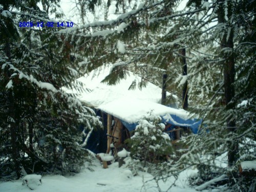

Re: Mongolian Yurt Style Structures (3.00 / 0) (#25)
by BCborn (kylecarrington (@) hotmail.com) on Mon Oct 31st, 2005 at 11:59:58 AM MST
Update:
Well my yurt is still up and standing and has seen some torrential rains and two storms with 100+ km/h winds. Here are some findings:

Re: PICS (3.00 / 0) (#28)
by BCborn (kylecarrington (@) hotmail.com) on Wed Dec 7th, 2005 at 06:31:08 PM MST
Heres Some Pics
Moisture Problems.
  1. Have reflectics outside khanas
  2. Get a big woodstove n burn lots of wood
  3. Use Tea Tree Oil
Build a Porch , you'll need one!~
BR>
The underside, nice n dry! Use sunlight!
Letting underside get south sun, but will reduce this area to about a 4x6 ft double pane window
My two woodstoves
It was -25 last night and over 80F in my Yurt!
Re: PICS (3.00 / 0) (#29)
by ghurd on Wed Dec 7th, 2005 at 07:06:37 PM MST
With -25' and +80'F, is that double walled?
dang thats cold either way.
Looks just like what we used in PA. except we didn't look under it.
Re: Is that double walled? (3.00 / 0) (#30)
by BCborn (kylecarrington (@) hotmail.com) on Thu Dec 8th, 2005 at 03:42:33 PM MST
No it is not. There are some slight adaptations though.
Notice the missing bits of reflectics on the interior shot, at head height. Should have added them. (although, on the outside roof reflectics, I had them overhang, so that does compensate somewhat, and the space does help wall breathing.)
What you cant see is wood strips that were inserted at the joint of reflectics (walls), that slip past the deck edge slight, helping space the tarping out from the reflectics. It probably would have been better to run the reflectics right over the edge instead of having them terminate at floor top.
My walls bottom edge are not real tight, they are held to the underside of deck, just back a bit (to create a drip line, with strips of garbage plastic and screws. Lts of room for condensed water to escape at bottom of wall, yet not a clear path for wind to infiltrate.
I'm extremely paranoid about mildew and mold, as I have a class A Allergy (BAD!) for the stuff. Can't tolerate much of it at all before it gives me a headache, quickly. In this project I was ultra concerned, as all the wood I used was used lying around, getting a bit moldy etc. I built this entire Yurt for $800 Canadian, discluding the woodstoves. Including two woodstoves, a fridge, a propane stove/oven, lights + porch - I was still under 2 grand. Consequently I pretty much made it out of garbage other people had given up on. There are some real good design features and some flaws, as to be expected I guess. If you could see my big heater a little closer in the pic, you would see it is 3' back from the wall. The pipe leaves the stove in the rear (as oppose to vertically). The 3' section and all of the pipe is 7" diameter, and for two feet, it passes through a section of insulated pipe that is oversize, it's 10" intended for vertical use. I used various nuts and bolts to "space it out". It's well supported for its vertical "weight". All pipe joints are screwed for extra security, and on the outside a steal stake, made from heavy T shaped 1/8" stock was pounded about 4 ft into the ground. Overtop that, is a "box" metal section, with small slits in it. 4 (3 1/2") framing nails were pounded into the slits to stop the box metal from slipping down any further on the T-shaped stake. Both sections originally were used for an overhead garage door (hanging type), and were bought cheap at salvage for $10. I have 3 guidewires/ropes stabilizing a 12' (4x3'x7" pipe) vertical stack. The stack and horizontal section are connected with a T, not an elbow. This allows one end down, which is capped, and drill out (holes in the bottom). I can pull the cap to clean out creosote, and the holes allow moisture to drip out, which I collect (sometimes gallons in a day!) for treatin wood posts that go in the ground. Consequently it's an awesome setup because nearly all the heat stays in the Yurt, and while this creates a bit of a condensation problem (thus the "juice"), it's collected and doesn't present a problem. Once a day I burn her hot, and once a week I pop of the stopper on the bottom of the T and clean out creasote. Sure, I could just burn it off BUT I'd risk sparks landing on my cheap roof ($50 haha). It all works out pretty awesome I can get up to 12 hour burn or more, or awesome heat for up to 6-7 hrs. Rarely have to get up at night, and if so, only once, which I do anyway to answer to Mother Nature. :)
Last night it was 27 below (celcius) and 37 above, in my Yurt, ran it a bit hot again~ I'm not sure what 27 below is in Farenheit but it's cold enough LOL any colder and your snot instantly freezes, and thats halfway out the door haha

Update: May 30/2006
Great success with moisture control. No issues - None. Even when unattended, with no fires burning through 2 months of the wettest spring weather, the interior of the Yurt never climbed above 25% humidity - all the while outside it was over 90%, often. Seems the work I did around the perimeter (Big-O) drainage, the skirting, and the woodstove took care of everything. The solar radiation from the skylights killed any in-room mildew. No problems whatsoever. I'd know - I'm very allergic to mold!
The skylights really helped, but I reduced their size. Unseen is a "screen-door" section. The roof never leaked a drop, and the Yurt is officially over a year old now. A new roof is planned for August (just to be safe), and will be Silo tarps. There are 2 new Yurts on the property too! they are bit luxurious compared to mine. Mine still has no power or running water, but, it might be getting a pipe this year.
New pics:
