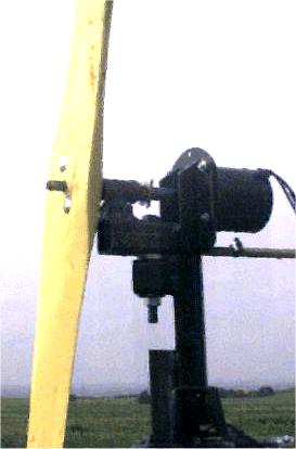

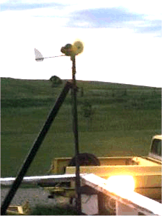

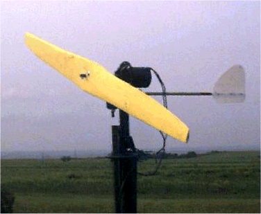

Interesting feedback here, in the last picture I posted you can see a headlight on and I had both the high and low beams powered. Now this was only in a good wind, at lower wind speeds I could run the low beam only with out stalling the mill.
still, given that a headlight is rated at 65 watt thats 65/12= 5 amp, not bad for a mock up mill with a 4 foot blade. it was the 2nd blade I tried as the first was running too slow, this one would really spin.... I mean stand back... when a good wind hit this one you would not want to be too close. but the trade off was hard to get started.
in a slow wind I'd give it a spin by hand and then it would keep going. It would self start in a good wind.

by techwolf on Thu Aug 18, 2005 at 10:50:33 AM MST
if memory serves me, I think it was a pmg with brushes from a auto heater fan.
this was direct coupled to the rotor. I dont know what car its from as I bought it surplus when I saw it. It seemed to have some cogging when i turned it by hand and thats when the bulb went on in my head.
