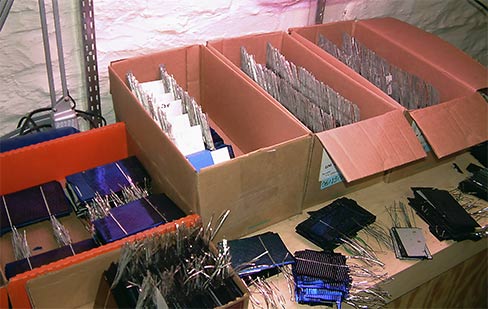

I got my solar cells today! So I immediately started getting everything together so that I can start soldering them together. Here are a couple pictures of the process.
I am using 1/8 tile spacers for the mock up. The plastic sheet is 1/4 thick and guaranteed for 10 years against yellowing. (I tried to get the thickest that I could to minimize flex) I will also use angle iron and pourable plastic to permanently fix the cells to the front. Since these will be used on a bus I would rather over build than run into problems later. I am just mocking up the spacing in this picture, so a hot glue gun works great. I have not taken off the protective lining yet.
One of the broken cells I am using for the mock up.
5 cells to get the spacing just right. I left 2' on all sides for a beefy frame, eventhough it is probably overkill.
Close up of the cells and spacers. I still have questions about exactly how to solder the cells together so please, if someone can take the time to explain it to me, I would appreciate it.
The frame taking shape. I am in a hurry and so have not trimmed all sides.
Close up of the corners. I am going to leave that bolt in place when I pour the resin. I don't plan on using it for mounting.
Notice what a rush will do to you when you are not carefull. One of the corners split while I was drilling it. Guess my resin will have to fill it in.
The frame almost finished. I will trim the ends off tomorrow and start to work on soldering the cells.
I still have to find out exactly how to solder the cells. My configuration will have 35 cells in series. (the piece of poly wouldn't allow for more, and I am anal about keeping things nicely lined up) Do I connect the first one's ribbon strips to the back of #2? (This would make sense to me, but I really don't want to use trail and error.

I hope you could say where you got the raw cells... I found a supplier in Ottawa in 1999 that had 12" by 12" cells without the pig-tails that yours has, but it was a one-time deal...
Any details like cost, yield (Ratio of good to bad) etc would also be appreciated...

(I forgot in my previous update) I have about 46 useable cells, and about 7 or so were broken, and I was being very critical. You can see from my mockup pictures that the "broken" cells are still ok, only minor chips/cracks. Only 2 that were seriously broken. All & all these were a great price and arrived safely/fast. Props to Ebay seller.

I purchased the solar cells from ebay, paid $75 and $10 for shipping. Seller's name is custdn If you search for "3x6, solar cells" you cant miss it.
