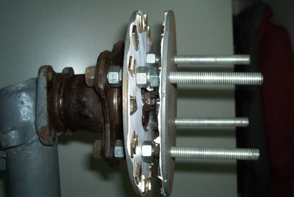

I'm from Peru, South America, I've read and learned a lot from this forum. I decided to build my first wind generator. No problems with the blades, they are 1m each (2m diameter rotor), I try them without load and work fine, very happy when I saw running so fast. But with the alternator, is anoother story, is very hard to get the magnets here in Peru, so I used HD magnets, I broke them in 2 pieces in order to have one pole. The problem is that nopw I have very little magntes. My winds are #21 wire and 160 turns, I expect to obtain al least 12V to charge a battery.
Any suggestions or comments to get the most power from this configuration?.

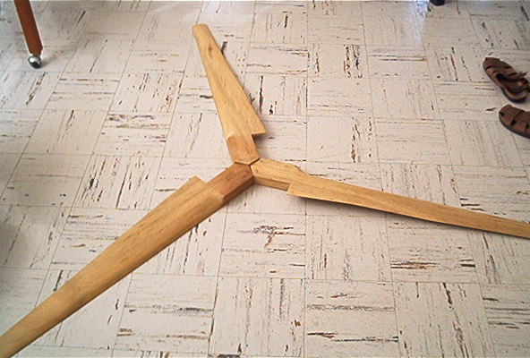

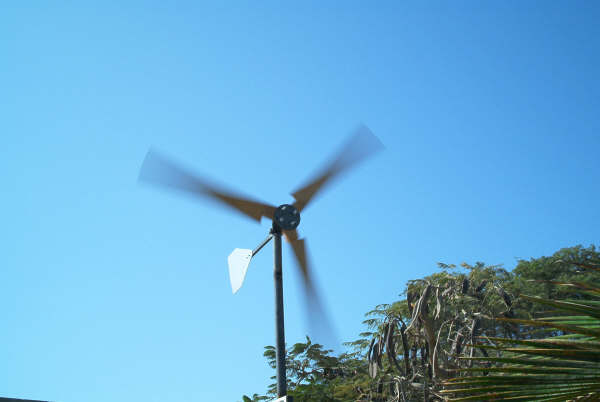

Blades without alternator, just a test, I can´t see the blades when running.

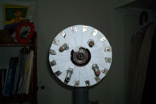

Double rotor with 16 poles

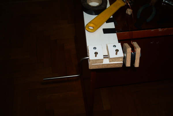

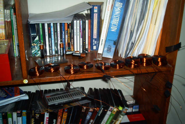

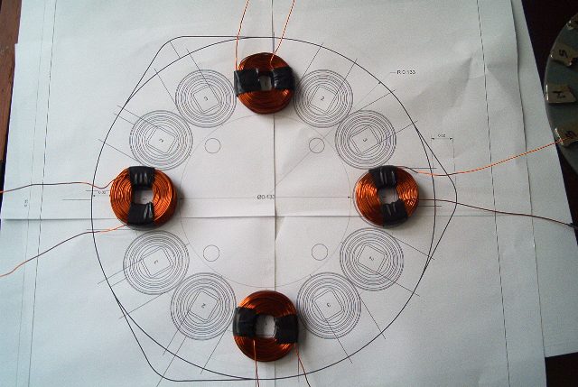

My wind former
12 winds, #21 wire, 160 turns

I know very little about gennies, but just looking I'll have to say that the air gap between the rotors is "way" too wide.
I don't know if you'll be able to get the air gap narrow enough unless you either get thinner nuts or cut/file the nuts thinner on the threaded rods...
From what I've read at O.P. and other sites the smaller the diameter of the wire in the windings the higher the voltage (due to being able to fit more turns in a given area) created with a decrease in amperage and wattage.
If I'm wrong here, somebody please correct me.....like I said, I know VERY little about this stuff

use thicker wire[#16or17]--75-85 turns should work out..make the hole in the coils about the same size as mags[a hair smaller is okay]..make the stator 1/4" thick,and you should get the max from your mags and coils..

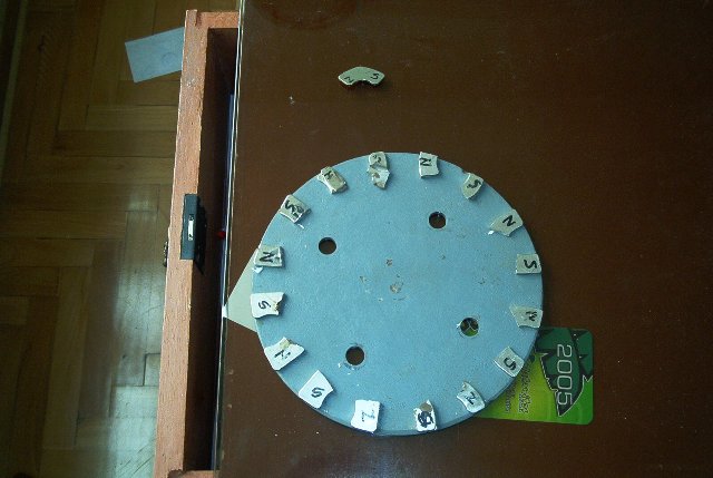

If I read you right I believe you have a fundamental problem with your magnets. You say you broke them in half to get 1 pole. When you break a magnet into half, or any number of pieces, you get smaller magnets with 2 poles each. I believe the problem with using hard drive magnets is that the poles run the length of the magnet when what you need is magnets that have poles on the face.
I believe there are a few posts here of folks using hard drive magnets.
Except for the magnets it looks like a beautiful set up. I'll bet our hosts would be happy to sell and ship you some magnets.
Good luck,
-Henry

 just just had the lab. double check my findings.( oh yea!)there are two poles per face one at each end .he's got it right.but isn't it standard to have the stator thickness about the same as one mag?
Re: Wind Generator with Hard Drive Magnets (3.00 / 0) (#8)
by hiker on Sat Sep 24, 2005 at 03:39:54 PM MST
nothing wrong with breakin the mags in half--his had both poles same side up--
when broke in half you end up with north on one side and south on other..

The problem with HD magntes is that the have 2 poles per face NS and in the opposite face SN, but when you break it in 2 pieces you get a magnet with one pole per face and the oposite pole in the other face. Thats what I have with my broken HD magnets and I can probe it when they atract or repel with the same or diferentes poles.
I drawed a 1:1 scale design for my stator, this weekend I will work on it.

Instead of breaking the magnets in half, why not just lay them out along the circumference of your rotors?
Space them maybe a fifth of their length apart as you go around the circumference (1 unit gap, 2 units north pole, 1 unit effective gap in the middle of the magnet, two units south pole).  You'll have more poles for a given radius - which is GOOD.  Rasies your frequency and the voltage (because the effective risetime of the field is shorter), lowers your cutin speed.  The polarity of the magnets comes out right for a dual-rotor if you position them so the bodies of the magnets are opposite each other.
Expand your radius and use still more magnets for more power, or to let you use more and thinner coils so the gap can be reduced and the field strength increased.

nice coils--but i still would go with thicker wire and less turns...
the way you have it set up now you will get high volts --but very low amps[if any].
rewind your coils with less turns if your going to use the same size of wire and you will get a few amps[amps is what its all about] and go with a 1/4" stator thicknes..

nice blades

Probably best to do a single test on one of the coils and find out what you get.  to be honest (and I made this mistake) you should build the PMA and then design blades to power it, not the other way round like you (and I) have done as this limits the power as if the blades are to big they spin to slow and if there to small they won't have enough torque to turn in lower wind speeds.
Basically do a single coil test and see what you get then come back to this post or another one and tell use what you get.  From this we can help more.

I made a test with one coil, but I think I did'nt make it right because held the coil with one hand and spind the rotor with the other then I watch the meter and read 0.8V but I had to use a big air gap to avoid touch the magnets with the coil, remember I was holding it with my hand and it isn`t very firm.
So I spect more V with a thinner air gap, hope so. I know that maybe I not going to reach 12V but I want to try it in the time a get a bigger magnets and make a new Genny

Finally I cast the stator, I forgot to use wax, had problems to get it off the mold, but it'ok.
Now is installed with the rotors, when I spin it with my hands I have 7.2 per phase. I thinking to wired it in star configuration, how much volts you think I will get with 3 rectified phases. Its ok to connect it in star or delta with this volts per phas. I want to char a 12V battery. One phase has 4ohms.

I am surprised with the 7.2V.  Good work!
Have you considered rectifying each phase seperately?
Like 3 single phase generators in one stator.
I have a feeling with 4 ohms per phase, and 7.2V at low RPMs, it could work out much better.
I also have a feeling the blades might be too long. Shorter blades of the same design will run faster.

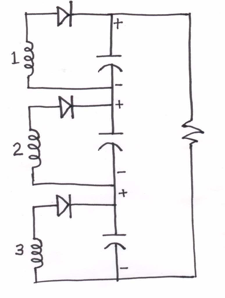

When he mentions rectifying each phase separately I think he means running each phase through a diode (rectifier) to a capacitor to set up the output voltage for that winding.  The three outputs are then stacked or added to form the output voltage to the battery.  This should get you the maximum voltage possible for a given alternator rpm.  We recently went through a discussion of the merits of such an approach.  Check my recent comments to track it down and find a schematic for the circuit.  Just keep in mind that there are no single answers in electronic design.  You have to tailor the design to fit your needs.

hello fin, how you doing? i think i follow gurds method. instead of going star or delta  he's turning the output of each phase into dc and then combining them , i'll try to find the post you describe. am i right in thinking the dc can be combined in paralel or series?

Yeah, you can combine dc voltages in series at will if they are floating (neither one is connected to system ground - well one can be).  Parallel, no, as you can get nasty circulating currents if there is a slight imbalance in their values.  But one can work around that by adding resistors to the circuit.  Anyway ,here's the schematic:
The capacitors are necessary for proper operation. Without them you will have the three phases adding, which gives zero voltage at all times.  System ground would normally be at the bottom.  The resistor represents the load.  Without the capacitors the mid connections go nowhere.  I feel it's important for people to understand that the dc voltage has to appear across something in order for it to be stacked with another, so I dug up the schematic.  Sorry about the size.  I'm beginning to think that this stuff should be put in a FAQ for easy reference.

Yes. Each phase full wave rectified. Then paralleled to the battery.
Just sounds to me like, was it 7.2V(?), at low speed by hand, combined with 4 ohms per phase, that if it was wired in star it might be a better at higher voltages than 12V.  I could be way off, it's all based on reverse enginering of my failures.

I just finished the shunt regulator, I did some test and work fine with the genny. It´s making 120W, 450 rpm max. I´m thinking on making a shorter blades (0.7m) to get more rpm. I think the blades are too big for this little genny.
When I have all set up I will post more photos
Francisco
Re: Wind Generator with Hard Drive Magnets (3.00 / 0) (#40)
by ghurd on Wed Nov 09, 2005 at 08:50:54 PM MST
Making 120w is good!
I also believe the blades need more rpm.
The blades look not twisted in the photo.
Twisted blades work better and faster.
(The worksmanship is very good for the existing blades.)
There are good photos here of Zubbly's twisted blades.
http://www.fieldlines.com/story/2005/5/17/16437/9630
Notice how the change at the root is rapid.
The change at the tip is very slow.
Windstuffnow Ed's blade program may be a good investment for US$5.
It works with blades under 1 meter. Many blade design programs not good for blades under 1 meter.
