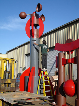

i've been working on this lighthouse sculpture for a few months now  and i'm almost finished. the idea is that it is a working lighthouse, self sustaining, on a smaller scale of course. this is the first of hopefully many to come.i have been through a lot of experimentation (a years worth) as far as what to use as a power source and in the process converted a induction motor, made one dual axial flux alternator and one single. i ended up using a tape drive motor as that gives me the most volts for my low rpms. i have it hooked up to a timing belt which gives me an 8 to 1 ratio. i know my design isn't ideal for this application but its what i'm using.
on average (a light breeze)i'm getting about 2-3 volts. today, my multimeter was hanging out at around 8vdc. my goal (and it seems very difficult for me to find any help here) is to charge some batteries all day and at night use that power to light as many LEDs as i can. i know that i need a diode to keep the juice from going back to the motor and i think i need a voltage regulator so i don't put to much juice in the batteries all at once. but then......i've seen those battery holders but where are the leads out. i must also need a photo cell on the circut and then a resistor to save the LEDs. could anyone help me draw this up so that i can buy the stuff and install it? i have a good friend who's helping me with the electronics, he only needs some kind of schematic. this is one circut that i want on the lighthouse but there is also another...........it would be nice for it to act as a wind gauge, either lighting different colored LEDs at different voltages or getting brighter as the wind increased.
any help would be greatly appreciated.

What is the object to the right of your step ladder?
Dave HK

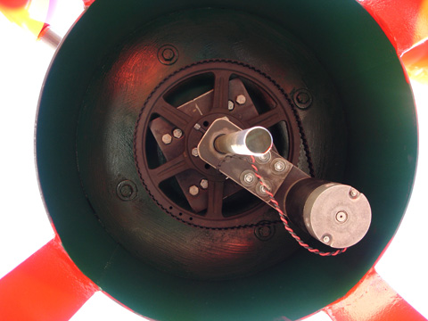

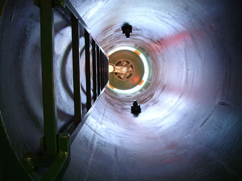

many thanks to ghurd for the email. here are a couple more shots i took today. the first is looking up from the bottom and the second a closeup of the pulley system (timing pulley), geared 8 to 1. can't do any better that that on this one, don't have the space or the tork. the lights and circut will be mounted on the shaft and turn with it. i really only need to charge some AA batteries (or something) to light a few LEDs at night, and as ghurd suggested have any over charge light additional LEDs. this thing has been putting out 4 volts with some 8-9 volt moments on a daily basis. it does 1.5-3 volts in a light breeze. i think that in a storm it may hit 20 volts so i want to be able to utilize any power it may put out. how might i hook this circut up? thanks,
aaron

the batteries, circut and light will be mounted on the shaft and turn like a lighthouse. it almost sounds like you know of some ready-made solar-battery charging unit that i can use. but what about the irregular voltages?
aaron

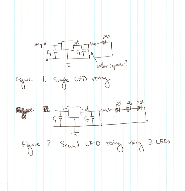

I'm jubal, aaron's friend. We are going to use progressive lighting of the LEDs for this first lighthouse. I've used voltage regulators (VR) like the one shown to regulate small voltages (NTE956 1.2-37V). But i've never powered anything using a dc motor. However, using a VR properly requires an added 3V for the system, in this case then, 6V to power 1 LED. ive' found that even without the regulator, it is taking above 4V to power 1 2.2V LED using a 24 Ohm resistor, which is expected, but not desired. If I wire the LED strings so that they are only protected by resistors, it still takes about the max voltage we generate from the mill to power 4 LEDs approx 12VDC. This may be acceptable, but it will lower the lifetime of the single LED string (Figure 1 without the regulator). How would I spare this poor LED without the regulator? I was thinking of just using a higher wattage resistor, but remembered it won't protect the LED from any increased voltage.
Getting back to the voltage regulator, I was unable to get any light from the circuit in LED 1, I think because I used tantalum capacitors instead of electrolytic (I took a chance, that's all the store had), but I wanted to verify that. But mostly I need to verify the rating on the caps. I'm using C_1=100 microFarads and C_2=10 microFarads (both which should be electrolytic, I think). And secondly I am wondering if there should be a C_3=.1 microFarads of ceramic or polyestor material. If these circuit diagrams checkout, and all I need to verify is the rating and type of component to use, then these strings will be connected in parallel. But it won't help the fact that it will require so much voltage to light the single LED string in Figure 1. Please advise, thank you.
Re: circut for my lighthouse (3.00 / 0) (#19)
by laskey on Thu Sep 29, 2005 at 07:58:54 PM MST

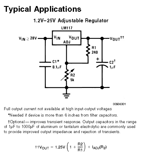

I would put them in parallel, and you want to increase that resistor to about 100 ohms.  Check the working rating for your LEDs. But I'm pretty sure they won't need more than 20 mA each.
I'm positive you don't need C2 or C3.  The problem you are likely having is that this is an adjustable VR, and not just a VR.  I looked it up on google, and it's data sheet says that when you ground your adjustment terminal it locks the output to 1.2 volts, which will just barely light those 2.2 volt LEDs.
Pick that adjustment terminal up from ground and place a variable resistor between it and the output terminal(with the third leg to ground...so you have a variable voltage divider). and you should be able to program your output voltage from there.
also remember that if you exceed more than 20 Watts of disappation this VR will start to shut the current down until it cools off to 20 Watts... which I don't think will be a problem here.
Hope that helps,
Chris
Re: circut for my lighthouse (3.00 / 0) (#20)
by laskey on Thu Sep 29, 2005 at 08:31:54 PM MST
Here this part of a PDF might help.  Your VR is alot like the LM117.
Hope that helps,
Chris

Perhaps I don't quite understand. You are planning to use a slip rings and brushes to connect the charging circuit to the batterys?
Pep
Re: circut for my lighthouse (3.00 / 0) (#24)
by Aaron on Tue Oct 04, 2005 at 09:45:55 PM MST
pep,
if you look at the last photo i included of the inside, you can see that the TDM is mounted to the shaft, so the wires, circut and light spins with the shaft. i did it that way to avoid brushes. the 16" pulley is stationary, make sense? saw 15 volts dc yesterday in high winds!
aaron
