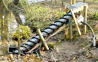

Re: I need a "lift" and your help (3.00 / 0) (#19)
by Flux on Sun Oct 2nd, 2005 at 09:59:59 AM MST
This one is driven by a small dc motor fed from a windmill. You could do the same with a solar panel, but you could extend the shaft to the right and add a paddle wheel to drive it, we didn't have enough water to do it that way.
<BR<p> There is also a small ram supplying the same lake. This has a head of 2 ft and is about the minimum for totally reliable operation. I have run them at 18" head but you need a fair delivery head to keep them reliable at that. In your case with plenty of water, efficiency doesn't matter much and a ram may still be possible but if the head changes much with stream flow it may cause you problems. Without special valves and a lot of care 3 ft is desirable for a ram.
Re: I need a "lift" and your help (3.00 / 0) (#22)
by Linda on Sun Oct 2nd, 2005 at 02:29:16 PM MST
Flux,
Thanks so much for this info.  Is the rod shown in the picture wound with a "hose"?  Does the Archimedes Screw operate on the same principle as the Spiral Pump?  Do you know of any websites that would provide deatiled information and design info. on this?  Do you know if a Ram pump will make a lot of noise?  I've been told it does.
Thanks again for the help.
Linda
Re: I need a "lift" and your help (3.00 / 0) (#25)
by Flux on Mon Oct 3rd, 2005 at 01:35:53 AM MST
Yes the central steel tube (industrial extractor pipe) is wound with hose used for pond pumps( cheap and easy to bend)
The spiral and screw pumps work on a slightly different idea. In the screw pump there is no compression. A quantity of water sits in the low point of the pipe and is "screwed" up to the top where it runs out. Each loop of pipe has a moving pool of water.
The spiral pump is intended to pump to a head  and each successive spiral has a portion filled with air and the rest filled with water( like the screw) but each column of air is slightly compressed ( like a manometer) and the sum of the compressions gives you a head that it can pump to. If the head is too great the air will blow back.
You could probably make a single turn spiral pump that would deliver to shaft height without compression then it would be similar to a screw . You could fit several single turn spirals round the wheel. May be easier than a screw as the paddle axis is vertical.You may need 2 turns if your intake level is low.
The Hydraulic ram makes two sorts of noise, mechanical and hydraulic. If you follow the usual crude plans there will be a lot of clanging from the metal valves.
If you use rubber faced valves there is little mechanical noise. Hydraulic noise is caused by shock in the drive pipe when the waste valve closes. At high heads it is considerable and can't be avoided but at heads below 3 ft it is negligible. The ram I mentioned is almost silent, but we did bury the drive pipe as that is the main source of noise.
If you Google search the net for spiral pump or Wirtz pump ( the original inventor) you will find a few articles, mostly on the compressing spiral pump, a bit of emperical design but nothing detailed that I have found. Nothing useful on low head hydraulic rams and not a lot on the Archimedes screw except for large scale drainage with rotating screw in a stationary tube( not what you want).

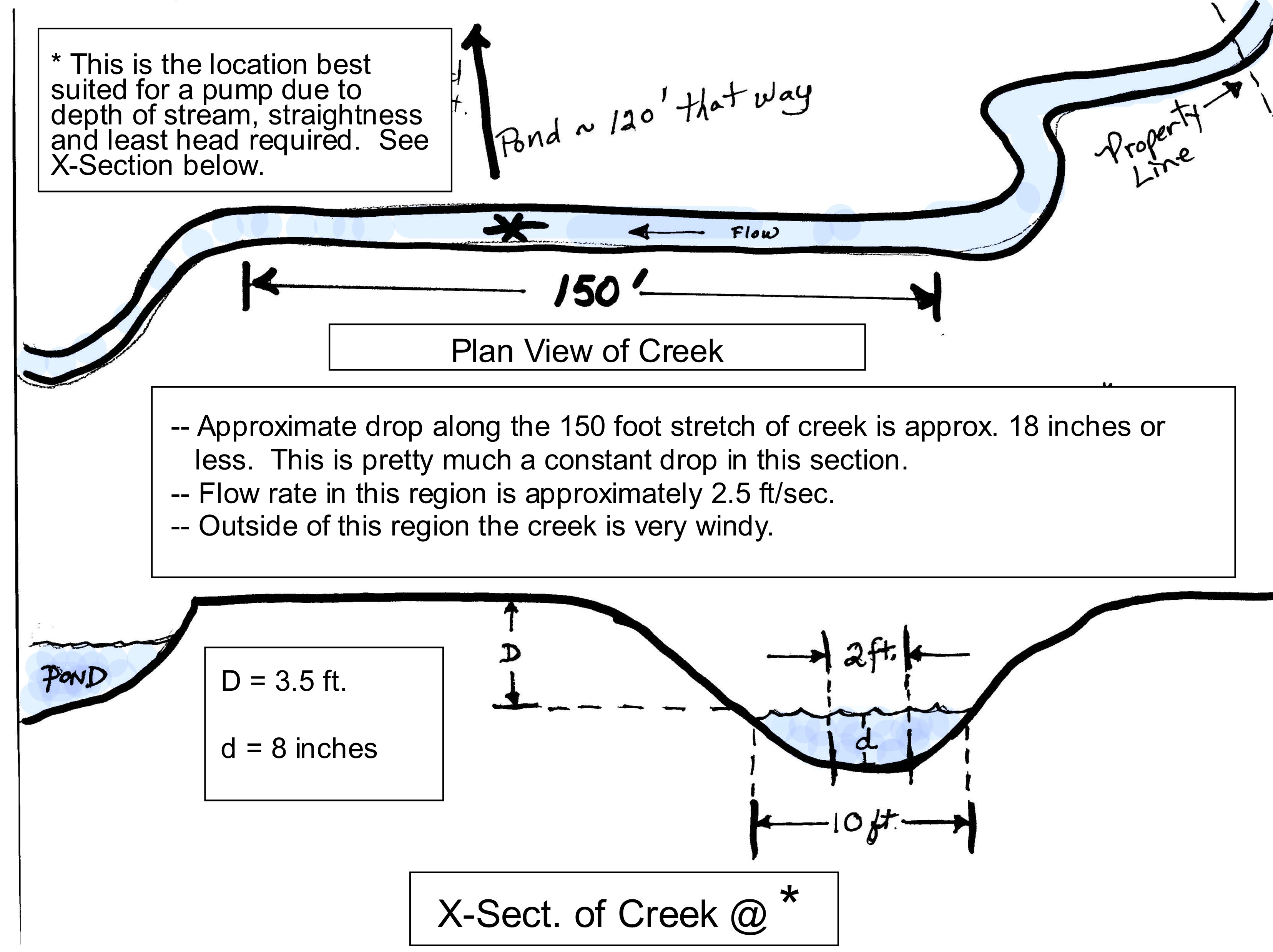

Re: I need a "lift" and your help (3.00 / 0) (#30)
by Linda on Tue Oct 4th, 2005 at 09:10:25 PM MST
Nando,
Well I wasn't able to get a laser but I did get more data for you and I've put it into this sketch.  I hope this is readable.  Thanks for your help.
Linda

Re: I need a "lift" and your help (3.00 / 0) (#34)
by Nando (nando37-at-tx-dot-rr-dot-com Correct theanti-spam) on Wed Oct 5th, 2005 at 04:07:48 PM MST
Linda:
You did not measure the height of the water from the enter point to the exiting point.
Assuming just 18 inches is a bit difficult to tell you what to do.
With a RAM PUMP you could raise the water the 4 feet necessary for the "over the Hill" travel. A pipe along the bed going up to the stream as much as possible for the Ram Pump to operate --- good workable system because you are just raising water around 4 feet or 1.7 PSI -- a 1:4 ratio would be a good arrangement
Even if the stream is windy, unless it shows that the water does travel very slow, it would be good to have the head to add to the 18 inches of the straight area.
Four ways
  1. the Ram Pump [as above] or
  2. small turbine to raise about 20 % of the available water into the pond or
  3. a small water wheel, Poncelot type with containers filled at the bottom and about 4 feet diameter( high enough for the released water to pass the "hump" between the stream and the upper part of the pond area.
  4. your failed initial sling pump -- which looks the best with corrections = which means that you need to tie the front and the back via heavy swivels to maintain the center of the sling pump in the water center line. -- this last one was done about 6 years ago for small village to bring water to a tank about 5 meter height, though the water head was 3 or 4 feet and a larger water volume. The water way needs to be modified for the sling pump around it to optimize the water movement.
The Spiral pump, mentioned by somebody else, seems the best and easiest arrangement for you, since it is mounted and fixed and just a few pipe loop turns are needed for the 4 feet raising, you will, as well, need to pipe the water to the wheel to get the necessary pressure to move the wheel
What are you mechanical abilities ?.
Regards & let me know
Nando
Re: I need a "lift" and your help (3.00 / 0) (#36)
by Nando (nando37-at-tx-dot-rr-dot-com Correct theanti-spam) on Mon Oct 10th, 2005 at 07:24:53 PM MST
Linda:
Looking to your sketch, I see that there is a good possibility using a paddle wheel, type Poncelot with buckets to raise the water about 5 feet so you get enough slope for the water to pass the HUMP, all the way.
If you are interested in making the wheel, let me know to direct you, since you as well need to form the channel to obtain the best energy of wheel coupling to water energy and levels.
You will need to pipe the water to get the needed energy to drive the wheel with enough torque to raise the water 5 feet.
Also, you can use the spiral to raise the water attached to the wheel -- this would be the best arrangement, in this case about 4 to 4.5 feet radius will do the trick to have the exit pipe without any swivel valves.

by Linda on Mon Oct 10th, 2005 at 08:55:45 PM MST
GeorgeT,
This sounds interesting, but I don't understand how the "pump" works, can you draw a sketch?  It eliminates the need for a rotary fitting, which as you can read in my post to MaxFlow is my big hang up right now.  And I apologize for the "oversized" pics that I posted!  my mistake.
Linda
Re: I need a "lift" and your help (3.00 / 0) (#39)
by Linda on Mon Oct 10th, 2005 at 09:10:13 PM MST
Sorry everyone!  I didn't expect these to be so BIG.  I went in and deleted these 2 pics from my uploaded file, but it still won't make these big things go away!  Does anyone know if this can be fixed?  I'm just not savvy enough.  From now on I'll just attach the link to my pictures.  Sorry again for messing up the format for this posting.
Linda
