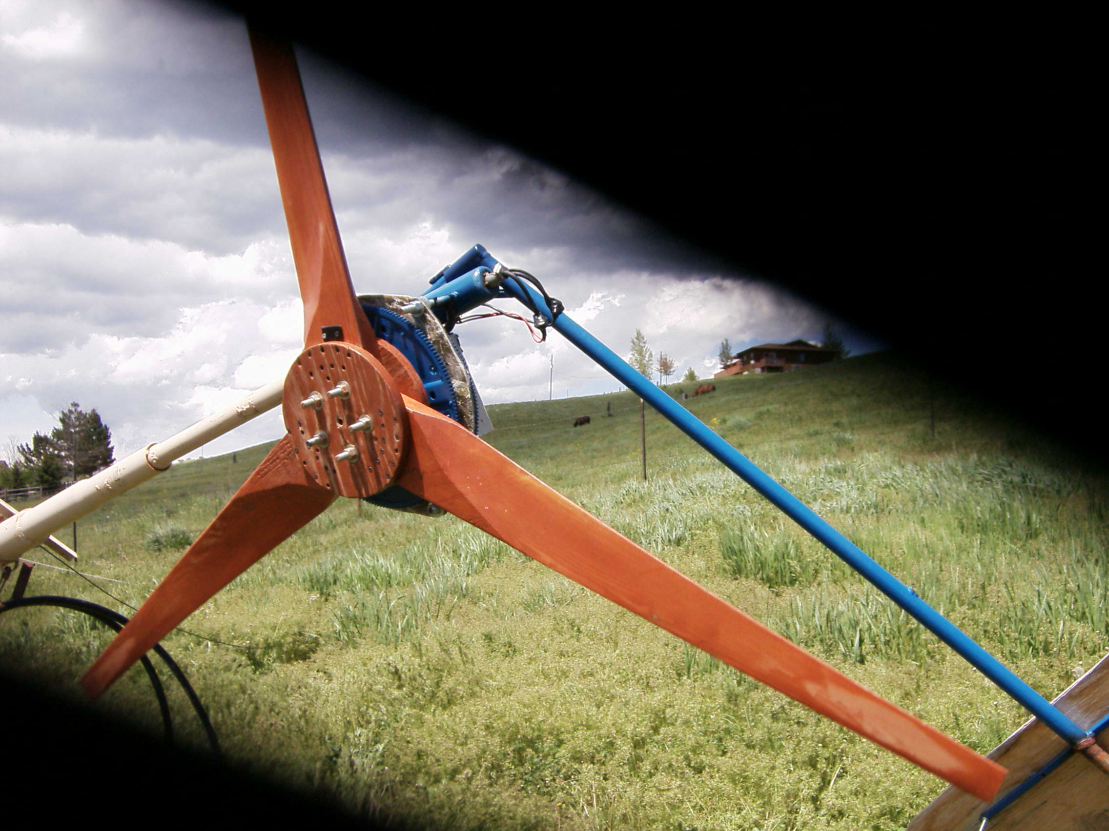

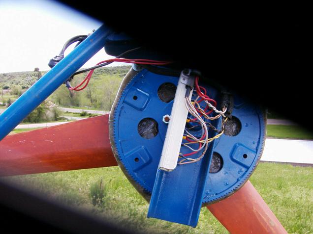

I have couple of pictures of a miil that i made using your plans as a guide,. i already had some ceramic mags  so decided to use them   I used flex plates from a350 chevy eng.13in in diamenter.with 12 flats on them.after getting it to gether my voltage was to low so i changed 12 of the mags to 2x1 neos.  That doubled the volts.It has been up for over a year . i see 50+ amps.sometimes a it hase held together very well. i figure it puts out about 5 times the output of my old 200 watt windko that i have been using for about 20 years.Thanks for all the contrabutions that you havemade. Iam  w orking on a 15 in with 16xpoles and 12 coils now . and also a 24in 40 pole with 30 coils. just cannot stop playing with them . it hase been a hobby of mine for about 30yrs.

The stator is so thin...

sorry for the large pictures thought that i had the size right this time

don't worry about the size as far as i am concerned, the top picture is an artform!
not often that once get such sharp contrast, clarity and sharpness of color.
and besides the genny is beautiful
great work.
bob g
ps. can i order a poster print of the top picture? , :)

 thanks very much for posting , ive got two flex plates mounted to a trailer hub  right now.  you have expelled any doubts i had .did you take any measures to level the mounting indents and holes?
Re: brian parsonsmachine (3.00 / 0) (#5)
by electrondady1 on Sun Sep 04, 2005 at 11:57:02 AM MST
ok, i can see what looks like your stator through the holes. are you saying you changed just one rotor to neo mags and left the other with ceramics?

yes ijust put neo on one side and it doubled the volts. it is 5 phaze.100 turn coils  it seems to be about right for cut in speed. i am losing some of my flux as the flex plates are so thin. my stator is 7/16 thick.hope that helps you?
