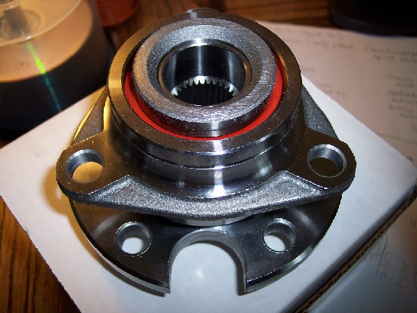

Hello All, I am continuing this post from a previous one that I started with a subject line that actually has something to do with what I want to find out.
The hub that I want to use for my alternator looks exactly like the following picture.
The problem is some folks think that this is not a well designed hub/bearing combo for use in a windmill. My feedback so far has been that the hub portion of the  assembly may eventually walk it self off with vibration and time.
Facts.
My main goal is weight savings in this phase of my design.
Questions.
1. What is the best way to make sure the hub stays where it is and does not slide out of the bearing?
I have attached the following illustration for reference. The through bolt was just an idea I sketched, This could be a spindle or whatever. I dont want to have to use another heavy chunk of metal or another bearing in the mount as I think that would cause to much drag. But If I have to I will. Eager for your imput.
note: I do not want this advice. lol

ok, you are still missing my point- lets try an immage, and a glossary.
  1. spindle is the 'upright' that has balljoints and/or a strut and the steering arms connected to it. it has nothing to do with the hole in the center of the hub. that is where the cv joint end, or half-shaft drive end goes.
  2. this thing has more parts that you realize. that silver ring with the beveled inner hole is generally a separate piece. it is pressed on after the bearings, and makes contact with the inner race of the inboard bearing.
  3. the cv joint makes contact with the inner surface of that ring, and the outer surface of the hub. It does NOT make contact with the spindle or the hub carrier, hence, your idea of another bearing or a huge washer or a bolt into your mounting is wrong.
try the below picture, i turned your drawing into more of a true cross-section. note the blue ring. it will slip off the hub, and then the hub will walk out the front of the two bearings. washers reach out to stop that, though the end of the cv would work better.
there is no additional drag from this design, you are just keeping the bearings held in place.

 I think I am beginning to understand. I was not aware that the beveled ring was a seperate piece. This was my original idea more or less, but I was not sure how the bearings were situated in there and secured, If the rings purpose is to secure the bearing position that makes sence then.
 I do feel better about this design, providing that I have enough pressure keeping everything intack with a head bolt or something similar in function.
I was even going to extend the "bottom washer in green highlight" past the diameter of the "bearing container" so that if there was any movement it would only move about a 1/8th of an inch and keep it from falling off completely. Of course by that time I'm sure the stator would be chewed to bits by what would be disk 2.
I wonder if there is a type of bearing that I can fasten before the bottom washer goes on that would remain in contact with the bearing container and  allow it to maintain adequate pressure and not add a signifigant amount of drag. probably not neccessasary though.

if you wanted to extend the washer out so that the hub cannot fall out, that would be fine. however, the only reason that washer would ever make contact with the hub carrier, would be that the bolt has broken or stretched. in that cause, the larger washer wont be connected to anything :)
if you are really concerned about contact, and you want a bearing in there, look at torrington needle bearings from most any transmission. they do exactly what you want, but are not cheap, and have flimsy races usually, so you have to machine the parts well. i dont think you need them, just use the bigger washer with the 1/8th gap out to the hub carrier, and dont worry about it.
if you use a head bolt, make sure to use locking nuts, or crossdrill (or weld!), and be aware that modern headbolts are designed to stretch, so i recommend a used head bolt (though it sounds crazy).

Save yourself the problems go to a scrap yard and get a hub off of the back of a dodge K-car,shadow,caravan etc they bolt on with for bolts and bearing are cheap they don't require a stub axle to hold it all togather.

One other thing. FWD hubs usually have substantial preload on the bearings when properly installed. You should be able to reduce drag considerably by using a more standard spindle. Even more so when the proper bearings are used. Look at a bicycle hub bearing for inspiration.

Of course you'll never see those kind of loads in a windmill. Look at angular contact type bearings and let them run a bit free. This is one reason why I would recomend building your own hubs but I also understand that it's beyond the scope of a lot of people. Very handy to use Volvo hubs and we know they work. Ball bearings, by their nature, tend to be much easier to turn.

I was referring to angular comtact ball bearings. They act like tapered rollers but carry less load and have less frictional losses. It's just a thought.

I chose this particlar hub/bearing because it spun the best out of about 100 that I went through. Cheers for the autozone guy who let me rummage through all his new parts. I think I may have a convert tho! I think with some rotors on there and some mass that thing should spin for about at least a minute if I give her a good spin by hand.
I also asked autozone guy if they tend to spin better as they wear out. He said, "generally they do."

yes, in fact i have a pile of used hubs from 4x4 s10 chevies that i was planning to do something similar with :) the used ones turn more freely, and are available for a couple bucks at the salvage yard...
basically- tapered roller bearings have more load carrying and heat transfer capacity, due to increased surface area. they are also self aligning, even without preload. they are higher drag though, because there is more 'glueing' effect with the grease on all that surface area.
ball bearings have adjustable preload, and less surface area, so they can potentially turn more freely. i dont know of any modern car that still uses them, but some brake-less trailers still do.
i think the difference is not worth worrying about, if it spins good by hand, it will do so with a prop on it.
