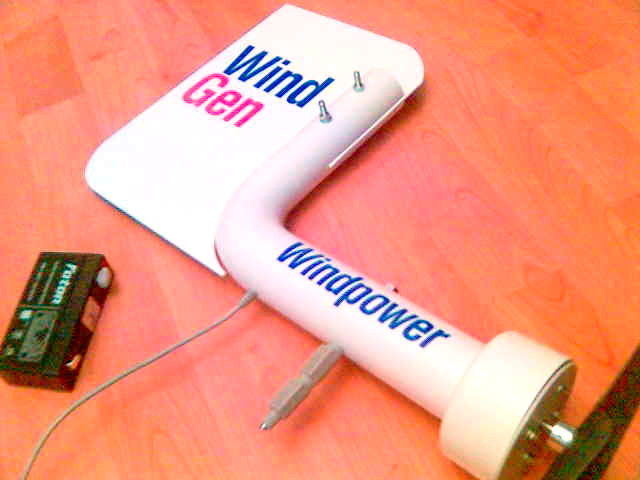

Hello everybody!
I just wanted to share the joy I feel when watching my first mill. The output is 6-15V and 0.150 Amps - but hey, it's working. My portable radio plays when I spin the blades by hand. One super-bright LED does work at low RPM. Up to three at high RPM's.
The blade is cut from a 10cm plastic tube, the body was some L-shaped toilet tank pipe I had around and the tale is komacel (some white sturdy aerated plastic sheet used in outdoor advertising - very light. The stepper is from a inkjet printer, inside the body there's a full bridge rectifier with a 47uF cap on a veroboard.
My initial idea was to insert a 9V 140mA battery in the body along with some small holes in the tale's lower side for three white LED's to light up the area around it.
The stepper would charge the battery that would light up the LED's. I wanted it to be completely autonomous so a daylight switching circuit would be required. The plans I found for such a thing were way too power-hungry for my 9V battery. I finnaly decided to take the wires out - it's more fun when you hold the wires ion your hands figuring out what use could be next :-)
As I'm a graphic designer it was only natural to make some stickers... the final touch. Looks nice. I still have some glueing to do in order to keep it waterproof, but that will come. I already plan to start building a bigger one...
Thanks to everybody on this forum for enlightening me. Even when the wind's not blowing. :-)

Pretty darn cool!  I think the only thing I would have done differently is to have the bent tail pointed down, to lower torquing forces on the yaw axle and prevent rain from possibly finding it's way to the stepper motor.  Might cause some hunting though, being it will be in the wind shadow of the tower.

I actually considered it. But I didn't liked the look of it. The yaw point is drilled considering the overall balance so that's the point where it's leveled. The tail will be sealed with some cap cut in half and glued. As I said, I still have some finishing touches left to do. Thanks for your appreciations.

Looks great!  I would still put a drain somewhere in the bottom of the flush elbow for any rain that makes its way in.  Rich

If you can find the stepping motor from an old 5.25" floppy drive the head positioning motor makes a neat little mill. It will produce more power and these types of motors have a nice set of bearings. I have a couple that are over 3 years old and still spinning nicely.

Actually I have one stepper like you mentioned. It was my first choice initially. I even used it before final assembly. Took it for a ride outside my car's window and at 20 Km/h I got 80Volts (!) but a VERY dissapointing 0.05 Amps. So I changed it. I still plan to use that floppy stepper to light up ONE LED as it's all it really can do.
The next one will be using this stepper
http://www.fieldlines.com/story/2006/9/4/6719/74772
this stepper is a 5-phase motor and I wired it accordingly (thanks ghurd). The output is around 12 Volts at 0.5 Amps. I also have another big stepper taken from a big old laser printer. It puts out easy 12 volts at 0.8 Amp. These babies will be the weapon of choice on my future projects.
