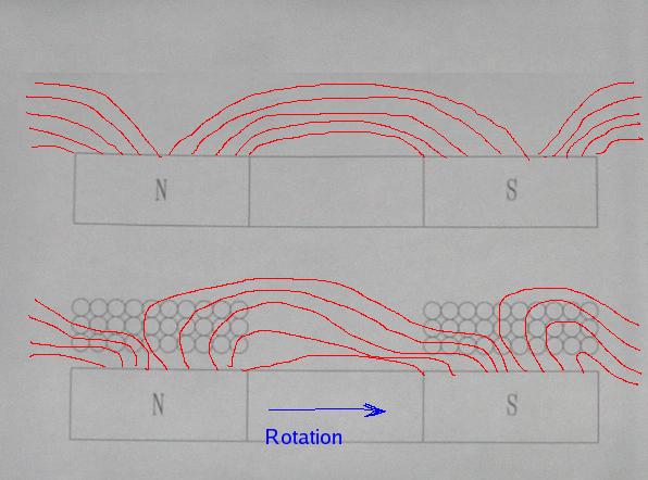

Do flux lines act like elastic force fields?
I have been testing my new 16 pole stator for the RACA. I placed the rotor inside of a 6" copper pipe. I can move up and down easily. But when I rotate it there is great resistance. This is interesting but I want to understand better. This diagram is my first attempt in this direction.
The first set of magnets show what I believe the invisible flux lines would look like, at rest and unimpeded. Do the flux lines have a a known direction? As in the electron flow of electricity, negative to positive.
The second picture shows the cross section of the copper conductors. When the coil is shorted, the flux lines now encounter the conductor and are in my thinking, stretched as the rotation starts.
If I rotate the rotor inside of the copper tube at a fixed rpm and measure the output torque against the outer tube, (Neglect the heat factor at this point.) is there a peek point that the flux will not apply any more force to the outer tube? A maximum slip point as it were.
Again, could this method be used for calculating cut in and furl points required for blade design?
Input anyone?

Your flux diagrams are about right. Convention is that lines flow from N to S.
When you generate a current in a shorted conductor, the current in that conductor has a field associated with it. the two fields interact and the main field is distorted much as you draw it.
If you could spin the thing in your copper tube fast enough, the braking force would not disappear but it would reduce to a fairly constant value when the armature reaction of the circulating current over powered the magnet field.
In real life you would never see it in this case but it does occur in windings with iron cores where the armature reaction has more effect.

A static field produces no induced current. A changing field, due to movement of the conductor, magnet, or the field increasing/decreasing strength induces a current in a conductor. This is Faraday's Law.
The shorted turns or a copper plate which is just a continuous shorted conductor gets an induced current which forms an opposing magnetic field. Magnetic fields attract, so you have made a magnetic attraction which opposes the movement.
At slow speeds the opposing force rises proportionally until resistance to the current and magnetic saturation occurs.
