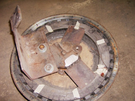

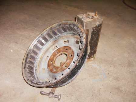

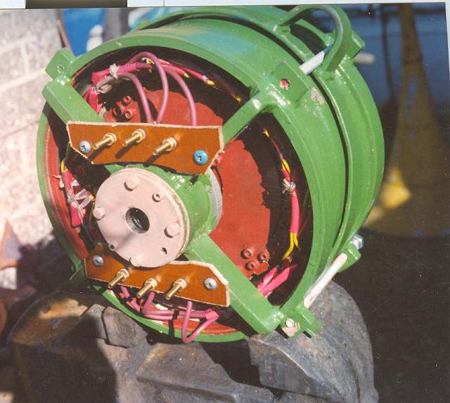

Re: 4pole radial... (3.00 / 0) (#25)
by jlt on Tue Oct 17, 2006 at 04:30:44 AM MST
these are some of my past experments. with a radial alt.i only have 2 photos of it left. it was made from a wheel from a chevy pu.i used a plywood core with some steel wire wownd on it and the coils glued to that .then i tryed it with a cast stator core made from resin and iron filings.i only had one test coil on that one.the iron core was acting like  the windings were shorted out. i could hardly turn it.worked much better with the ply wood,wire stator.it was only single phaze. i couldnt figure out three phaze at that time.i wish that i had kept it around abd tryed some neo,s on it.i think it would have made a good alt .i got info on axiel. alt,s at that time so i junked.it and went to them.
Re: 4pole radial... (3.00 / 0) (#26)
by WXYZCIENCE on Tue Oct 17, 2006 at 10:15:38 AM MST
jtl, were the magnets on that one ceramic. I have some that look the same. They may be a dual magnet, split through the center. They would have canceled each other out and been real hard to turn.
Just an idea, Joseph.
Re: 4pole radial... (3.00 / 0) (#27)
by jlt on Tue Oct 17, 2006 at 01:15:17 PM MST
no they were lowes magnets they worked fine with the plywood wire stator core. it was the other core made from iron filings . that made it hard to turn.
