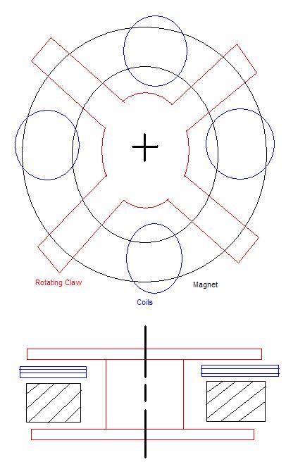

Now that you mention claw rotors, and I am not 100% sure what a unipolar claw rotor is.
I have a crazy idea, where the coils are fixed to the donut magnet, and the claw rotates in front of the coils, with the claw's center reaching inside the donut hole.
The field would change because the flux is sometime shorted around the coils.
Very simple to build, if it has any chance of working.  I do not expect much.
Crappy sketch (40K) of how I was thinking... King Tut probably had one just like it.
http://www.otherpower.com/images/scimages/2050/RotClaw.jpg
Re: Cut Into How Many Pieces 12 or 14 (3.00 / 0) (#10)
by Flux on Tue Oct 17th, 2006 at 12:29:36 PM MST
That is not the way I was thinking of doing it, but it is the same idea. In that simple form it would not be very efficient but it would work.
I was thinking about mounting the inductors on either side of the magnet ring with teeth on the outside with the coils in a small gap. You could perhaps use 12 inductors to make a 12 pole. The coils could be as a disc with claws facing or as a cylinder with claws overlapping.
