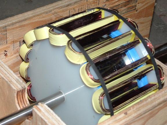

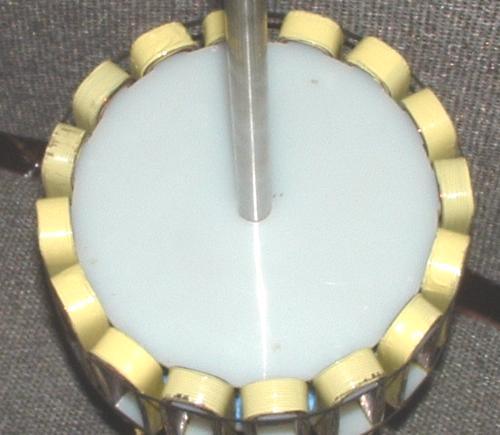

I was going to build a solid stator but after seeing Ed's work on his four pole I got to thinking. I came up with this cool idea, literally speaking. Air flowing from the rotating rotor will pass through the coils of the stator.
The coils will be vented and will also be used for the structural support of the stator. As you can see one of the draw backs to this design is the inability to easily access the rotor. The stator end plates are made of a 1/8" nylon. Here is a top view of one stator end plate. The bearings will be added to the end plates and a water tight plastic housing will cover the entire assembly.

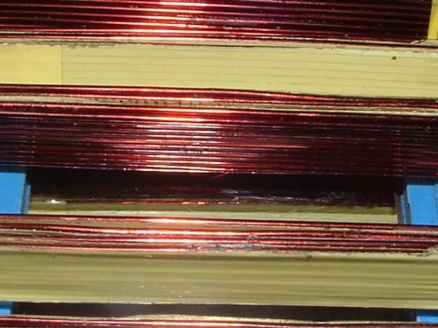

The coils were wound and glued then removed from the winder, an epoxy coating will be added to the wire too strengthen the coils.
After a few tries I used a thin mylar electrical tape between each of the coil layers. This helped me get very uniform windings. There are 42 turns of 22 gauge wire on each of the 16 coils.

  Very Nice Joseph !  How deep are those coils?  or the distance from the top of the coils to the magnets?
  I've been pondering the enclosed rotor problem and really haven't come up with any concrete solutions.  In reality, as long as the rotor is built properly, there should be no real need to remove it at any point.
  Started another one, larger - 18 poles and 54 coils.  I was so impressed by the little one I couldn't help myself.  I also remembered that winding them the way I did I needed to reverse the 2nd phase.  It worked pretty well but it works much better now.
  I found some 6 inch sch 40 pipe and made some end plates from some 1" thick nylon, 1" shaft with a key and pressed them into the pipe section.  I finished drilling the end plates today.  I plan to use an external bearing set up similar to my 500 watt kit so the plastic stator won't have to support anything but it's own torque.
  I like your design as well, is that going to be a single phase?  If I recall, you were using 16 poles on a 5 inch drum.

Ed, the coils a 1/2" in depth 4 layers of 10/11 wraps. Might be a little tall but I wanted the 42 wraps maybe 8x5 would work better, but tight. I wrapped them on my winder and made a small 1/2"x 3/8" plastic stick flat on one side and beveled on the other. Used the stick to flatten the wires after each row then taped each layer with mylar tape. Used up lots of instant CA glue. I am trying to get .04 " between the magnets and the wire.

Dan, after winding 16 coils and placing them in the stator I realized that they could have been made flatter and wedge shaped. I am going to try a wedge that will fit without the gaps between each coil. Have some other ideas also. We need a thumbnail gallery for these projects of the past. Something that can show say 24 at one time. Just a thought. Thanks for the input

If you lock all the coils together with resin and glass you could saw out the plastic from one end.  The stator would then be shaped like a drinking glass on its side with a bearing in the closed end and open on the other.
You could then support the open end from the outside rather than the inside.
