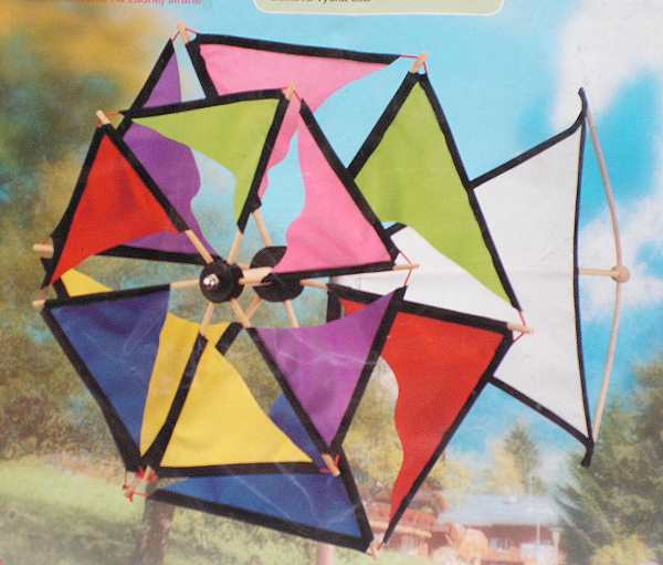

I am just posting this to see if anybody here has had any experience with a sail based turbine, as shown in the picture below. (This is just a garden ornament that cost about $10, but runs really nicely). I am interested in producing this type of turbine because I don't have the workshop equipment, nor the skills, to manufacture blades. I understand that the efficiency of this design is lower than a blade based turbine, but the important thing is cost per watt, and I presume that the sails will be really cheap to produce, and much cheaper to replace than blades.
Although thousands of these are in use all over the world, I'm having a hard time finding much actual research on them - do any of you guys know of any?

The Cretan mill as you show it is reasonably efficient when rigged properly but is slow with tsr not much over one and with a sharp peak at best tsr. You will need about 6 times speed increase over conventional blades.
The best source of information is Roger Calvert's book called wind power principles or something similar.
There was a CAT publication on a Cretan mill at one time, may still be available.
It is possible to use sail blades in a different way with a tsr of about 4. This was used by Trimble Windmills on their contra rotating design.
I think these blades ( if you can call them that) work fairly well in low wind areas but flap about and fail early in high winds. Don't forget the massive increase in tower loading.

Thanks for your info. Why would there be a massive increase in tower loading? I would have thought that if they were less efficient than blades, then (presumably) more of the wind's energy would pass through unused, so there would be less load on the tower, or am I missing something?
The garden ornament version I have is up and running, and seems to spin at high RPM, though I don't have a similar sized blade turbine to compare it to.
I was going to use the same material as yacht sails are made from (possibly even used yacht sails) so I think they should stand up quite well. If I remember correctly, yacht sails will fray along one edge as they are continuously 'whipping', but in a turbine, the sails (I presume) won't be experiencing this because they are able to move with the wind, or at least, perpendicular to it, thus mitigating the effect of 'whipping'. (This is purely conjecture on my part, I admit!)
Re: Cretan sail wind turbine - efficient or not? (3.00 / 0) (#12)
by Flux on Fri Oct 20, 2006 at 03:51:58 AM MST
The thrust on these will be similar to a solid disc, as it is for the multiblade wind pump. The thrust on a high speed rotor seems to be nearer Cp x disc loading.
You will have no furling to reduce the loading in high winds.
I have never tried these things, I would find it infinitely more difficult to make than carving blades. If you have access to yacht materials and the means to work them why not try. I always find the low tech methods difficult compared with normal methods but everyone to his own choice.

I thought that I could furl the sails by putting in a spring of some type in each of the radial spokes, so as the pressure on the sails increased, the outer rope would increase in length, which would change the shape of the sail and allow more wind through unused. Or use some kind of semi-elastic rope/material that would naturally stretch when the wind got too strong?
I was going to buy a used yacht sail for around $20 on Ebay and use that.

Flux, what did you mean by this bit: "You will need about 6 times speed increase over conventional blades."?
Re: Cretan sail wind turbine - efficient or not? (3.00 / 0) (#19)
by Flux on Sat Oct 21, 2006 at 10:46:30 AM MST
Typical blades run at tsr 6 or similar. If you run the sails with tsr 1 then you need to increase speed to the same type of alternator. It probably becomes prohibitively expensive to design alternators  for 30 rpm cut in.

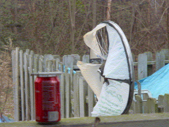

I built a couple (non- power generating) using bicycle wheels and plastic from grocery bags and from trash bags and duct tape. a 55 gallon bag cut in half fits a 26' diameter wheel pretty well(savonius bucket like). the grocery bag plastic would turn in real low winds(1 m/s or less). the 55gal. bag one (much like a 2-bucket savonius) took a little more wind(2.5 to 3 m/s-best guess). The 55gallon bag one is still working as the grocery bags degrade in sunlight pretty quickly. It is somewhat self limiting and hits max speed well before the 18mph storm winds I see in my back yard (don't get many windy days). anyway. fyi.

Thanks for that picture, excellent stuff!
I was just thinking that it would be easier for a lot of people to construct a sail based Cretan wind turbine, than to carve blades. What irks me is that so little research seems to have been done into the Cretan design - I'd like to see some published research on the effect of the number of sails, the effect of the size of the sails, how taut or loose they are, and things like that. There clearly IS the ability for large sails to capture a large amount of the energy in the wind, just look at ships throughout history, that used nothing but sails, and weighed hundreds of tons.
Some people here have mentioned that though the torque is high, the rotational speed will be slow. The same applies the bigger you make a bladed HAWT - the rotational speed slows down. So both will require gearing.

I tried to model it after a savonius that had no down side- efficiency should be better than a savonius and startup speed should be lower too. The parafoils/sails are basically a drag type foil. I never did find an optimum number of sails- the more sails the higher starting speed after three sails- basically the wind is turned at 90 degrees with four sails/foils. I would assume that three sails/foils is probably optimal (120 dgrees apart) from what I've seen of the savonius research (sandia).
