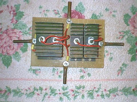

by Carl B on Sat Oct 21, 2006 at 02:12:07 PM MST
this is a bridge rectifier I Built a few years ago, to use
with my AC welder. To use the stud mount Diodes required the
use of three heat sinks, (actually one cut into three pieces)

by harrie on Sat Oct 21, 2006 at 03:28:05 PM MST
Hi carl, thanks for the picture, yours of course is single phase AC, so the three phase would require more stud rectifiers, but at least it gives one an idea how to do it. You are changing your AC welder to DC, Correct? My welder is a AC Lincoln, and I have always wanted DC.

by Carl B on Sat Oct 21, 2006 at 05:43:59 PM MST
Hi! Harrie,
   I had some critical welding to do and just threw this together from
parts I had on hand. It is pulsed DC, but it  works a lot better than AC,
since the current is going in one direction, also some capacitors
to smooth out the pulses, would help a lot.
I didn't convert the welder to dc, I just clamped the leads from the
welder to one side of the bridge, and some jumper cables to the other
Side.
   I don't use it a lot anymore, if did i would convert it, I may anyway
btw it is a lincoln 220
Carl
