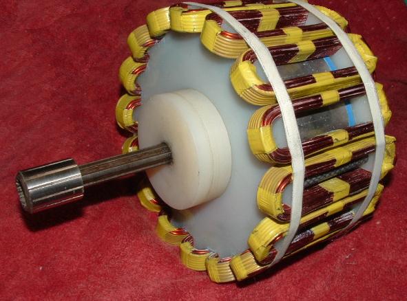

First I want to thank Ed for the combined effort to get this idea off the ground and into a workable form. Thank you Zubbly. You don't know how much a real positive comment goes to help out. Forcefield members it is an honor for me to post my work on this site. DanB your site is the best!
Sixteen days and this is the end result. Three tries, 36 coils, lots of ideas. Couple of cuts and scratches and worn out, glued together fingers.
The RACA2
The RACA2 is a single phase radial air core alternator that has met all of my expectations. Weighing in at just under seven pounds. My cost to build the unit was around sixty dollars. With two fingers a simple twist, absolutely zero cogging. The 18 coils had a last minute change 28 turns of #14 gauge magnet wire. Tests were done on my drill press at 420 rpm the open circuit voltage 13.45 volts and 26.50 volts at 900 rpm. 600 rpm under load of 5 amps the voltage holds 13 volts. At 900 under load 12.25 amps at 12.89 volts or 157watts. Now armed with the understanding learned from working on this one. To build or not to build the next one?

I have resolved the amature removal problem. I think it's important to be able to get to it.
I'm looking for material to support the windings that won't cause eddy currents and yet won't melt when things get going. I like some of the teflons mixes but they are costly.

by WXYZCIENCE on Tue Oct 24th, 2006 at 10:36:21 PM MST
Ron, I have 4 - 1/4" stiffeners made from old fiberglass tent poles between the coils holding the end plates apart. Could use more if the coils weren't so stiff. The coils touch and are wound one forward then one reversed around the perimeter. The magnets are 1/2" wide with 1/2" space between them.

by WXYZCIENCE on Wed Oct 25th, 2006 at 10:51:44 AM MST
tecker, yes I tried that and got a 10% increase in the output power. The vibration in the unit also increases so I don't know how much it added at what cost. The unit does need a cover if it is going to be use in an outdoor application.

Re: RACA Completed (3.00 / 0) (#16)
by WXYZCIENCE on Wed Oct 25th, 2006 at 09:43:58 PM MST
