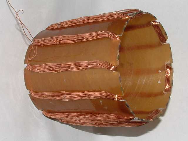

Can radial have a place in the Air Core
I was experimenting with this radial winding design. Has anyone ever tried this type of air core for a radial design?
I was getting 11volts from this wave test wind with a twelve pole magnet stator. I also skewed the winding which only reduced the output. The air gap was large, so closer air gap would improve the output. This is one phase, typically other configuration could be suggested. Any comments welcome.

What's the size of the tube?
And what's the mag rotor size, shape etc?

stephent, the tube is 4" in diameter and 6" in length made from fiberglass. The wire was stripped from an old transformer (#24 ?) The stator was from my motor conversion pictured here.

Should work as well as any single mag plate without laminates.
And it could be easy to put some laminates into the picture too.
Only thing I see could be that the wire ends sticking into the center could limit the air gap a bit (clearance with rotor going into the stator at assembly).
Couple of tabs to wind one end of the coils around instead of the loop inside could fix that....it has possibilities.

stephent, the rotor (that I have been calling the stator) easily cleared the wires on the ends. I figured, coils could be wound on a form and the fixed to the tube and cast in place. This would allow for less airspace.

Why did you skew the windings?
The copper windings don't attract the magnetic flux, so they have zero affect on cogging.  Cogging is caused by the magnets 'sticking' more to the iron backing in some portions of the rotation than others.
Did you use any iron backing on the outside of the stator windings to attract flux?  That would greatly help voltage output if you did that.
What material is the coil holder made out of?

I almost forgot.  What RPM did you get the 11 volts at?

Countryboy, the tube is made from fiberglass. I skewed the wires just to see what would happen. You are right about the zero cogging. There was lots of coil vibration because the coils were not held tight. I tested the unit at 600 rpms.

Yes of course you can make any radial form of the axial machine.
Axial construction is simpler for those with no machining facilities. If you have the facilities to control the air gap the radial has some advantages. The winding is constant width and it is easy to use the overlapped coil method without running out of space at the centre.
In the simple form that you have tried, it is wasteful of material just in the same way as the single rotor axial. You can make it dual rotor by having another drum of magnets outside. It then becomes a bit of a challenge to support the stator but it can be done.
You can keep the magnet drum on the outside and use laminates to wind your coils on. It then becomes the equivalent of the single rotor with laminated core but has the big advantage that cores are readily obtainable. Just use motor cores and ignore the teeth on the inside. Unlike its axial equivalent this form does not suffer from the large magnetic attraction force loading the bearings.

Flux, removing the weight was one of my reasons for thinking of this design. I could maintain the twelve pole design and simply increase the length, in this was use more, smaller less expensive magnets. Cooling would then be relative to the surface area of the external stator. This would also help counter inadequate magnet thickness.
The tube can be made without machining by wrapping cardboard around the rotor to the desired thickness, then glass cloth and resin.

It probably does have iron but no slots. It is probably similar to Hugh's brake drum alternator.
If you make it without iron then it becomes much more difficult to cool and uses more magnets.
With a laminated iron core with no slots the iron loss is low, cogging non existent, construction is much easier than a self supporting ironless stator and cooling is very much better directly on to the iron core.
