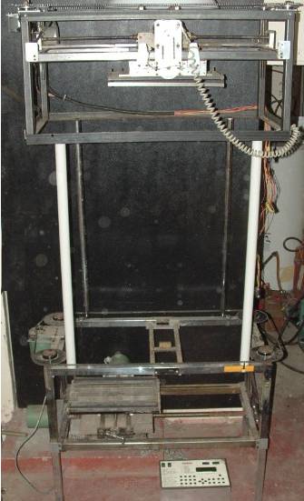

Four Foot, Four Axis
After all the comments on my last post and the successful test cuts, we put together this four axis wing cutter. The new machine is two of our older machines combined together to allow the three dimensional cut too be done in a single pass. The first machine is programmed with the profile and the size. The second machine is the slave and is controlled by the first machine and is programmed with the wing tip profile. The angle of the second profile can be shifted up to ninety degrees.

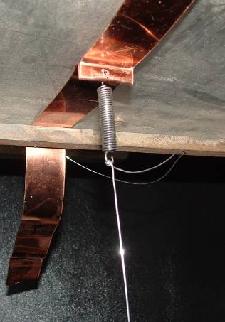

The new cutter will be able to cut fifty inches of foam. We have also implemented a spring into the cutter wire to adjust the change in the wires length, due to thermal expansion and angular length difference. The cutter is now using a stainless steel wire. I have a hundred foot roll of stainless wire feed welder wire.

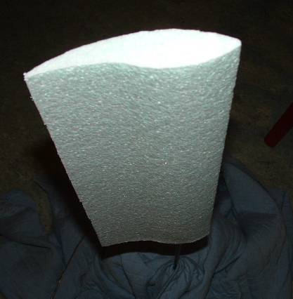

The first test was twenty four inch, high lift profile. We will be trying some different lengths and tapers this week.
We will try a forty eight inch cut with the good material once the pattern and the test cuts work well. Also the cut is very smooth over the entire length. This produced an excellent internal mold.

I have also built one foam cutter and have tried to cut a few using it.  The result was quite good.  You can see it at http://www.fieldlines.com/story/2006/2/28/1551/54276
However, I faced a problem with wire becoming too hot and melted the foam when cutting the curve.  Do you have anything to control the temp of the wire?  Do you have this problem?

Wachara, looked at your post. Very impressive. On my cutter the temperature is controled by a light dimmer and stepdown transformer. Four feet of the nichrome wire required about 30v ac to melt the foam properly. I cut slowly so the wire temperature can be set very low. Also the temperature can be reduced in tight radial cuts. Thanks for your input.

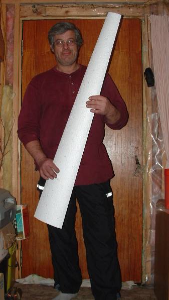

Re:First 4' Blade (3.00 / 0) (#8)
by WXYZCIENCE on Tue Nov 14th, 2006 at 02:03:00 AM MST
Spent most of the day working on the fume hood and foam mounting clamps. Bill programmed the controllers with the two cuts. He had to tweak the timing to obtain accurate synchronization. Changes to the cutter included a thinner nichrome wire and the transformer was up-sized to a twenty five volt 5 amp type. The first blade took less than two minutes to cut.
A very smooth cut. The root cord length is 7" and the tips cord length is 3". This wing has no twist though.
I need to read a little more on the twist angles that will work for this type of wing and others. Any suggestions would be welcome.
The outside mold from this cut came out excellently and I will be testing the mold idea this week and posting the results.
