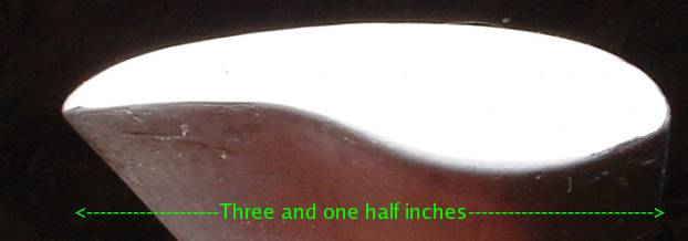

At this point I am waiting for the liquid to start pouring out everywhere. Nothing leaking, it is holding. Now the long wait, the unbelievably long wait. My test blob is starting to set up and I am almost starting to think this will work. I have worked with resin lots in the past and some how did not take into account the heat! The foam is an insulator. It's hot...too hot! I quickly grab the standing mold and place it up on the bench. With a couple of strokes my trusty knife peels away the outer foam form. This is what pops out.

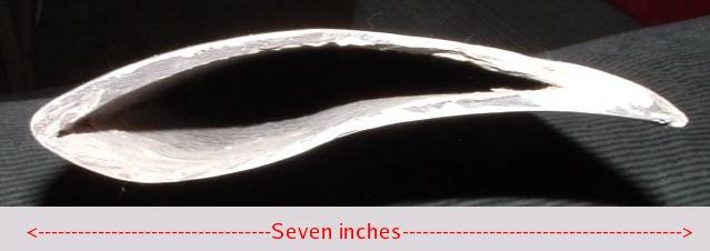

Cool and then removed the outer bag. Nice wing, just a few worm lines. I pick it up and can hear a rattle from inside it. From inside of the new fiberglass wing I find Blue, he's shriveled and not much left...but he did his job well! Here is a profile of the root end
And last the profile of the tip end.
The new wing weighs three pounds.

But, I really don't understand Joe. Did I miss a post or something? How did you end up with what looks like about a 1/4" thick skin from a layer of "boat cloth". What exactly is "boat cloth"?
"4. Placed the wing/bag/glass/bag inside of the mold."
Where did the mold come from? Did I miss this? Is this the negative blank left over from cutting the core?
"5. Added a measured amount of polyester resin to the wing/bag/glass/bag/mold."
Where exactly is the resin applied? Obviously, it needs to saturate the cloth, but how did you do this when it's already bagged? How did you calculate the "measured amount"?
Joe, it's clear I don't really understand your process, but I would like to. With that thick skin, you may get away without a spar.
One reason I wouldn't really consider polyester resin is because it's fairly brittle and don't think it will stand up to the bending loads.

SamoaPower, I would think about a different material if the length was over 48". The gel coat that was used to cover the wing adds the uv protection and color. Thinking of using a type of rubber mount for the hub attachment. I am going to try again later this week to see if the next two blades are as successful. I also posted an addendum in my diary with a few more pictures.

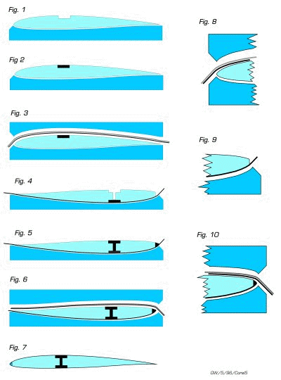

Here's a similar system for glassing one side at a time so a spar can be built in. The spar is essentially a fibre composite i-beam that connects with both sides of the blade; made from rolled up strips of glass...epoxied.
