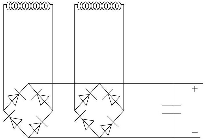

so i have done a little more reasearch and found that stepper motor will require 2 full wave rectifiers, connected in parrallel. with the drive motor found 2 different setups:
1 being a 3phase star formation with 2 leads going to 1 full wave rectifier and the other lone lead to its own rectifier.
other being a 3 phase star formation with each lead split going to both sides of its own rectifier. once again all 3 rectifiers connected in parallel.
also had the option of delta, but felt a larger voltage is needed. since deltas are lower voltage, but highercurrent, we chose the star formation.
I think from looking into it, the stepper motor is the more obvious choice,as it is almost guaranteed to work.  I was wondering though if the wiring of the 3 phase drive motor would be a complete waste of time, because of little to no voltage created.  And if a recordable amount of voltage is obtained, could both motors possibly be connected further in parallel???
ill try and sketch what i mean by this
and i know what you mean about not getting feedback, but dont worry, ill keep you posted on our findings....ohh and by the way, ive only taken physics 1 so didnt really learn about diodes or AC to DC conversion,it was more of a catchup class from h.s. physics. thats y i thought i would ask.
And by asking, i feel ill be much ahead when we are actually taught this stuff next semester.

The (most) steppers will give plenty of voltage. No worry about the rectifier losses.
The drive motor will probably have a VERY tough time getting to 3V peak for the Piezo.
Delta voltage will be about 60% of star voltage.
The rectifiers will use up 1.4V of the output. Thats about half of star V, and nearly all of delta V, if it can even get to 3V before the rectifier.
I don't see any need to use both motors with one blade set.  The stepper will do it.
I very rarely get a drive motor up to 3V, it will cause additional iron losses, mounting 2 together would be a bugger to align (for me), etc.

anyways, we are going to test the platter motor tomorrow with the full wave bridge rectifiers that we purchased today.  Today, we tested with the stepper motor.
when hooked up to the 2 rectifiers, we were able to record a voltage of around 4V.  When connecting directly to our piezo buzzer, electrical noise(pulsed DC???) was noticable.  Our piezo buzzer runs from 3 -20V DC. now we were trying to figure out how to increase voltage, while "smoothing at the same time. obviously a capacitor would be used, but were unsure of an optimal rating and/or proper utilization in the circuit.  I suggested simply a capacitor between DC leads, such as the schematic i drew below.
any  feedback would be appreciated,

"Since 3 of the leads are all soldered at one point, and there are 3 leads that are seperate, hence a star formation.
would there be some sort of rectifictation taking place inside the circuitry of the chipboard??"
There is a difference between feeding something 3-ph, and something making 3-ph.
I never saw a reasonably modern floppy that was not 3-ph star.
The platten motor will do a bit better if the bridges are built from Schottky diodes.
"increase voltage, while "smoothing at the same time"
That will make it not as loud.  Not nearly as loud.
The Piezo uses very little amps, I hope. A voltage increase will decrease amps. Total watts (power) will be less (losses from increasing V), and the Piezo will not be as loud.
The cap is a good idea.
Is there an Army green rectangle cap a bit larger than an M&M in there? That's the one I'd try first. 2 or 3 is better.  The blue ones are OK too.  More is usually better for something like this.
Wind power, with close to the right blades, is fast. Pulsing is related to RPM. The pulsing should be minor with a bit of cap.
A 100 ohm resistor between the cap and Piezo will help reduce the pulsing without too much reduction in volume, and the perceived volume may even rise.
Is this a 5 wire stepper?  The voltage seems VERY low, even for a 5 wire stepper connected improperly.
How many wires does the stepper have?
 (sometimes the output at a higher voltage will go down if not connected properly)
How many ma is the Piezo rated?
From what you have specifically told us about what you have to work with (not much, BTW), I would make 2 bridges with Schottky diodes, each bridge separately feeding a seprate cap and Piezo. Meaning 2 separate circuits fed from separate phases of the alternator.
The `noise' will be louder and smoother.
