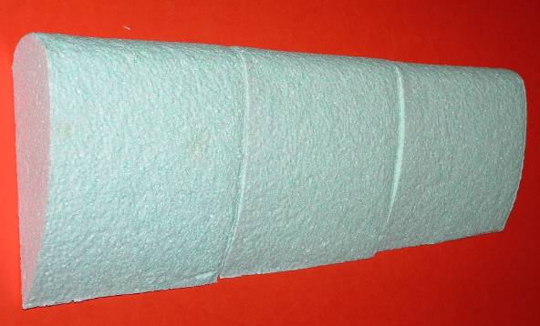

I have been watching several others on this site building foam wings.
Good idea, so adding a foam cutter to my xyz machine seemed feasible.

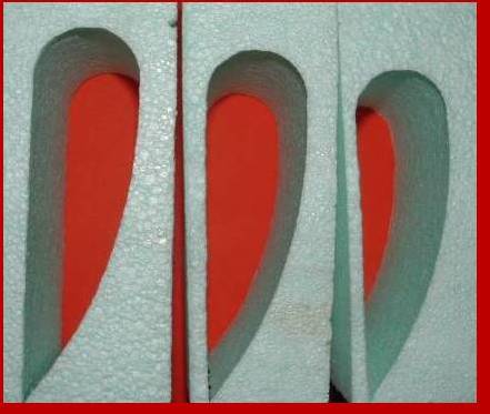

Three 4412 test cuts produced this wing. My cord length is 6".
The cutter allows me to obtain both inside and outside forms.
The reduction of 5% in each cut makes the profile fit together well.
I am trying to produce a plug and a mold.
These blocks will be used for the mold experiment.

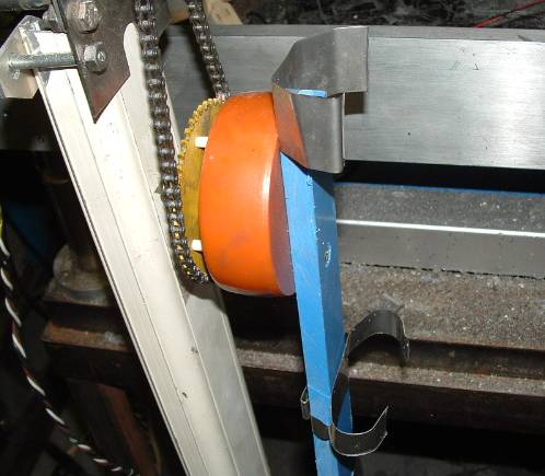

The next picture is the foam clamp with a taper/twist control drive.
The resolution allows me to get 4 divisions per degree.

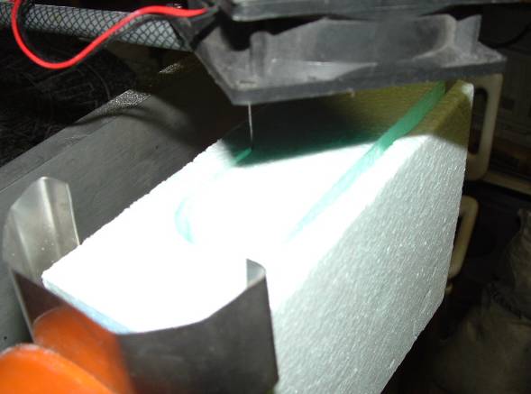

The last picture is of the cutter in action. A small fan removes the fumes from the cut and they are vented to the attic. The 22 gauge nichrome wire is controlled by a light dimmer on the primary of a 120volt transformer. The secondary, 12 volts can be set just right to cut at the correct speed.
The cutter worked very well.

Neat machine Joe. It would sure be nice if you could cut the whole blade length in one swipe but I can see the limitations.
Please don't depend on THAT profile being a NACA 4412. The 4412 is quite different.
Re: Cutting a Foam 4412 Profile (3.00 / 0) (#3)
by WXYZCIENCE on Tue Nov 7th, 2006 at 10:35:22 AM MST
SamoaPower, yes the profile is slightly modified to be the root section. The test wing will be 48". I will switch to the 4412 next and will add the twist through too the end. Any suggestions of other profiles would be wonderful. It only takes a minute to re-program the cutter. I will be trying out a twisted section later today. Thanks for the input.

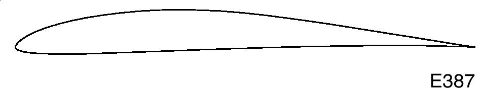

Don't be afraid to use linear taper and twist in place of the progressive types out of some of the blade calculators. It only costs you a few percent in performance. Linear twist and taper can be cut with a hot wire cutter, of course.
For other possible tested airfoils you may want to take a look at:
http://www.ae.uiuc.edu/m-selig/uiuc_lsat/vol4/NREL-SR-500-34515.pdf
They tested at low Reynolds numbers which is what we need for wind turbines.
Re: Cutting a Foam 4412 Profile (3.00 / 0) (#12)
by WXYZCIENCE on Wed Nov 8th, 2006 at 01:12:40 AM MST
SamoaPower, thanks for the pdf link. There is a lot of technical data but I gleaned a profile and some info on it's performance.
I will give this one a try for the last 3 or 4 section of the wing.
Joseph.

by SamoaPower on Wed Nov 8th, 2006 at 08:40:09 AM MST
Fine Joe. The only problem I see with the E387 is that being a thin section, it doesn't have a lot of room for the spar system.
You'll need some of the data from the drag polars to design the blade. You need the CL (Lift Coefficient) at best L/D and the Angle of Attack at that CL. The L/D will be the primary factor determining blade efficiency.
I'm using something very similar to the SH3055 on my 16' rotor.

"Another idea would incorporate a circular moving nichrome cutter. Like a band saw. This way temperature over the length of the nichrome would be constant."
Maybe, but if there's much length of wire on the "infeeding" side, the wire will pre-heat and be hotter on this side.  The only reason I can see for the vertical unveness is convection carrying cool air up through the bottom of the cut.
I wonder: For twist could you pre-twist the bulk foam and cut it while twisted?
Re: Cutting a Foam 4412 Profile (3.00 / 0) (#8)
by WXYZCIENCE on Tue Nov 7th, 2006 at 05:24:38 PM MST
RP, I believe you are correct in the understanding of the convection causing the underside to be hotter than the top. My cutter wire is 8" and by moving the foam lower there is less taper. This is a desirable outcome because the profile tapers fit together very well. The underside melt can be made 1/8 wider than the top.
Joseph.

by DanG on Tue Nov 7th, 2006 at 02:37:06 PM MST
How about columnar forced air or even a gravity dropped coolant flow - just enough to keep melt film collateral damage down. The oscillating wire idea is good but the melt film still will collapse anything it touches until it cools...

by willib (willibur at comcast dot net) on Tue Nov 7th, 2006 at 08:21:40 PM MST
Hi Joseph ,
if you could regulate the current better i think you could cut it more accurately
did you try turning down the current?
my stainless wire (0.01)dia , starts cutting at a tad over 1/2 amp , but i usually cut the foam at 3/4 of an amp.
Carpe Ventum (seize the wind)
Re: Cutting a Foam 4412 Profile (3.00 / 0) (#11)
by WXYZCIENCE on Wed Nov 8th, 2006 at 12:58:23 AM MST
Willib, I have a bunch of stainless wire and will give it a try. The nichrome came from an old hotel ice maker fairly heavy gauge.
Joseph
