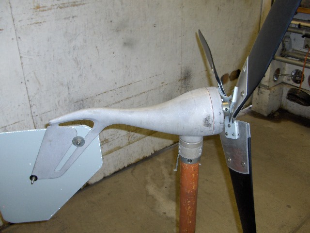

Heres a few pictures.
I hope to wind test it sunday? we'll see how it compairs to the stock version.

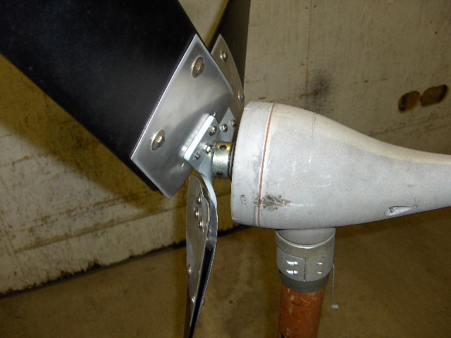

This is back side of blade hub

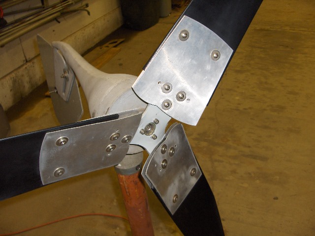

front of blade hub.

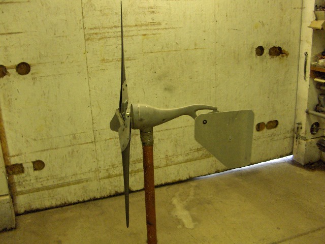

away shot
I added a larger tail. The small tail wouldn't offer much direction control.
I'll be testing this 48 volt genny at 24 volts.

Re: SW-403 mods underway. (3.00 / 0) (#2)
by tecker on Fri Dec 15th, 2006 at 03:24:30 AM MST
You know I 've always thought that pvc would make a good core for laminate fiberglass
I'll do a tsr one with a buildup on the root for more lift and fiberglass for stress and weather proofing .And one set with   Aluminum flashing bonded to instead of fiberglass  . That's the only issue with Pvc that the UV gets to it as a core It's head and sholders above any other core for shaping .I like this mod I know it's going to make more power.

Re: SW-403 mods underway. (3.00 / 0) (#4)
by Jerry on Mon Dec 18th, 2006 at 10:25:15 PM MST
Hi Lawrence.
My 403 is a 48 volt unit. Because my blades are desinged for much more tourque and lower rpm I will now be useing this 48 volt genny for 24 volt charging.
Its worthless at 48 volts. However if I use it with the original blades it will act as though it is just shorted out. My blades will have enough tourque to overcome this sudo short condition.
