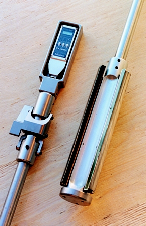

I don't have any pictures at home of some of the parts we 've run at work but I grabbed this image from the National Oilwell site.
I've programmed and run the indicator head (housing the digital meter) and the couplings on Either side of the activator as well as the activating levers on either side of the lower coupling on the assembly to the left. The activating levers are .225 thick and 1.01 long. Fairly basic shapes but challenging never the less. We send them out uncoated and National has them plated to make 'em all shiny.
