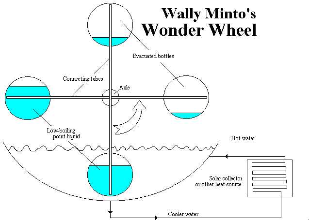

The 'correct charge' will be a liquid amount that can be contained in less than 50% of the volume of one tank.  (Any more than 50% will run back down the tube to the empty tank.)  It isn't necessary to have equal amounts of ammonia in each canister pair, as each canister pair is a separate system isolated from the others.
You don't want air in the system, but you won't have to use a vacuum pump to remove the air.  The ammonia or freon you use will vaporize easily - as long as you have a relief valve opened, you can use the ammonia or freon to 'blow' the air out.  Then, close the relief valve, and fill.
This diagram shows some bad information.
The evacuated tanks should be at the bottom of the picture, not the top.  The full tanks should be at the top of the picture.
Please note that the tube between the tanks does not stop at the edge of the tank.  The tube extends into each tank.  This makes a valve.  The hot gas goes up the tube to the upper tank, and condenses in the bottom of the upper tank, but is unable to run back down the tube because the tube is higher than the level of liquid.  If you fail to make this valve, you will need the vapor flow to constantly 'blow' the liquid to keep it in the upper tank, which you will find to be very difficult.
