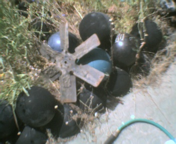

i use old fan blades from trucks.
this one is off a 71 corn binder.
aready curved !
kind of a drag grinding the rivets.
just bolt it to gether.
