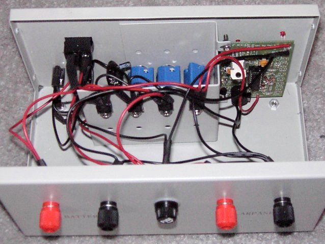

Re: question about solar panel pricing (3.00 / 0) (#17)
by zap on Thu Feb 09, 2006 at 10:08:32 AM MST
Hiya G, here's a little info on that controller. Not sure about the "little yellow one", this one is grey : )
A shot of the guts.
The brains appear to be a Texas Instruments CD4069UBE chip. Just an FYI!
zap
Re: question about solar panel pricing (3.00 / 0) (#19)
by ghurd on Thu Feb 09, 2006 at 10:33:11 AM MST
Never saw that one before!
The commonly supplied little yellow charge controller 'ICP'-roblems with quite often.
