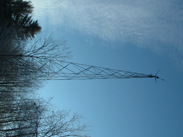

 fanman here,yes i built a tower for my first jacobs wind machine back in 1997, it was a three legged, free standing tower with a 20' footprint the legs were made from 3" oil well casings, the kind they drill with. and about 95 20'sticks of 2x2x1/8" angle irons, i designed and built it on the ground, and hinged to of the legs to my anchors that were buried in the ground then i had a crane service com stand it for me with the jake machine on top, that was an awsome day, that crane just picked it up like it was nothing. and my blade box works real well, it only does the face of the blade but it does a great job, the blades in my pictures are only 8' long and they are 8" wide at the root and tapered from 5 degrees at the tip to 10 degrees at the root the blades are only 1 1/2" thick so the root isnt real deep, ive made several sets for jakes in the past, out of spruce, pine, redwood,cedar, and they all work fine, the pine tend to warp if not real dry.

Re: high voltage axial flux (3.00 / 0) (#12)
by SmoggyTurnip on Fri Feb 10, 2006 at 07:50:49 AM MST
That tower sounds increadible - do you have any pics of it?

Re: high voltage axial flux (3.00 / 0) (#19)
by fanman on Sat Feb 11, 2006 at 10:08:43 AM MST
hey smoggy

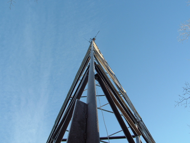

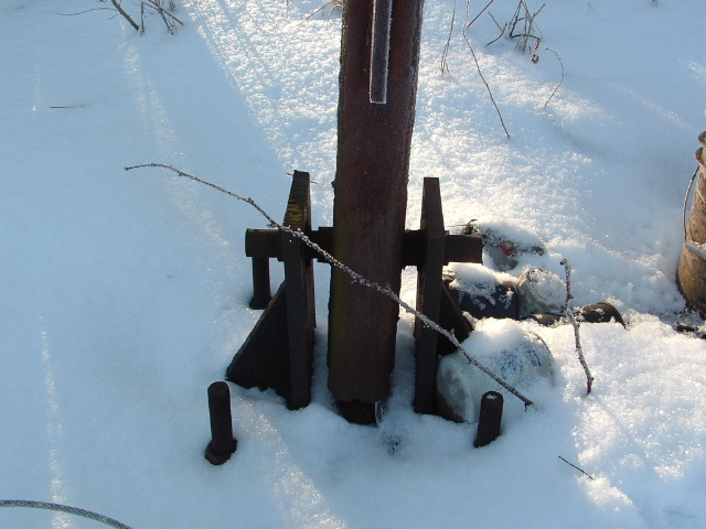

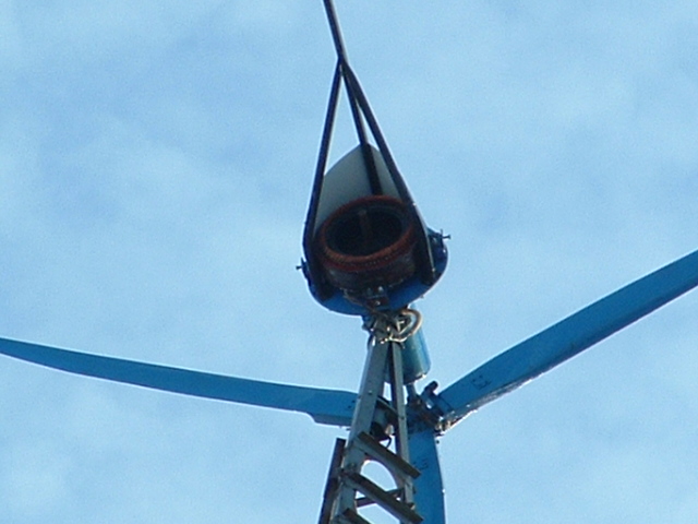

 i rounded up some pictures this morning for on my tower set up, like i said its 158' to the top of the generater, the gen that is up there is a homemade jobby, tis a combination of a jacobs blade activated governer and a permanemt mag radial flux generater, the magnets were ceramic 8 mostly because of cost, they do work good but the flux is minimal of course, and the blades are to heavy for the springs so it furls before it should, i get 20 amps quite easily from it, then it furls

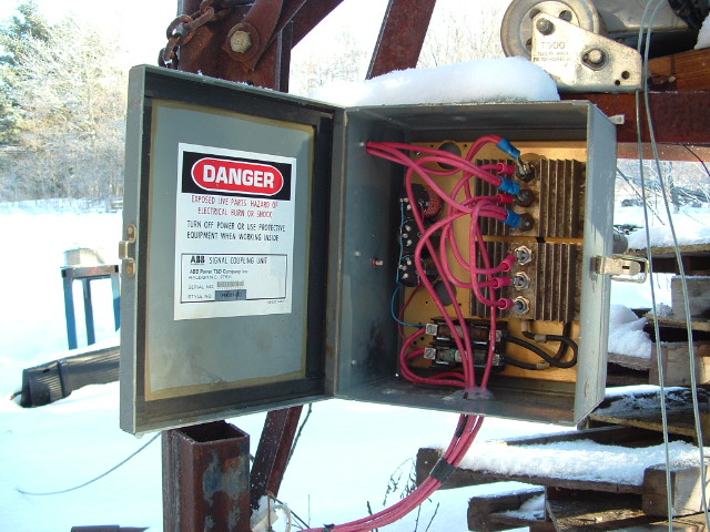

i keep all the diodes at the bottom of the tower for ease of replacing them, you know when mother nature calls, and she does strike here quite often, and i have a couple capaciters in there to smooth out the waveform a bit
i built the tower on the ground and hinged two of the legs to the anchor so i could have it hoisted into place and it worked great, a crane picked it up and stood it easily
heres a shot looking up one of the legs of the tower, its pretty cool thing to up like that it almost makes ya dizzy,

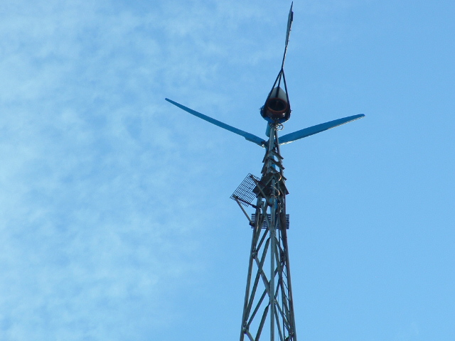

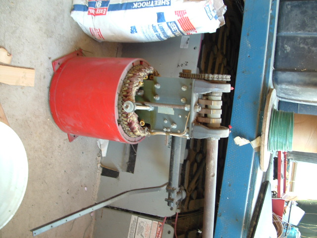

theres a close up of the gen, you can see the stater in the back there, its 24 pole as well, i used half of a stack of lams from a 65hp electric motor for the stater about 4" thick 12"inside dia.
this picture is the whirlwind gen i have in the shop, ive heard alot of good about this machine, the furling does look like it wouldnt be acceptable, i thought that i would do the offset tail methode to it,

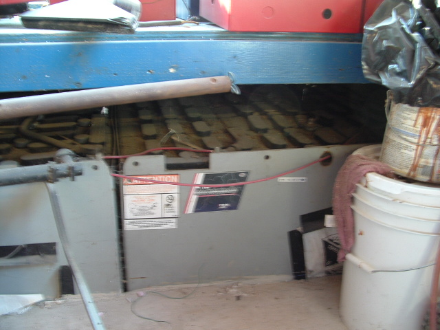

and there is one of my batteries i charge, they are 36 volt forklift batteries i got from a gm plant in texas, i split the cells up and rewired them for 120 volts boy they are used but very good shape yet, well there ya go smoogy i have more updates coming, im building the blades for my axial flux right now.
