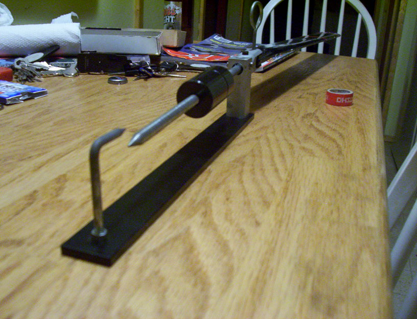

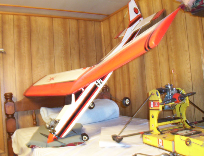

below is a wing balancer for those hobby model airplanes use..i am speaking of those ones that fly, they are real cool...i happened to see one guys setup, and among other things, they use this device above for balanciing their wings..in a nutshell, they attach a wing at the end nearest my hand..their is a threaded rod that has some threaded weight in the center..at the far end the threaded rod goes to a point, you turn the threaded rod until its point aligns with a fixed point on this jig...once you have one set up, youcan then put another wing on and add, or remove weight until all are exactly the same....i found many similarities in this model airplane flying and what we do here with wind turbines..among them the fact that we also balance out blades...i took these pictures to illustrate what might be possible in our blade building....otherthings not shown that are done include using edge tape, and there is a clear palstic film that when heated shrink wraps around their blades..it can be purchased at any hobby shop i am told..i thought maybe it might be something to look into as it may save our blades from damage and decay from the weather etc....this picture was added to again check my picture size before i start my huge post on how i built my 17' turbine...this picture is 312x400 something..pickster

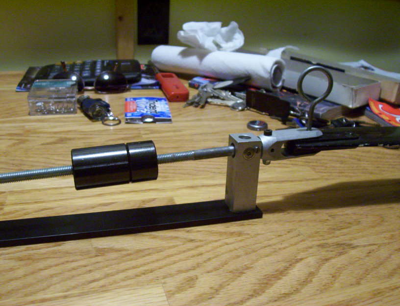

here is another view of the blade/wing balancer...when the two points align..the blade is balanced..i thought it may be something we could incoorporate in to our design for balancing the blades exactly and with less time and effort

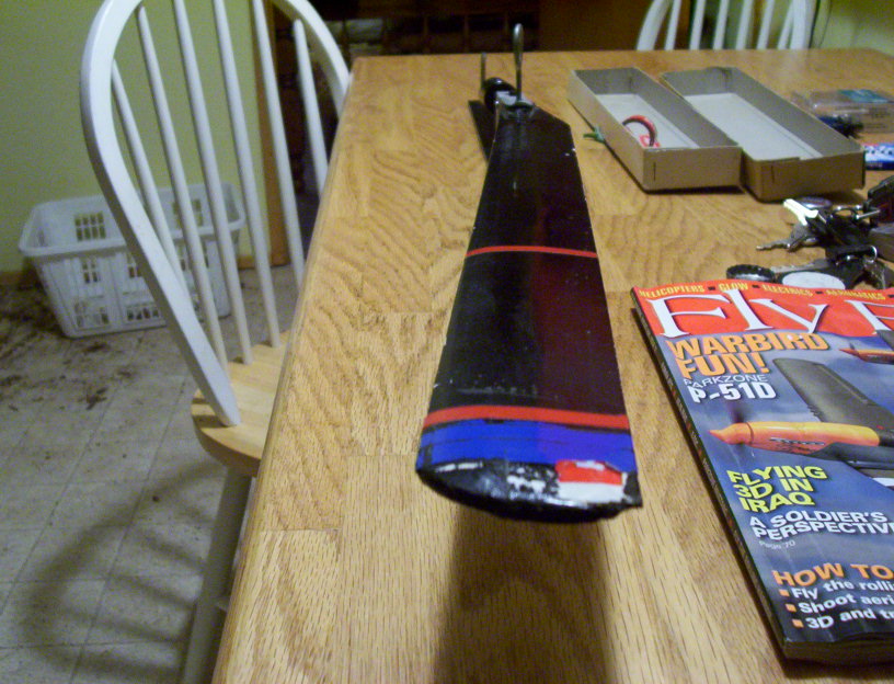

wings of this model plane are encased in heat shrink wrap that can be purchased at any hobby store..i have heard its expensive, but if it would help to increase our blade life..it might be something worth looking into
these model airplanes are on a smaller scale than what we do obviously, but their are many similarities in their approach..these guys use tape, or very small weights to get all the wings to be the exact same weight and balanced ..likewise we try and get our blades balanced to ensure a quiet running machine that will run efficently inlow winds or even higher winds...balance is important so the blades wont disintigrate in high winds also..just more pictures to get me up to speed for my 17'

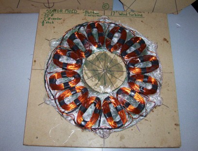

below is a photo of 20" stator ready for fiberglass

i will see tomorrow if the stator came out o.k.  i didnt want the stator to cure too quickly so i didnt put too much hardener in it, so after 2 hours, it isnt ready yet..i will have to wait until tomorrow to see how it came out..these photos were just to test picture size again..these are about 300x400 pixels

hi picmacmillan. looks like your comming right along, hey did you catch the post by DanB, where he said he hopes you didnt wind the coils with 70 turns of One in hand #15, cause your resistance will be way to high! I cant tell in the picture if it is one, or two in hand?? anyway, good luck and send some wind down here to Mn, but not the cold kind.

ya harrie thanks...i am winding with 2 in hand..just forgot to mention it?..i blieeve i have the right amount of windings..2strtands - 69 turns #15 per coil..12 coils..for anyone who may build a 17' stator like this..i found that you need 1 foot of wire for every turn you are going to use..(x2 srands..so 2 pieces of wire 69 feet long in each coil..actuall numbe is 68 feet x 2, but 1 extra foot doesnt hurt and you can cut it out later if need be..... thanks for looking out for me though..sometimes i do make mistakes and they are usually costly :)..pickster
