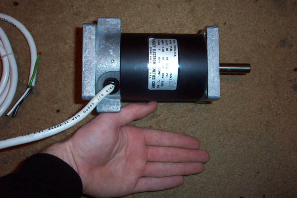

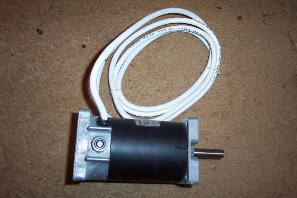

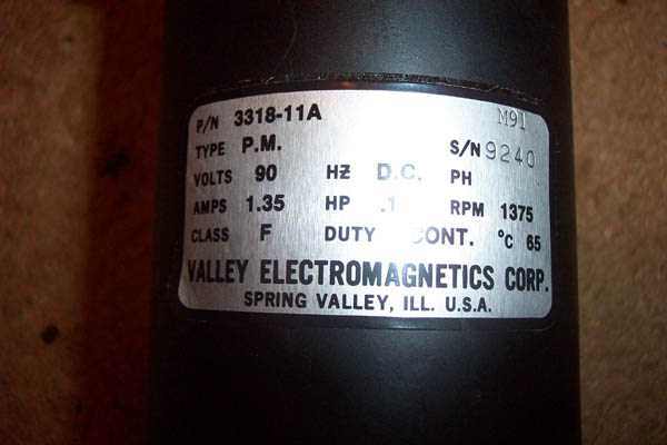

Good question iFred,
I have just bought a 90V DC PM motor (rated at 1300rpm so I think it should be fine to charge 12V - similar to the Ametek motors?). Nice screw-ported brushes so they'd be easy to change but what about the bearings?
I notice most folk using the Ametek PM tape drive motors seem to go for directly mounted blades. How long do those bearings tend to hold outat they are presumably not designed for the thrust comming down the rotor shaft?
Cheers, Steve

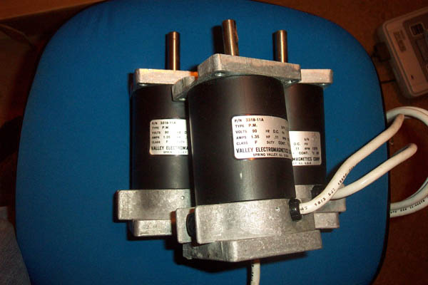

Hi stevesteve I think i have three of the same motors as you.  I too got them of eBay and will hopefully be using them soon, if im correct i think they have a thread internal shaft, im think to make some zubwoffs and bolt them on.  Could you let me know about your ideas for making as i am in the same boat, thanks
Jon M www.otherpower.co.uk
