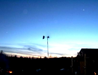

Hello,
A couple weeks ago I posted some photos of my new turbine (http://www.fieldlines.com/story/2006/4/6/4465/08215).  After two weeks of waiting today we had a nice blow, including a hail storm and associated wind squall.  At one point I think the wind may have hit 30mph.  It's hard to tell but I think my turbine was up around 150rpm.  For two weeks I've been watching the blades slowly turn in 5mph wind.  This was the first time I've seen it reach cut-in speed (24V).
I have to admit disappointment.  My ammeter was showing only about ½ amp at 24V.  That would be all of 12 watts from an 8.2' foot diameter machine (dual rotor 24 magnets, 9 coils, 3-phase star) in a 20mph wind.  I think something must not be right.
Back when I first built the stator (http://www.atm-international.com/RenewableEnergy/Wind/axial_flux_alternator_project1.htm) DanB told me I used too many turns (90 turns) in the coils.  Dan suggested the blades would not be turning fast enough at cut-in and would be stalled.  So what to do now?  In the long term I may make a new stator and also increase blade diameter to 9 feet (from 8.2').  I'm wondering if two short-term steps might also help to increase charging current.
  1.     Change the stator from Star to Delta.  I can do that because the coil connections are outside the mold.
  2.     Increase the air gap.
I'm thinking the above two steps would increase RPM and thus blade efficiency and hopefully charging current.  Can anyone comment on this?
Also, as can be seen in the posted photos the turbine mast is secured to the side of my house.  I was almost forced to take the turbine down after just one night of variable winds.  Every time the turbine rotated to a new azimuth a loud metal against metal screeching sound reverberated through my house.  Happily I was able to completely eliminate that problem.  I happened to have some 1/8 thick Teflon sheets.  I cut a circular piece just large enough to fit inside the turbine chassis sleeve.  The Teflon pad is on the top of the mast and now when the turbine azimuth wants to change the turbine rotates on the Teflon pad.  No more metal against metal scraping.  For good measure I added some grease inside the sleeve as well.  Now the machine rotates smoothly and soundlessly.
Rob

Hi Rob,
your blades are not right  , i tried to tell you before .
you have a real nice machine there everything looks ok , except  your blades .
they cant possibly produce any amount of power.
i would suggest before doing anything drastic to the machine itself , that you look into blade design..
Take a look at Dan's blades for his 17 footer . or any of his blades for his newer machines .
thats my suggestion.

I can't find enough data on the blades to form an opinion. The original 8 bladed thing would have been useless but I assumed that the 3 blade version was based on Dan's blades. I have never used and would never consider using laminated plywood but if it is made to the right shape it should work.
Perhaps in view of the poor performance some details of the blades would help Rob.

You say you got 38v at 250 rpm on test, I assume this was ac volts between a pair of leads.
It agrees quite well with my calculated figure for cut in of 118 rpm, assuming the stator is about 1/2" thick.
This is too slow and it seems likely that delta will bring it up to a better figure.
Alternatively a fair size increase in air gap should bring the speed up.
If delta works, you may find Jerry rig is even better as far as efficiency goes.
I have no real doubt that your problem is the wind or the lack of it. There is no chance of output with wind from or towards the trees. I have no idea what things are like when it blows up or down the road. It is all too easy to have a lot of violent squalls in such places without having any serious energy at all. If you got 1/2 A with it stalled, you may get 3 times that when you raise the cut in speed.
Unless you have better wind prospects in other directions, you will never get very much and increasing the air gap may be as good an option as connecting to delta but you have both options to try.

It is my considered opinion that you need far more chord width at the root. Plug your data into either warlocks or alton-moores blade calculators.  For an ideal (mathematically) blade ,the root chord should be about 5 or 6 times the tip chord width. In the real world, this is rarely achievable.
In your location, a chainsaw taken to those trees behind the house would probably advance your cause, but may not be politically correct.

from what i can see, i think your biggest problem is all the trees.
 let me tell you about my genny.  its a 1.5hp conversion with a 8 foot 3 blade prop, mounted on a 30 foot tv tower with about 6 feet of mast pipe sticking out. i have 2 large trees and the house to contend with. the only time it runs good is when the wind is from the south west. it gets a clear stream of wind then and is pretty steady.
when the wind is from any other direction, it is constantly yawing all over the place trying to align itself with the wind. the trees and house just plainly cause the wind to be erratic, and it rarely gets going fast enough to even hit charging volts.
the other day we had a good wind from the south west, and was getting 42 amp peaks into a 24 volt batt bank, and was averaging about 25 amp. i have seen it hit just over 70 amp in a wind storm.
basically, your genny is only going to perform as good as the quality of the wind. you look like you have a great genny there and unfortunately i think your only options are going to be to move it to a new location or just plainly get it up above the tree height.
