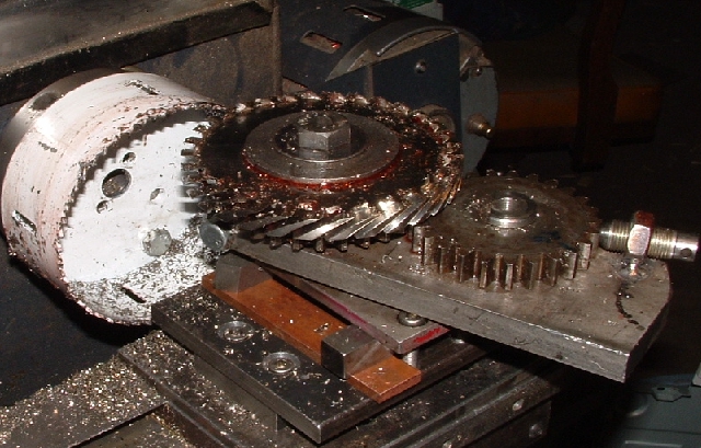

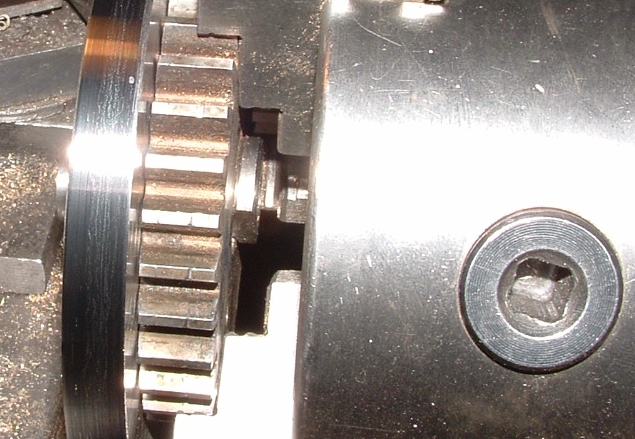

The blank is 1/2" SS 306 pictured here being machined.
The first cuts are alternated to produce more accurate balance. Cutting speed is 400 rpm.

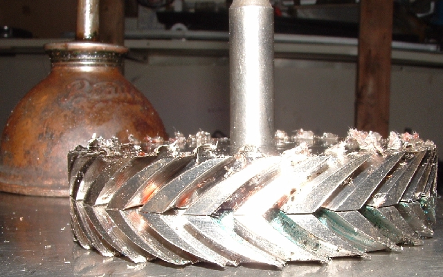

This next picture shows the first blade is almost finished it's rough cut.

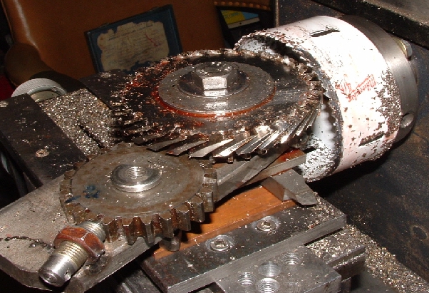

The depth is set by the bed, I chose 1/4" for my blade depth. This next picture is of the mirror blade's rough cut.
The indexer is made from the gears you find in a small lawn tractor transmission.The two blades are shown here together, the edges are very sharp and much care is used in handling them.

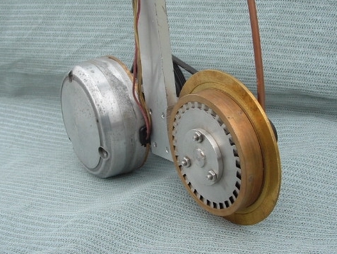

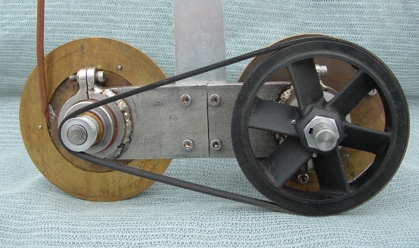

The next picture is the rear view of the finished unit connected to an old motorbike alternator. The reduction is aprox. 5:1 and the unit produces 100 watts.
The cover is removed to expose the turbine's front view.
The steam is injected through the 1/4" copper tube. The system is a closed loop, and the turbine operates at 12000 RPM. The efficiency is only 12%, but the unit cogenerates and the waste heat is used for heating. This is my first working unit. Joe

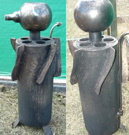

How did you make the blade design?
What about your boiler?
Did you make it yourself?

Hannu, The 4 1/2" circle cutter produces the cut and the height of the disk that I am cutting gives me the angle of attack. By experiment I found the angle that worked good for me. My boiler is a fire tube type and will hold 75 Psi through a 1/2" tube. This unit runs at 40 Psi and the temp is aprox 260 deg. F. I have designed it around this pressure. My efficiency suffers but it is a safer operating pressure. Joe

This is the guts to my SS steam boiler, the unit was tested to 300 psi. The max operating pressure is 125psi set by the safety relief valve.

Very ingenious way to machine the turbine blades. And 11% or so is not bad efficiency for a one bladed unit. Have you considered adding another set of input and exhaust ports at 90% to the others, to see if you can improve it any?

Infinty, I use a convergence nozzle and have tested a second nozzle at 90 deg. Steam expands as it leaves the tiny nozzle which is less than 1/16" in diameter. My BHP (Boiler Horse Power) is not sufficient to maintain two nozzles at the required pressure. It is like the gas engine in your car, you can run her down the road full out but you only use maybe 1/4 of it's power. Efficiency goes down, fuel consumption goes up. This is exactly the same reason I run my boiler at 1/4 it's maximum output. Tesla's bladeless design is what I think you are talking about. Heat expansion of the disks is the problem with this design. Modern materials have to some degree stopped the warping. I have tried Tesla's design with limited success. Joe.

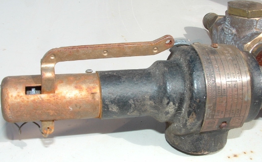

As to the 125PSI pressure relief valve, is it Home-Brew or scavanged from a typical air compressor rig?
If a regular air compressor relief valve could be reliabley used for steam, I'd be more apt to consider experimenting in that area, but my fear is that there may be heat related issues that would either degrade or jam the relief valve.

I anticipated this question so I have a picture of a steam pressure valve.
#1 RULE: All Boilers Must Have a Proper Certified Pressure Relief Valve.

by freshair on Wed Apr 26, 2006 at 03:41:34 PM MST
Very nice WXYZ,
 Really like that indexer. Did you key or dowel your blade to the indexer gear? Or just rely on the tension of the bolt?
Re: Steam Turbine 100 watts (1.00 / 1) (#25)
by WXYZCIENCE on Wed Apr 26, 2006 at 05:45:41 PM MST
Freshair, There are three 10-32 counter sunk machine screws attaching the blank to the large gear. Here is a backside view of the first picture. I use my outside jaws to grab the gear this way I get better precision. I use the three holes to bolt the two blades together and to the hub.
