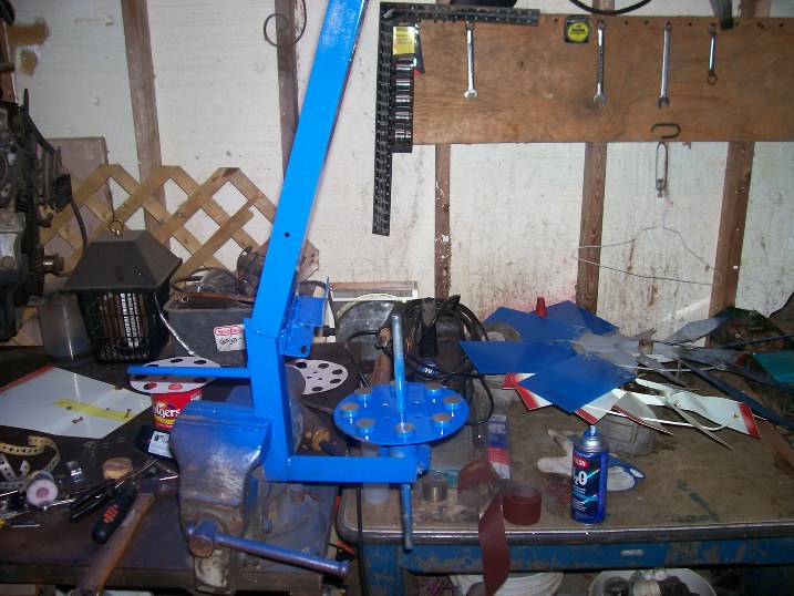

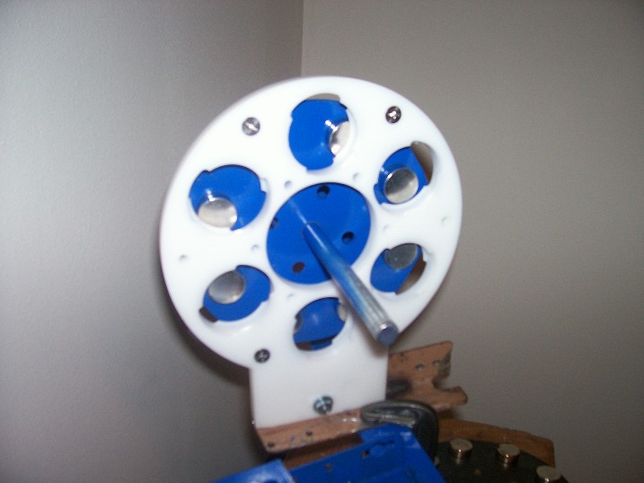

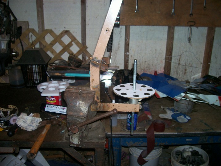

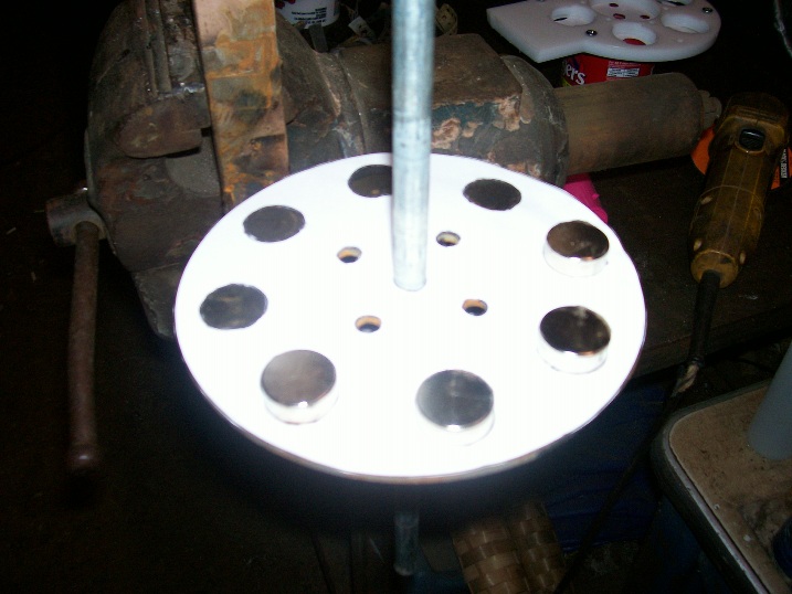

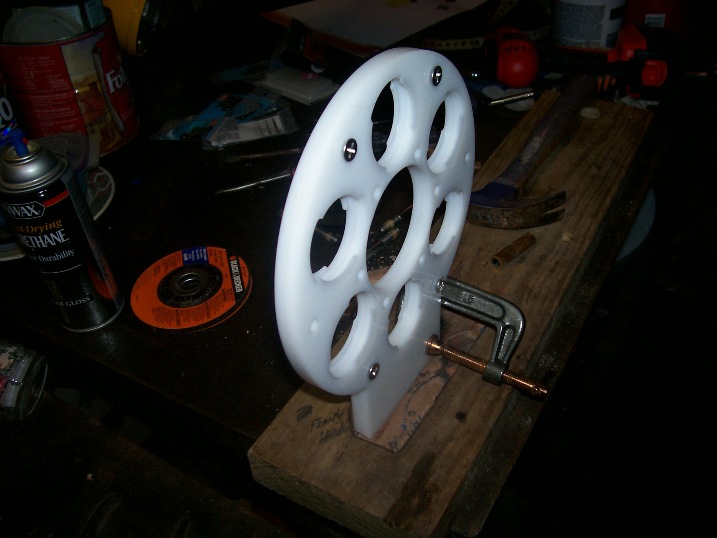

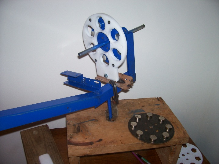

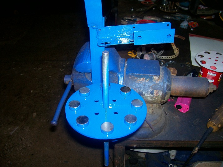

Here's what I worked on last night. I disassembled the proto, and printed out a stencil to use to re-position my magnets. My son helped by cutting out the stencil for me.
Afterwards, I noticed alot of surface rust already happening, so I thought I'd go ahead and slap some latex on now.....(couldn't hurt)....

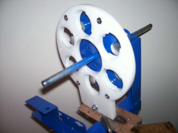

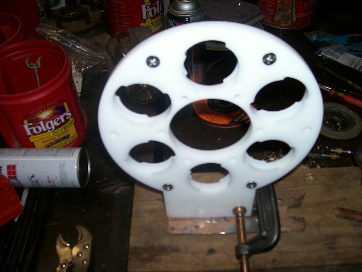

Here's the stator case, or coil case, or whatever you want to call it, milled out of neoprine. I'll be able to change out coils, test different sizes, try different wire configurations......the bolts are stainless, and I will have to figure out how to countersink the ones inside the rotor diameter.
And here's the point I got to last night.

Re: Yet another Coil question?? (3.00 / 0) (#12)
by Flux on Fri Apr 28, 2006 at 03:07:22 PM MST
#30 is a bit far off the mark. You will need about 24 in hand if you wind the 100 turn coils.
If you wind each coil with about 230 turns of perhaps 10 in hand you could connect each coil to its own bridge rectifier. ( search for jerry rig )
At least you can experiment with your stator support to try various coils.
