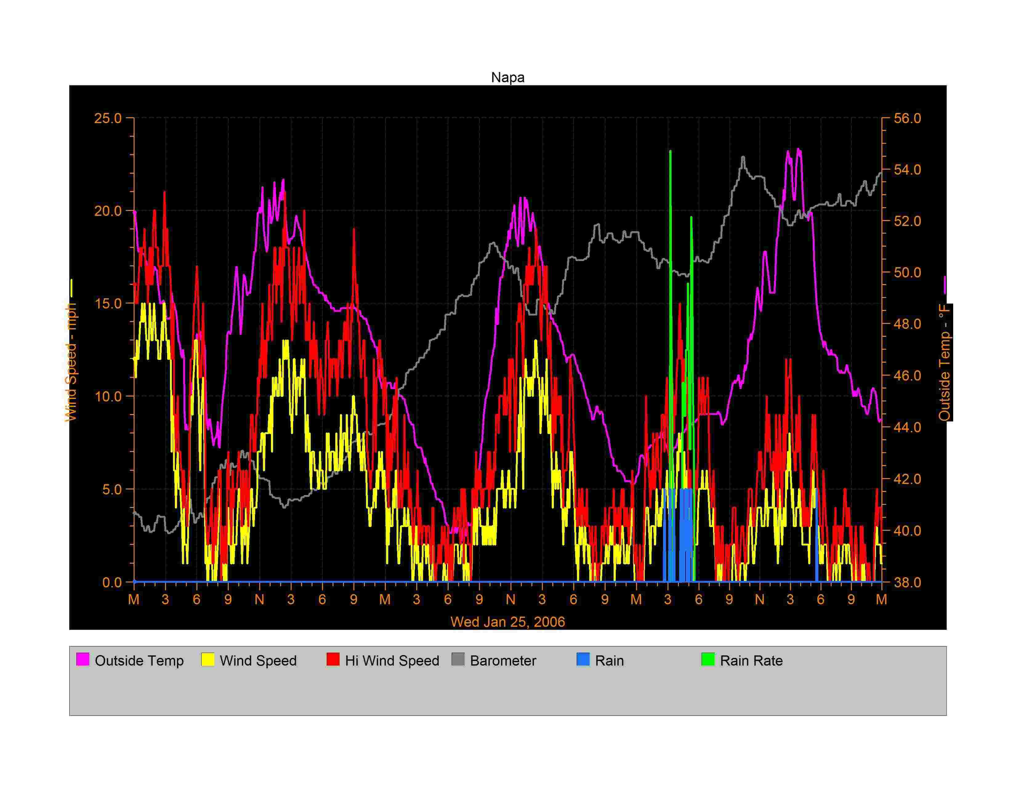

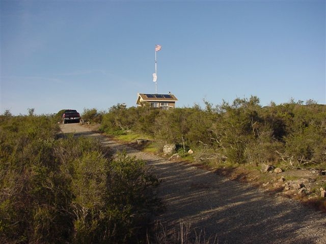

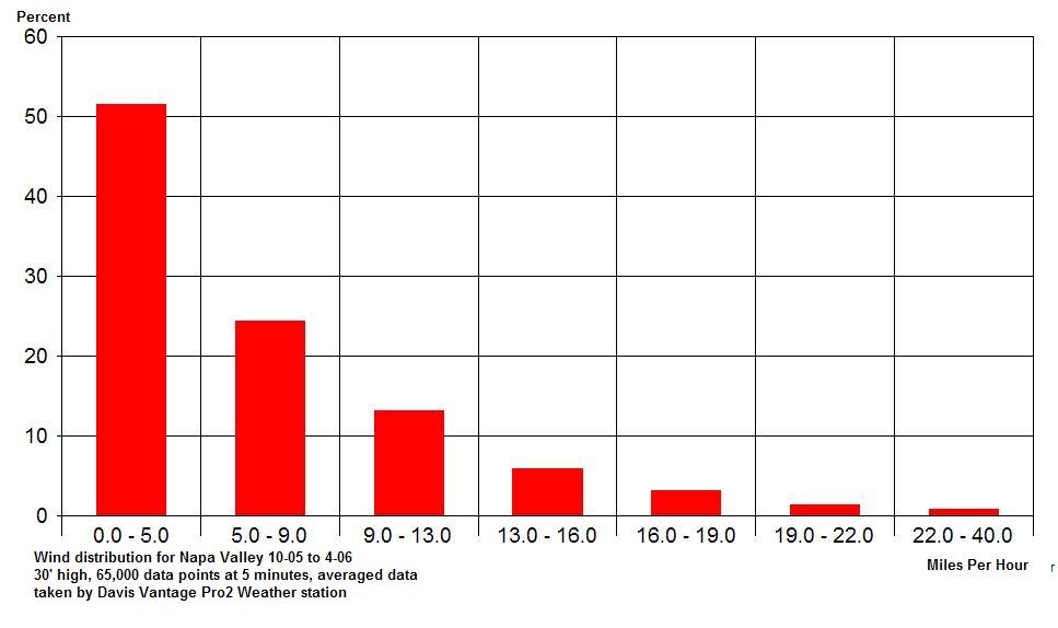

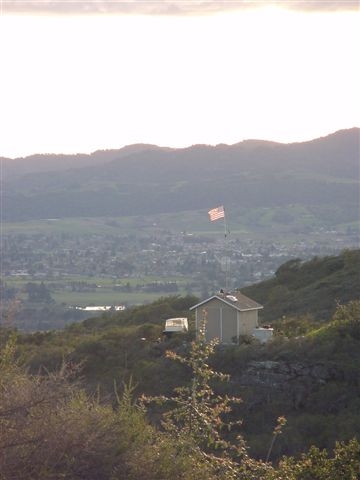

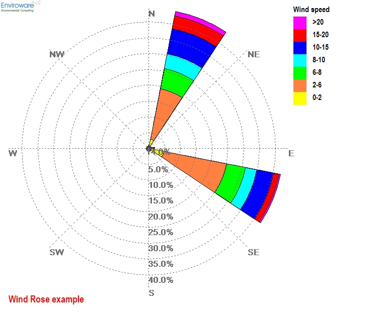

Request assistance - wind site data analysis
I am interested in comments on how much energy a well designed 10' HAWT could produce given my site conditions as shown.
Also what besides increasing height & swept area could I do to maximize output such as blade geometry or low mass for the gusty conditions (red plot trace)?
I do not anticipate running my residance entirely from wind but plan to augument with solar so the winter is when wind will be important.  It would be great if I did need the utility as the cost is likely very high for the several hundred foot run.
My average winter wind speed at 30' is 7.6 MPH from 22 degrees and 5.9 MPH from 112 degrees.  I have attached a site picture, wind rose and distribution.  The data was collected with a Davis VantagePro2 weather station at 5 minute averages updated every 2.5 seconds.

Seems a very poor wind site. At best you may manage around 600kWh/year for a 10 ft machine.
Increase in height will help a lot. I think the bit about low mass blades is a lot of nonsense, I would stick to conventional blades and not mess about with other constructions other than wood.
Most of your energy is in very low wind so this indicates an axial machine with best efficiency in low winds.

I gather from the last slide that the wind speed is measured over 5-minute intervals, but how about the red curve?  What is the measurement interval for that?  Is it something you could expect a purpose-built rotor to track?
Re: Wind Site Evaluation (3.00 / 0) (#8)
by aogden on Sat Apr 29, 2006 at 10:01:29 AM MST
Slingshot,
The red Wind Gust curve is the maximum speed measured at 2.5 second intervals over the logged interval of 5 minutes. It is usefull in displaying the magnitude of turbulence.  The 30' wind at my site appears really gusty but I have no real referance point to compare it to. I am curious if there is a HAWT that can be optimized for gusts?
Re: Wind Site Evaluation (3.00 / 0) (#18)
by Slingshot on Sun Apr 30, 2006 at 01:51:29 PM MST
I was thinking that "gust optimization" would basically be designing a low-mass rotor and blades.  If the mill is operating steady-state in a 10 MPH wind, and the wind steps to 15 MPH, the rotor will begin to speed up.  How much the rotor speeds up in a given number of seconds (or before the gust is finished) would depend on the mass (inertia).  I imagine that a very heavy rotor would respond sluggishly to gusts, and little increase in energy output would be realized.

Since your site has winds of 9 mph or over 20-25% of the time, you could power your site just by wind.  Besides the other comments on blade size or number of smaller turbines, one issue to consider is the size of the battery bank you'd need to cover the time between when the wind is sufficiently strong to be generating.  Adding some solar panels would lower the number of batteries you'd need and let you use a smaller wind turbine (which might make your neighbors less upset).  How many KwH do you need per day and how many consecutive no-wind days will you have to plan for?
Craig
