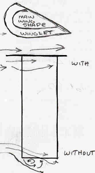

Adding nothing more than some oversized wing shapes on the top and bottom of the wings ( winglets ) increased performance as much as 12% in the smaller unit.
Air or water will run around the end of an airfoil/waterfoil, removing much of the lift from the outer part of it.  Adding winglets impedes this flow, paying back far more than they lose in added drag.
They're usually left off in keels, rudders, wings, props, etc. because it's easier to just make 'em larger and the winglets can add other pathologies.
(Sailboats designed to be navigable in shallow water (or trailerable without having a retractable keel), for instance, may have "wing keels" - shortened keels with a double winglet at the end to make them perform like a longer fin keel.  Downside is that when the boat heels the hull shadows more of the keel and you lose more of your resistance to side force.  So you can't sail as close to a strong wind as you could with a fin keel.)

Well, Ed, you're right. I should make the blades smaller so they are proportionally right for the diameter. But I don't what to buy any more aluminum and I hate the idea of taking my present wings apart. Maybe I'll just have to bite the bullet. Before I do, I think I'll increase the diameter back to the original and check performance of two blades and the improvements I've made. I've also been making small improvements here and there, making small gains each time. For instance, I took off the clunky 2x4 top cross piece and replaced it with a piece of 1/2 inch emt flattened on the ends and bolted through. I don't know if it was air flow or weight that I affected (probably both), but it helped. I will get it eventually.
Would you please describe your fascinating winglets a bit more? -tom

  Tom,  The winglets are nothing more than a top and bottom plate that are about 2-3 inches larger than the wing.   They simply keep the air from flowing off the wing and creating turbulance in those areas.  Just another way of controlling drag on the upwind swing although it may add extra cupping for the downwind side.
  Think of it as a thin plate the same shape as the wing only larger by a couple inches.
Have Fun! Windstuff Ed
Re: VAWT project (3.00 / 0) (#16)
by windstuffnow (elenz(at)windstuffnow(dot)com) on Fri Apr 28th, 2006 at 02:54:20 PM MST
  Here is a quickie graphic for the winglet.   It's basically a very low tech version of the real thing and could be made much better if one wanted to.   The low tech version works very well.
 The graphic shows the top with the winglet, the air flows around the wing without "slipping" off the edge.  The bottom with out the winglet, the air will slip off the wing creating vortices or eddy currents.   A simple addition that is cheap enough to make the gain worthwhile.
