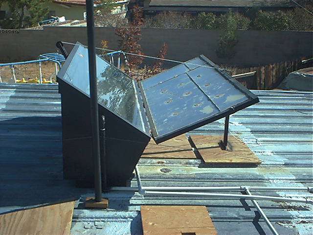

Herewith the latest show of my new solar hot water heater. Its designed life span is 50 years or more and it weighs 450lbs including water. All materials are non ferrous.
The water pipes are 42mm copper and I designed for eight, changed a measurement and managed to get nine pipes in the box. The pipes are floating and rest on various pieces of dowel - hence the freedon for movement. Total water capacity is 7.6 gallons or about 34.6 litres.
The insulation is 25mm Kooltherm (polyisocyanurate)sheet which is doing well in the heat.
Temperatures recorded on dry pipes during the installation were 89.9 Celsius, and in the last day or two with pressurised wet pipes 79 Celsius has been observed. I expect higher temperatures.
The unit is fitted with 4 internal sensors which are hooked up through an RS232 interface to my computer. They are:- Inlet pipe, Centre pipe, Outlet pipe, Internal air temperature, and external ambient temperature. The data is dropped into a running Excel file and I am very impressed.
The data has also shown me some short comings in the design especially what happens when cold water is brought into an already hot solar box. As result of this I intend to add more insulation and make a dedicated insulated box for each pipe. I will upload this modification and the results at a later date.
The photographs should be self explanatory, but if you have questions please ask.

Re: Mother of all solar hot water heaters Part 2 (3.00 / 0) (#2)
by David HK on Mon Apr 03, 2006 at 06:17:18 PM MST
1.    What is the purpose of all the sensors?
I have always been curious to know what sort of temperatures could be found in a solar hot water system. This offers me options to investigate heat effects, changes in water pipe temperature, and the opportunity to think about this and contemplate improvements to the design. I can now see two areas for improvement. Thermally isolating each pipe within the solar box to prevent rapid air temperature change (downwards) as cold water runs into the box. Once I have incorporated this design improvement I shall be able to observe the changes.  The aim is also to make good use of technology - this is how designs can be improved and made more efficient.
2.    It looks like 3/4" copper with 3/8" inlet and outlet. Purpose?
The main pipes are 42mm diameter copper with taper reducers down to 15mm copper at the input and outlet. I spent several days working out how much water is held in my wash basins, how much water is used for a shower, how frequently my family take showers, use the wash hand basins, and the sink for washing the dishes. From this data I worked out what quantity of `very hot' solar water would need to be blended with cold to serve the various household uses. From this I was able to determine that what I have built will serve my needs. This keeps costs down and also weight on my car port roof. So far so  good.
3.    Is the cover glass?
Yes the cover comprises double glazed panels with one side of the glass being tempered.
4.    What is the overall size?
Overall size on extremities is 8 feet long by 49 inches wide. (You can metricate if you wish).
5.    What do you use to pressurize it or create the flow?
The system is connected directly to the mains water supply coming from the street into my home. Its usually around 4 - 6 Bar.
6.    What about storage?
Not sure what you mean here. The system in the box contains 34.62 litres or 7.61 UK gallons. Add on the delivery pipe for a few more litres.
7.    Pipes are painted flat black. What kind of paint and how do you prepare the copper for painting?
The paint is bog standard ordinary paint from the local hardware shop. I figured out that many households around me are painted black and if they can survive direct sunlight and heat in the Hong Kong environment them so can my pipes. I did not make any special preparations prior to painting - just put it straight on. So far so good.
8.    Does it have a pressure relief?
Yes it does. If you look at the photograph with the pressure gauge it's the brass object forming part of that unit.
9.    What about freezing?

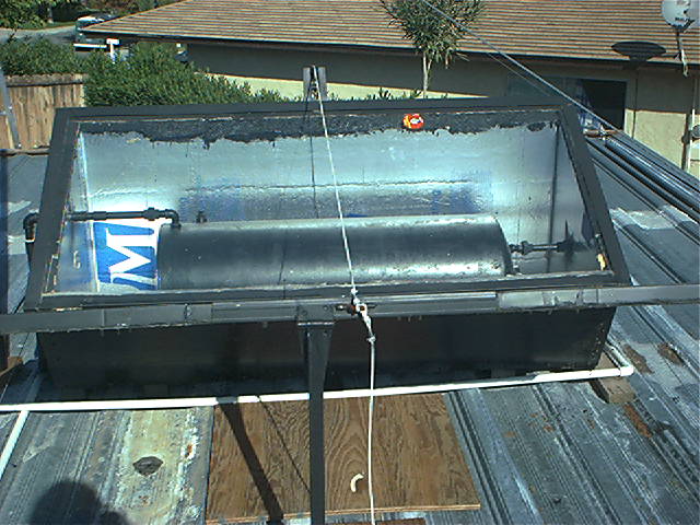

Maybe Im missing something, but it looks like the only surface area for collection is the black painted pipe.  The shiny metal (?) behind it helps reflect sunlight back onto the pipe but would be much better served if the copper were thermally connected to the rear metal and the whole works painted black.  As it is you have 20 or 30 (not sure of the box dimensions) square feet of inclosed collector area and only maybe 1 or 2 square feet of absorber plate (the copper pipe).  I doubt you will get much hot water out of it.  But then again maybe Im missing something.

Your quite right with your observation. The omission of black paint (or whatever) is deliberate. I discussed this on this board a month or so ago and decided I would build with the pipes black and leave the background until later.
The reason is that Hong Kong is hellish hot in the summer with 33 Celsius all day and night. I have yet to see what 'real' temperatures will come in the summer and bear in mind we are only in April.
I suspect that the temperatures in the box will be in the 90's come mid summer and expect the pressure relief valve will blow off regularly.
Its fairly easy to change things as I go along. I still have insulation to add to the delivery pipes, but all these things take time.

by Ungrounded Lightning Rod on Mon Apr 03, 2006 at 09:29:40 PM MST
Painting the innards of the box black will heat the air but then the heat has to transfer via air to the pipe.  Much thermal resistance, so slow power flow.  Thus much overheating of box air and limited output.
Painting the back of the box black and connecting the pipes to it solves the conductivity problem (if the box back is conductive) but creates others:  Differential expansion, increased heat loss due to the collector touching the box rear insulation rather than having an air gap, etc.
What I'd do is get some copper flashing - thin copper sheet, thicker than foil, thinner than heavy copper plates - in strips just a tad narrower than the spacing of the pipes.  Then I'd clean the paint off the (back of the) copper pipe, solder the strips to each pipe run (making a "wing" behind each pipe with a small gap between wings), cut gaps in the wings where the pipe is supported (with clearance around the supports to allow for pipe expansion without the wings hitting the supports) and repaint the pipe/copper wing structures black on both sides.
The copper wings will collect more heat and (if they're not too thin) conduct it efficiently to the pipe.  But (if they're not too thick) they won't appreciably increase the weight of the collector.  With both sides painted black most of the light that passes through the gaps between the wings or around the supports will bounce off the shiny backing and (unless you're pointed right at the sun) be absorbed by the backside of the pipe/wing structure.
With the wings also made of copper the wings and pipe will expand/contract together.  (Solder is soft enough and close enough to the same expansion coeficient that it won't bend the pipes or let them separate from the wings with thermal cycling.)
The whole pipe/wing structure would only contact the supports and the box at the pipe entrance, so contact conductivity will be trivial.
