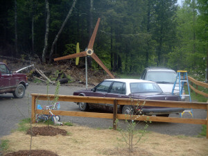

Got her all mounted and ready for morning
Well here she is all wired up mounted and awaiting tommorow mornings road test. we had a couple gust in the driveway today and we saw 4-5 amps at 24 volts so looks pretty promising now i just have to build a 90 ft tilt up tower in the cleared spot directly behind the mill

looks really great hc,
there is no chance it could spin around and hit the front of the car is there?
hope not
much luck !

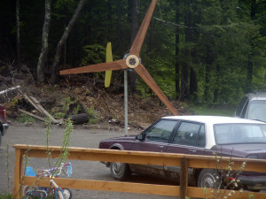

no we left clearence it is actually spun around into the wind in photo and the blades are over the hood

oh ,be sure to bring a copilot so you can concentrate on driving , and not looking at dials and meters.
what gauges are you going to be using ?

looks scarey to me. i'm putting up my 10' 24v tomorrow also,not as brave as you. . danB told me i should carve my own blades so i did. he was right , its not hard to do. did take me about two weeks, working a few hrs a day.  thanks danB. any way, looks scary to me. wish you luck......

just curious how you mounted the mast pipe to the front of car.  any chance of seeing a picture how you did it?

That looks like a beautiful mill, I'd say if you saw 100+ watts out of
 it at ground level in low winds you might just want to consider it
 tested, and get started on the tower.  that's a really nice corner
 of the world you have there.

Too cool, the troopers are gonna love ya, kidding of course, drive careful. Looks awsome and I can't wait to hear your results.

 mabe just pack a lunch and see how far you could get before ou see the first cop.
  "Sorry sir the the   the alternator's failed and iiI just need to get to the parts store that's it just the parts store "
