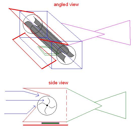

I dont have an actual picture right now, but I did do a really quick sketch on MS paint.
Basically, what happened is I took the idea of a vertical turbine and then thought a way to eliminate the drag of the return blades against the wind.  This is done with an angled piece that goes in towards the center of the unit.  Basically, instead of "x" amount of air pushing past it and the blades fight against the wind to keep spinning, you get "2x" amount of air pushing against the blades and no fight against the wind.
Then I took the whole unit, and turned it horizontally, so that I could add a pivot point easily (a lazy susan thing for now)  And then the yaw to stabilize it into the wind.  It seemed to work quite well, hitting 100-200 rpm today in 20 mph winds.  The blades are just out of some thick aluminum flashing, which is mounted into round wood pieces on each side.
So what do you guys think?  What are the pros and cons of this?

Yes, that picture says it all...
Donkeys, desert and ancient technology. Ancient technology, that regularly gets reinvented :)
Peter.
Re: General Wind questions (3.00 / 0) (#6)
by dinges on Thu May 04, 2006 at 01:48:48 AM MST
Ehm, to clarify a bit more;
These are all drag-based systems. Nowadays, thanks to modern wing-profiles, we have lift-based machines. You get more energy per square meter out of them.
But your idea should work. And with the same effort and a better design (see this board) you could get much more energy.
You decide.

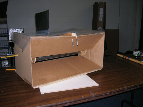

Derek I think I see a couple cons here.
  1. It would need line up with the wind(hawts would be better in that case)
  2. In the turbulant area you descibing it would really struggle I think.
  3. Lots of sheet metal to get reasonable power.
  4. You would still have drag on the return.
  My opinions and im trying to picture it has a larger unit.Vibration might be less.
 I wonder if the unit itself might try to spin in cicles.I guese we dont know till we try.Good Luck.

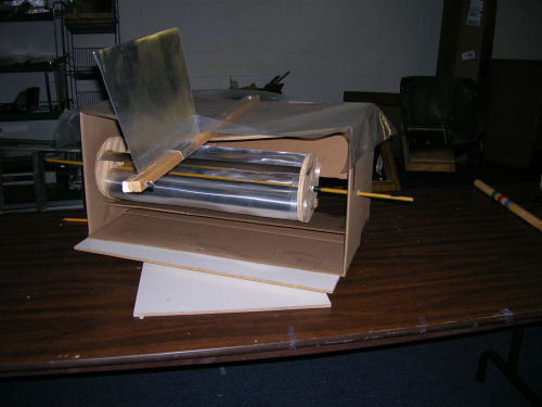

by Derek on Thu May 04, 2006 at 07:11:22 PM MST
Vawtman, your name implies you might know what you are talking about!  )  It does in fact line up with the wind since it has a yaw on the back end.  The base of it is mounted on a lazy susan thing right now, which works quite well.
The aluminum that I have in it right now is probably about 50 cents worth honestly, so not much cost there at all.  Now you guys will laugh when you see the pics.  But I didnt spend anything but time on it, just to see if the concept actually works, which it seems to.  Its a cardboard box, with an electric fence post as the center rod, two wooden end caps, and aluminum fixed into it.  It has a tad bit of wobble on the center post, but thats because its just plain wood to metal, plus the fact I didnt have a bit handy that was big enough to actually allow the wood to spin freely around the metal rod.  So it was a custom crappy job....  But again, just a concept idea with scrap parts to see if works.
Obviously it will still have drag on the return, BUT, its drag is not against the oncoming wind though, which is my claim to fame on this project I think.  And if I sound dumb, thats because I know squat about wind power, only starting out!
In the background, you can see some of my solar ovens that I've constructed too, which hit 370-400 degrees no problem.  But the wind thing has caught my attention for those cloudy days to give me something to do!
But basically, the idea is that wind from the bottom intake will push one blade back, and as it passes the area that the wind reaches it, the next one comes into play then.  Here are the pics:

Wow, I messed something up there, try again:

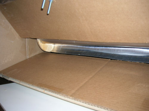

And here is the pic that didnt load:

by finnsawyer on Fri May 05, 2006 at 10:00:32 AM MST
The blades moving along the bottom half will still have to push dead air, meaning they will waste power.  If you turn the unit upside down, you can then place holes along the top frame just back of the sharp angle.  This will cause a difference of air pressure between the still high pressure air inside and the moving low pressure air outside causing air to flow out and reducing the pressure the vanes have to work against.  If instead of the sharp angle at the top you put in a nice circular shape you can speed up the air just back of it more and hence lower the pressure there even more.  Or you could also keep the sharp point and instead put something like a tear drop shape some distance above the sharp point.  I'd try a radius two to four times the gap.  This will also speed up the air and lower the pressure over the holes.  Basically it would put more area of the air stream to work for you.

finsawyer, I love the idea about the holes cut for reducing air pressure!  I never thought about that actually, but yes, that would probably help a bit too.
The actual turbine itself doesnt catch wind at 360 degrees, but it pivots just like a windmill anyways, so its always pointed into the wind.  So I think it will still have that advantage.  Plus, do you think if you have say 4 square feet of area of wind being forced through a 2 square foot area via a funnel type system like this that it will increase the actual pressure and speed of the turbine?
What if you had another box which collected air & fed it past these holes; thinking venturi effect here. Create a semi-vacuum to suck the returning blades.
Hope that makes sense.
